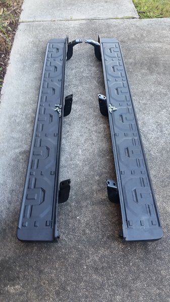

I can only speculate, but I'm sure they are. For a basic running board, these are great https://www.amazon.com/Genuine-Toyota-Accessories-PT938-89100-Running/dp/B0097M85AE
That style you posted with the "vents" at the transition from horizontal to vertical is the old style offered up to 13' I believe, then it changed to a different style like currently coming on Trail/OR and Pro..
Yep, you can still get them aftermarket. And the mounting is the same. Have them on my '16. Always liked the look better. And last I checked you can't get the current trail running boards aftermarket.
