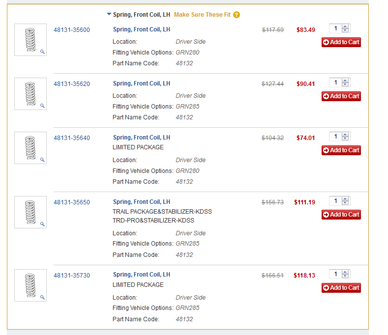

Yes. With a few small additions. KDSS will have more travel than non KDSS in stock form. About an inch at each end. KDSS equipped models have unique shocks and springs that are corner specific. The front left coilover of a KDSS is not the same as the front left coilover of an Trail/TRD/sr5 for example.
Are you sure about this (i.e. the 'unique' shocks and springs in KDSS vehicles)?
I researched all this before I decided to build my '16 TEP, and could not find any differences (nor could the parts dept. at my local dealer). After the shocks on all 4 corners were removed, I verified that the springs were mounted the same (as opposed to the TDRP's asymmetrical front perch settings), and both sets of front/rears had identical part numbers (again, compared to the TDRP's different front shock part numbers). As an aside, that asymmetrical perch setting on the TRDP's front suspension actually exacerbated the lean in my KDSS vehicle (and I thus switched the shocks left-to-right, which mostly corrected the 'KDSS lean').
It appears that they are now the same number. They previously were using different part numbers for Trail and Trail with KDSS as compared to SR5 4WD. It's odd that they retain the separate line sale position for KDSS, but now have the same part number.
Prior Part for the shock body # was 48510-35440 (kdss) compared to 48510-35430 for non KDSS 4wd for example - same on both sides, but different for KDSS. Similarly the LF spring should be 48131-35620 for non KDSS and 48131-35650 for KDSS equipped. The front RH springs are the same. Oddly enough looking at the part numbers the NON KDSS used different springs side to side while the KDSS used the same spring on both sides in the front. - ALso when you're looking at the part numbers GRN280 = 2wd and GRN285 = 4wd

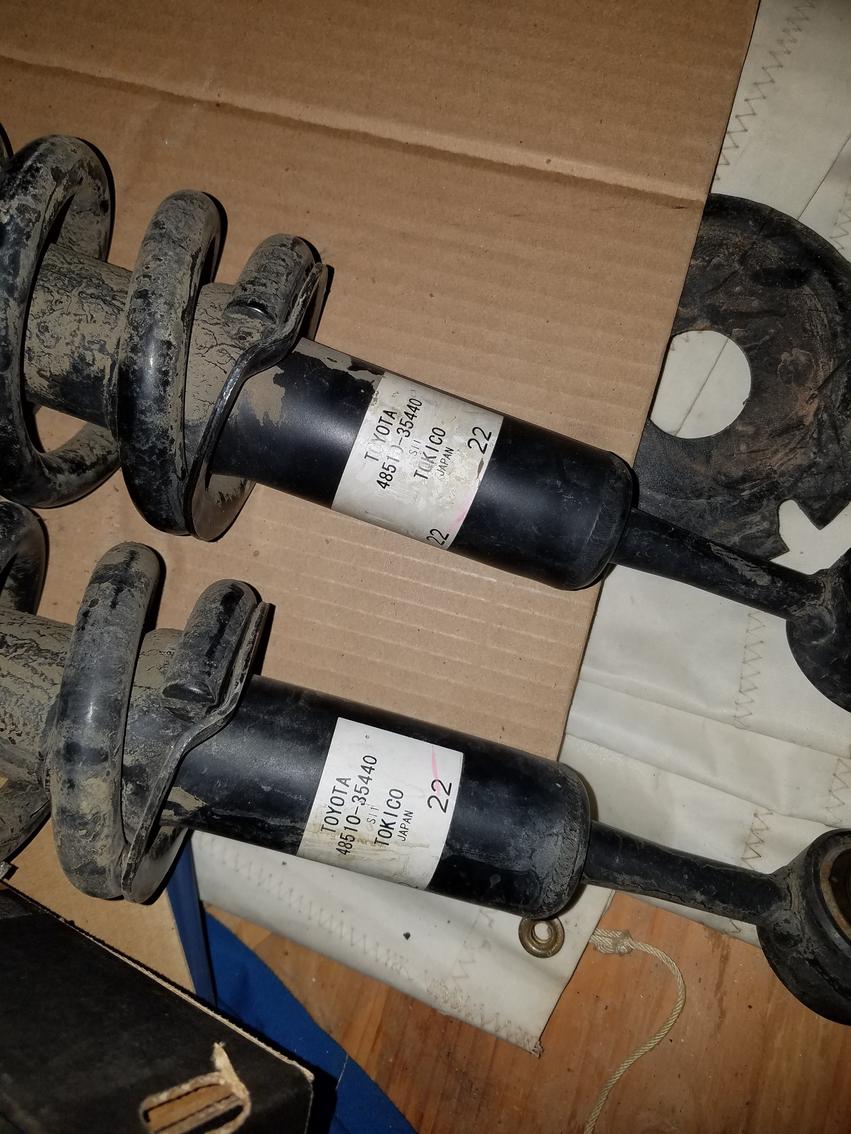

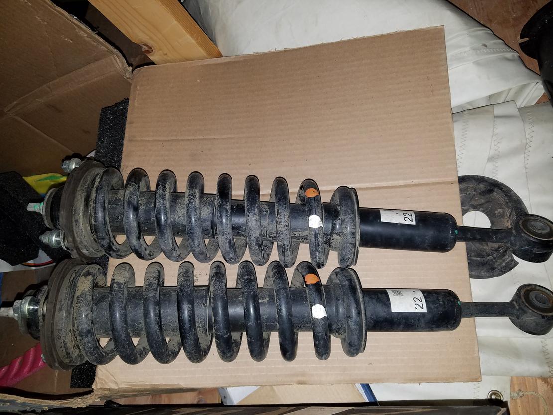

I'll take a look at mine if I remember tonight. They're basically brand new in a box in my garage. I'll see if there's any visual differences from a 2015 TEP. I don't think I ever marked them right or left when I took em off though.

Weird. Maybe they decided they should fix the 'gas/driver lean' in the SR5, just like in the TRD Pro? If so, similarly odd that they didn't just use those same shocks switched left-to-right to fix the 'KDSS lean' on Trails.
So I pulled my OEM shocks out. Same springs side to side by paint markings. And shocks were also same side to side. That would not match up to the current parts diagram used by most dealers. These were from a 2015 TEP that was manufactured in October or November of 2014.
