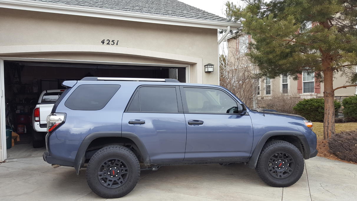

My vote is Bilstein 5100’s set on the first notch. (Only the front shocks are adjustable.) My 4R is a 2013 Trail Ed. with KDSS. Shock install provided about a 1 inch raise to the front; i.e., reducing the factory rake from 2” to 1”. Rides great, good luck:)

I think you went the right route. She'll be more than happy. If you want the 3/4" rake, (it was mentioned here) try the Wheeler's T13 Rear Coil Spring Pair. They're made by Eibach. It will give you that 1.5" raise in the back w/o it being too hiked up. A really smooth spring set up and leagues ahead of the stock set. Very affordable too. Here's a view of my rake:

what suspension and wheel tire are you running? Looks awesome man.
jagsr71,
I read your build thread. You certainly did it right! That is a great looking ORP.
