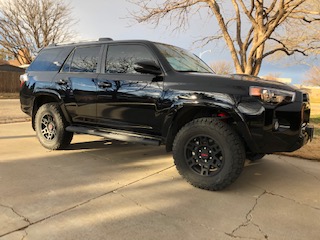

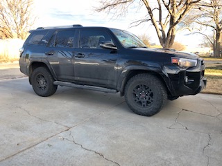

Update: Installed the front springs today. Below are crappy before and after pics. Took us about 3 hours but could probably do it in 2 or less next time.
Measurements are from center (eyeballing it) of wheel to bottom of fender.
Before / After
LF- 19 3/4" / 21 1/2"
LR- 22" / 22"
RF- 20"/ 21 1/2"
RR- 22" / 22"
I wound up with about a 1/2" of rake and i'm totally satisfied with that!
I had an alignment done immediately afterward. Neither side was too far out but the shop only did enough to bring each side back into acceptable tolerances. I asked if they could have done better and they said there is no benefit to be had as long as it falls within spec. I didn't feel like arguing so I just paid and drove home.
My wife loves the leveled look and the red springs! She will drive it tomorrow and will let me know if it handles any different (good or bad) than before.
Thanks for all the input and suggestions!

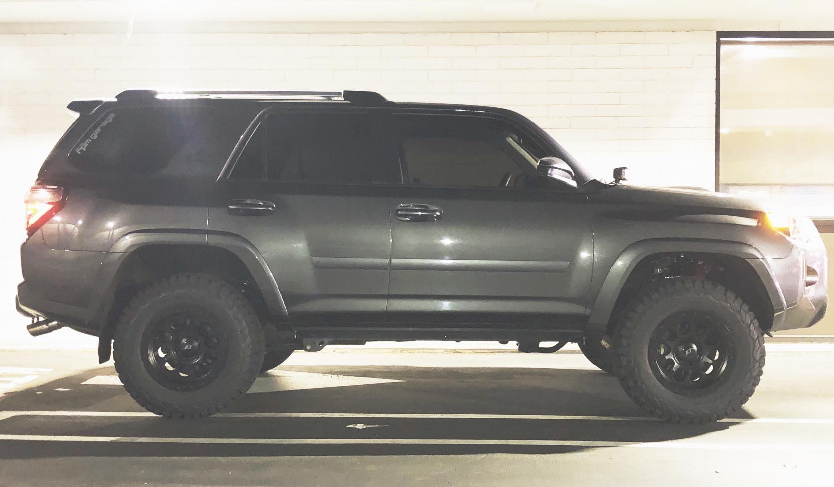

5100s all around, Wheelers T1/13 springs with 1/4” spacer driver front and JBA UCAs.
