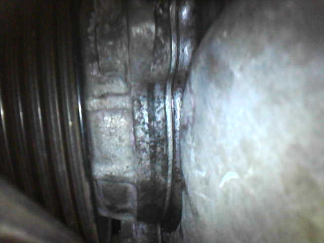

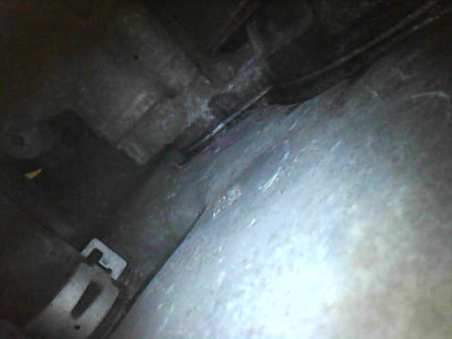

Noticed a while back I had a coolant leak. Noticed it first from coolant level. Didn’t lose a lot but was at low. Looked around and saw it below the pump and above. Cleaned it up and didn’t have issues for over a month.
Looked at it again this weekend and coolant level didn’t really change (got a lot warmer so probably offset the minor leak). Found a wet spot above the water pump. It appears to be leaking through the gasket on the upper left hand side. I got to one bolt and was a bit loose (couldn’t get a torque wrench) but the main one around the leak is behind the fan pulley so I can’t get to it.
Has anyone had this issue. Proper fix would be to tear everything out and replace gasket but at almost 100K I’d be paying only $80 to buy and replace the pump. Doesn’t seem worth the effort for a minor, intermittent leak. Has anyone had this issue? If so think Permatex 1 minute gasket around the gasket or sealant additive would work?

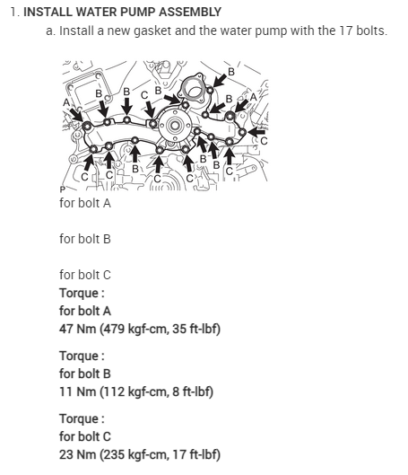

I haven’t been able to find any torque specs or videos for the 5th gen. Any know what bolt torque is for the 10 and believe 12 mm bolts are?

Mine appears to leaking in two spots. One on top left on the engine side and top right on the water inlet housing side. Outside the water pump gasket, I know there’s a gasket between the water pump and inlet housing and another between inlet house and coolant hard pipe above the pump. The top right one could be the water pump to inlet housing gasket but the other appears to be the water pump gasket for sure. The hard pump prong isn’t leaking.

I can clearly see is weeping out on 11 and 1 o’clock position of the water pump between the inlet water housing seal and pipe oring.

On mine you can see where the gasket failed on the engine side of the top half on the inlet water housing (water pump gasket not oring)
