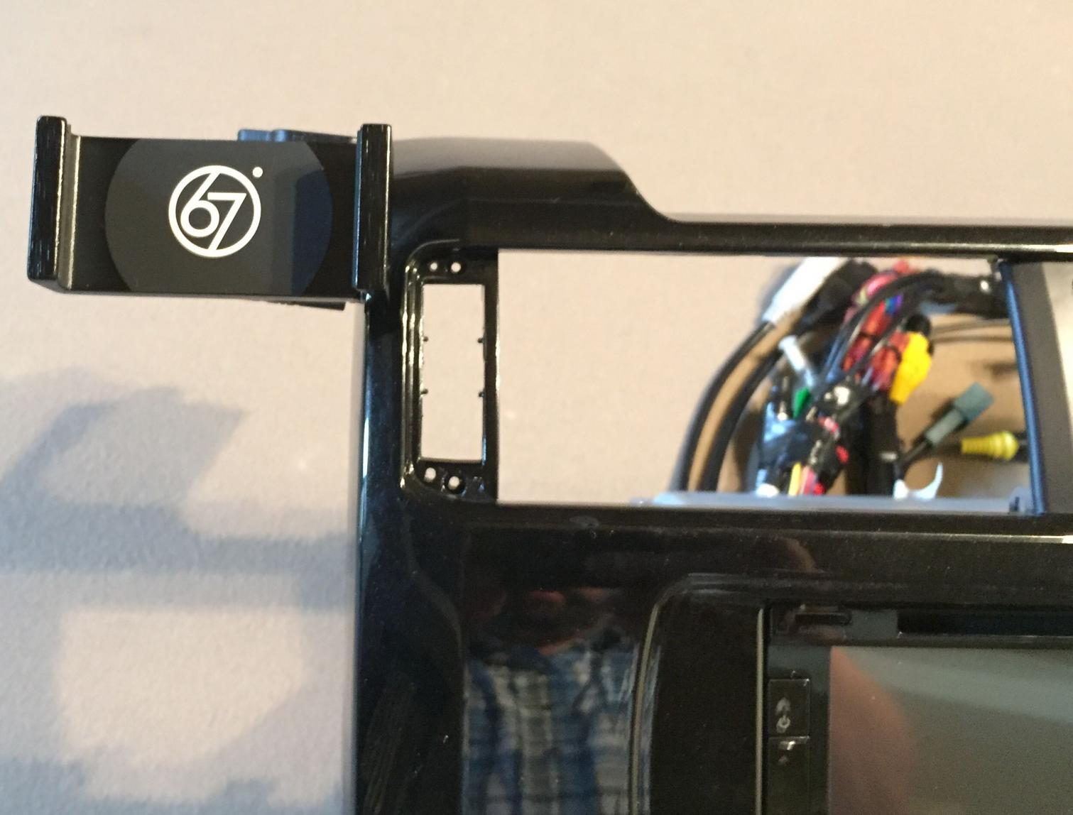

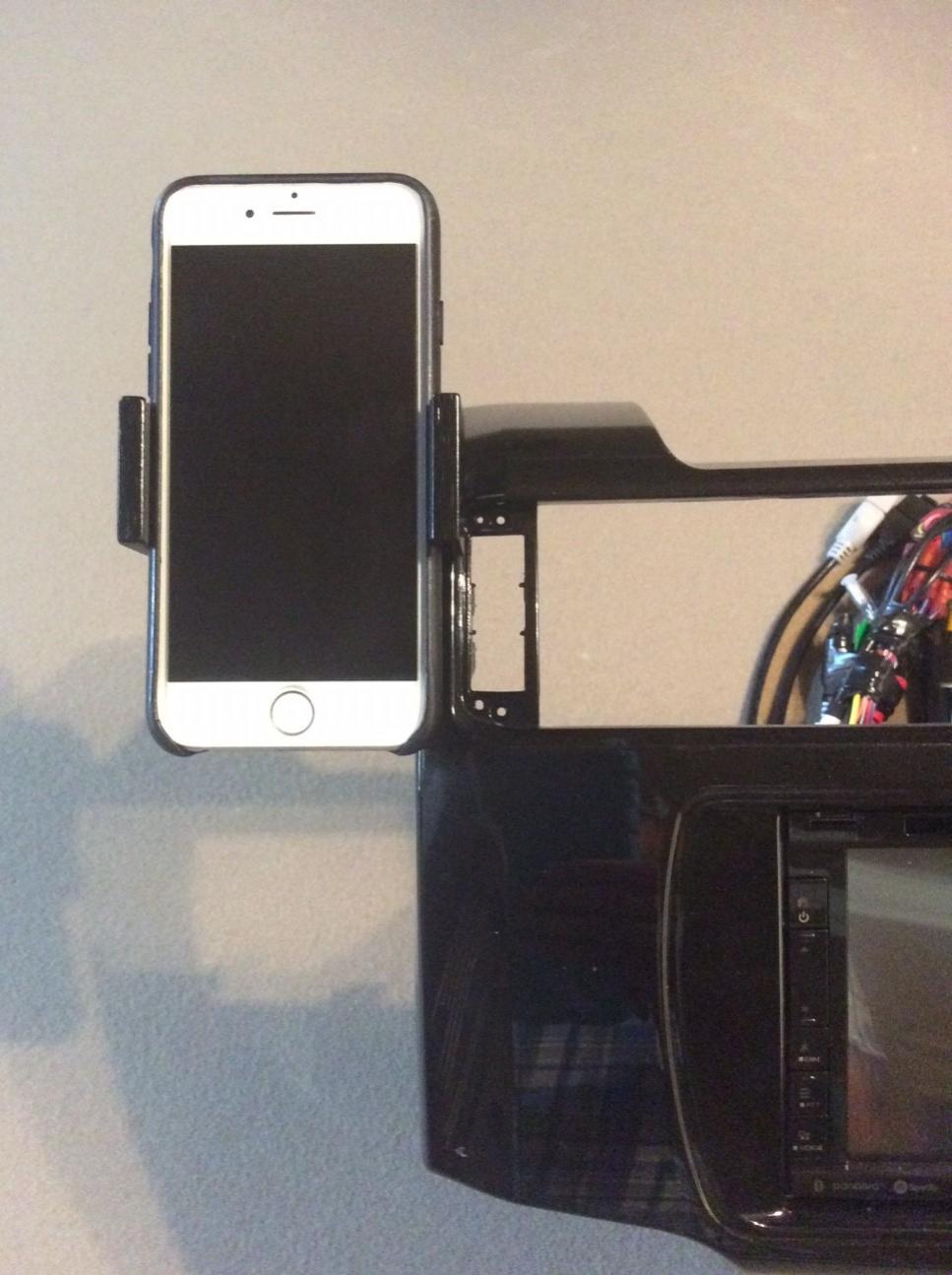

I picked up the parts and mounted it to my new stereo surround. VERY pleased! I initially ordered the 67 Design phone holder, arms, etc and was not happy with the mounting option I had planned. But super bummed because the quality and designs of their product was so good.
I bought the Scoshe mount and really loved the location, but was just okay with the function. I found myself fussing with it a lot, then heat impact its holding. But for the ease of mounting, price, and function it is hard to beat. But it lead me back to figuring out how to mount the 67 phone mount somehow. This is my solution.

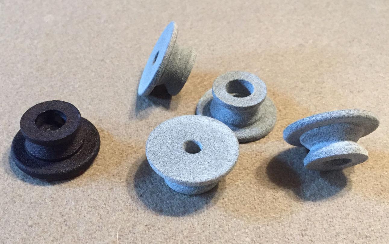

I designed a button to eliminate the arm from 67 all together. This allows the same location as the Schoshe.
-Heads up (safer, easier to use phone, I use a phone app for my radar so it is great for that, etc.
Right now I 3D printed them, and had to buy 5. The other 4 are spoken for. I will be posting a new thread on this once I install my head unit. Then if there is interest for 35 units I have a shop lined up to CNC lathe them, but they will be a little more money since I have to pay for programming at first.

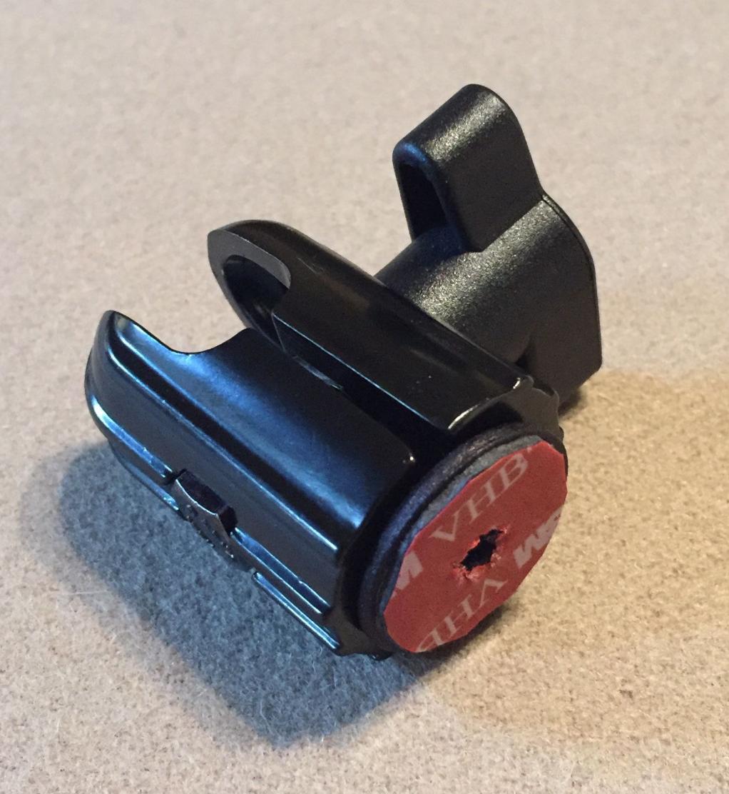

1. Printed parts
2. Hit it with a black Sharpie a couple times (3D printed parts typically soak up dyes and ink really well) I would not paint these for tolerances issues, wear, etc.
3. Applied a 3M double sided foam tape doughnut.
4. Stuck it my preferred location

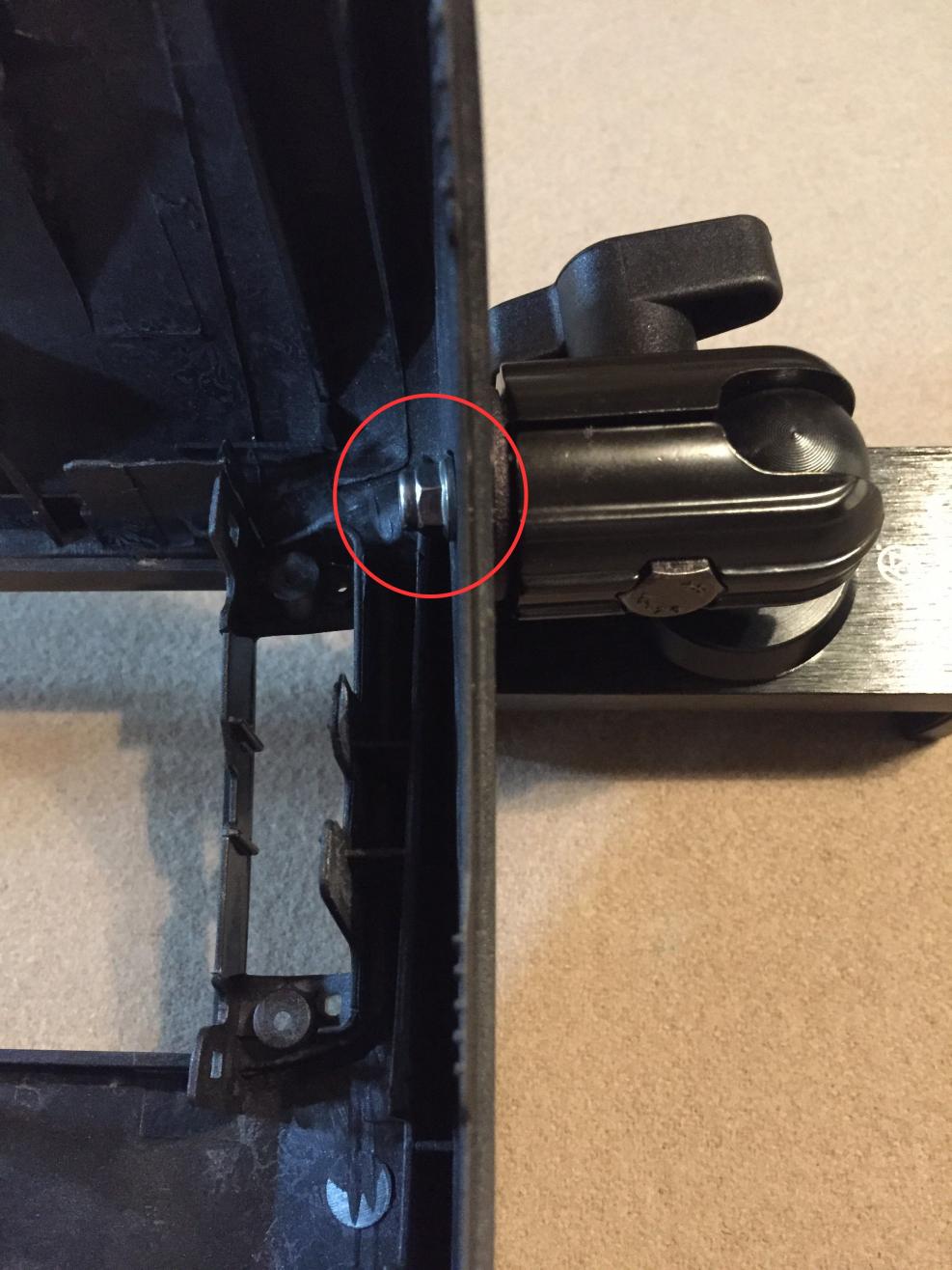

5. Then drill the hole
6. Attached with SS hardware
I think I won't have any internal clearance issues, we will see. It is pretty low profile.
Here are the first photos.

Installed

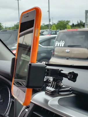

Here is my set up. It's a Ram mount with 5" Tough-Track. The other ball is for future devices or a GoPro (but I havent bought anything yet). I had the Scoshe magnet mount also (see side), but didnt really like it; the phone would fall off often when I went off road. Now I just use the magnet to attach the Apple Lightning cable head when I exit the vehicle.
RAM(R) Tough-Track[emoji769] - Top-Loading Composite 5" Track
Can you please repost the picture? Did you tape the track in the tray in front of the clock then use the ram ball to hold the arm and phone holder? How is it holding up?
