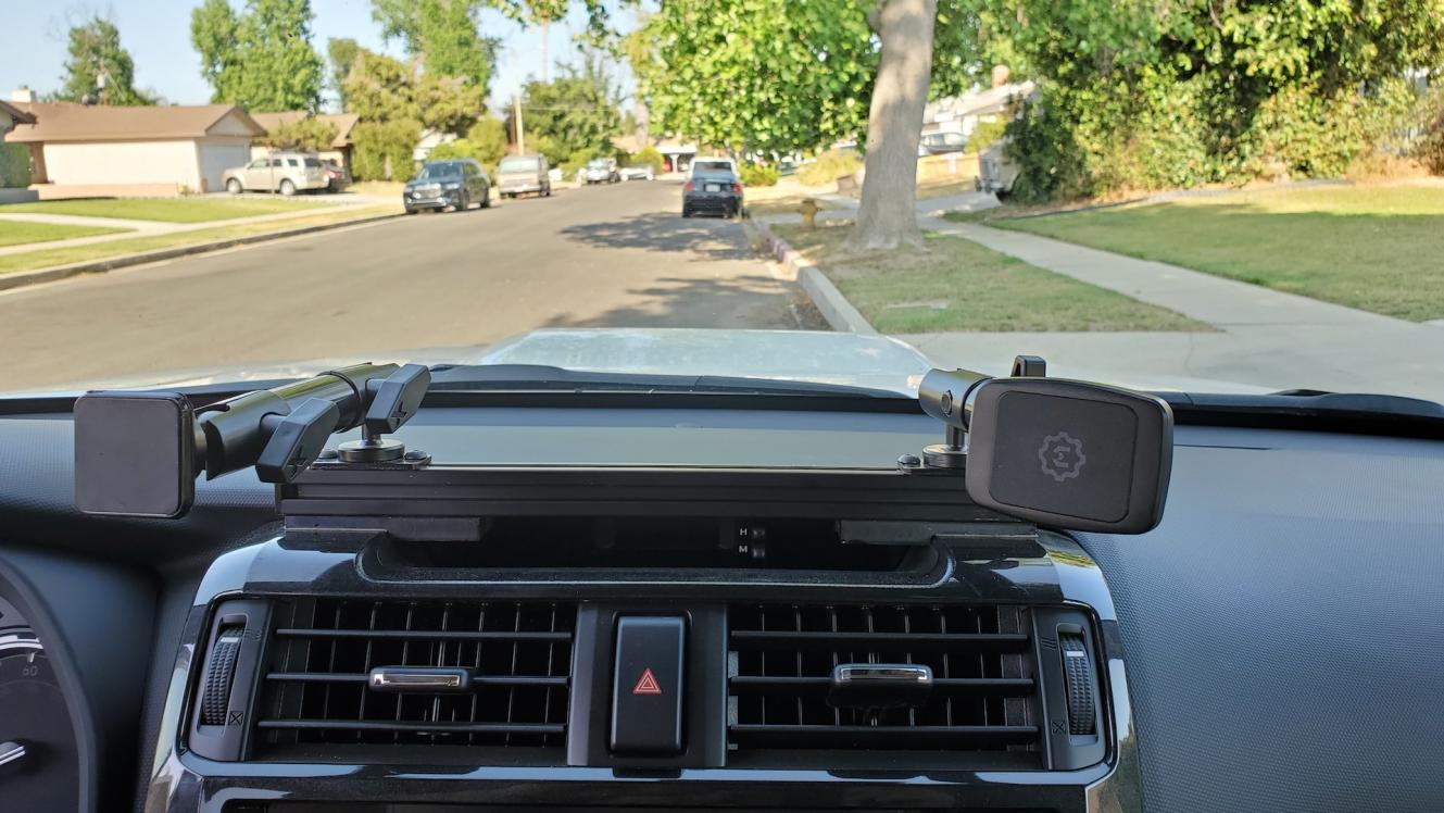

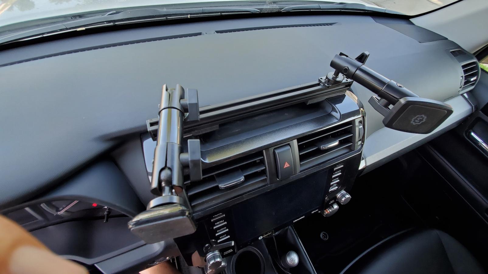

I designed my own.
It is based off a an 2020 aluminum extrusion and modified bracketron mounts. The original bracketron came with a regular squeeze on both side type, but i swapped the heads for magnetic type.
Why I chose to go with my own rail system?
  • No drilling/permanent modification required
  • Placement adjustable
  • Anything can easily mounted
  • Using natural dashboard edges and cavities to get rigidity and strength.
  • Held up to the Mojave 110 degree heat (Mojave trail run for 140 miles)
  • Components from aluminum, steel and UV and heat resistant plastic
  • Best part: drop of alcohol and can easily be removed with no traces or markings left.
I mount my phone and my handheld Yaesu on it, but you can pretty much attach anything you want.

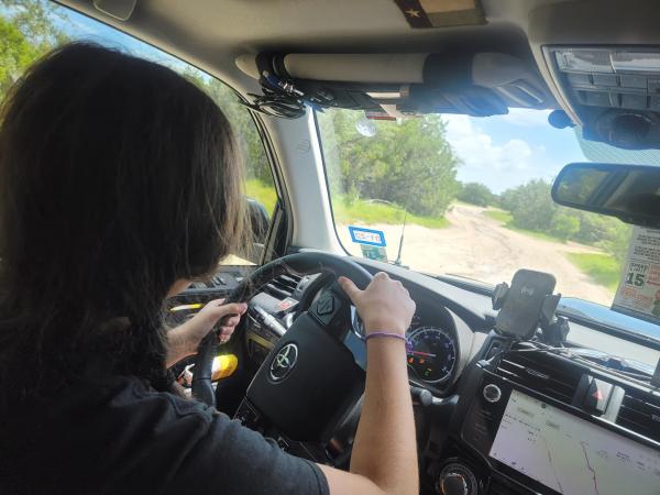

Since i have always integrated my smartphone into my vehicles for music, navigation and communication with my countermeasures like a radar detector and laser shifters i needed the ideal spot to see it at all times.
So i went with the iOttie smartphone wireless charger with adjustable arm. I found that having the phone on the same plain as my dash cluster and windshield makes it easy to see out of the corner of my eye and easy to reach.
I have been using this method for about 8 years now.
