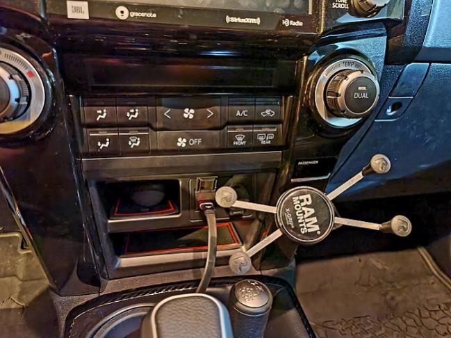

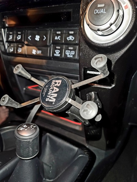

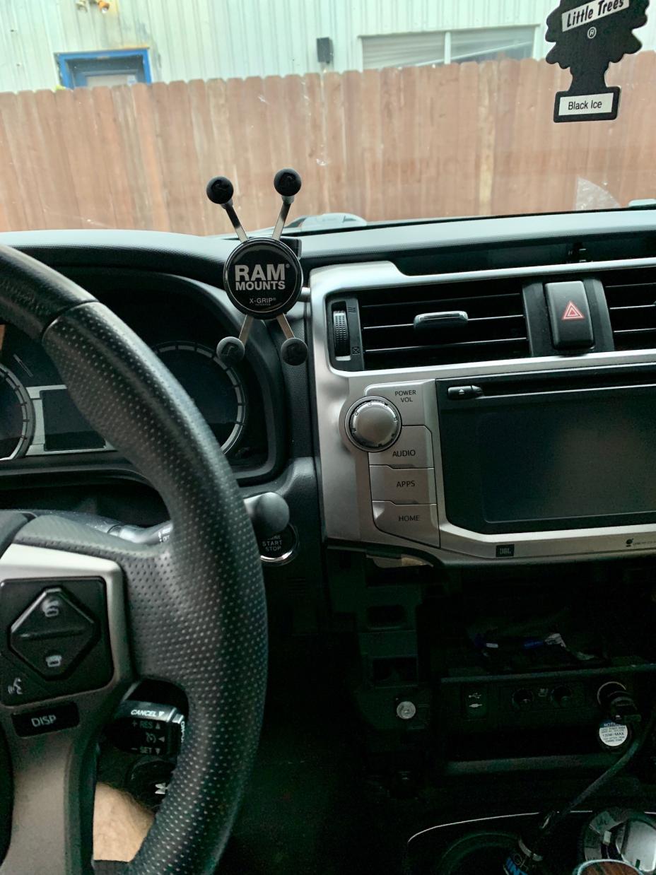

What exactly did you need to order to complete this install? And did you have to remove the vent itself, or was there room once you pulled the radio dash kit up?
Thanks

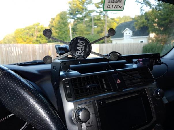

I did pretty much the same thing with the stuff from 67designs. Removing the driver's side a/c vent to get all the hardware tightened down was tricky, but it was totally worth it. This system is solid, and one handed operation is a plus. [emoji106]

That one has a big mounting base and in the pictures above it looks like his Ram mount has a much smaller base mounted to the dash, so im wondering if the vent needs to come out with that setup. Taking the vents out is a pain.
Though i have an aftermarket radio setup so i have some room on the dash beside the radio where i could possibly mount it as well. But dont think that would look as clean.
Thanks
No removal of the vent, it was a tight fit but it will work without having to remove the vent. Just remove the dash kit.
Here are the parts:
Amazon.com: RAM X-Grip Universal Phone Holder with Ball
Amazon.com: RAM Ball Adapter with 1/4"-20 Threaded Hole
Amazon.com: RAM Composite Double Socket Arm: Electronics

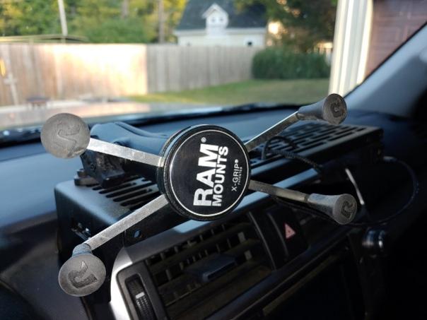

Has anyone tried the Panavise 4Runner Mount on the passenger side of the vent?
https://www.panavise.com/pdf_indash/75137-310.pdf
I ordered one and was planning on getting a RAM mount to attach to it because i dont wanna drill anything in my dash. But i didnt realize until buying it that it was only compatible on the passenger vent side of the center hub.
I asked and they were like nah we havent gotten much request for those yet. we might make them.
Does anyone have experience with them and specifically if this mount works well?
I bought a mount from panavise, as well as another mount from ram.
I didnt want to drill any hole in my head unit so i ended up using 3m tape. And the panavise mount was for the passenger side, but i ended up doing it for the driver side cause i asked them and they havent had enough people to request it to make a mount for it. but it ended up working out good.
So panavise suggest you mount the thing via screws but i am hesitant to screw anything in that is not oem. so i 3med taped it.

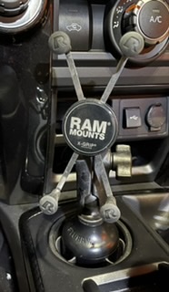

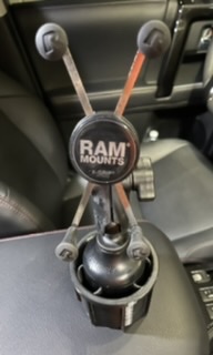

Ordered a RAM® X-Grip® Large Phone Mount with RAM® Stubby™ Cup Holder Base, a solid black cup holder from Etsy, drilled a hole into the bottom of the cup holder, mounted the base to the cup holder.
Removed the OEM Toyota rubber cup holder, inserted the new mount.
It’s rock solid and removable at will!

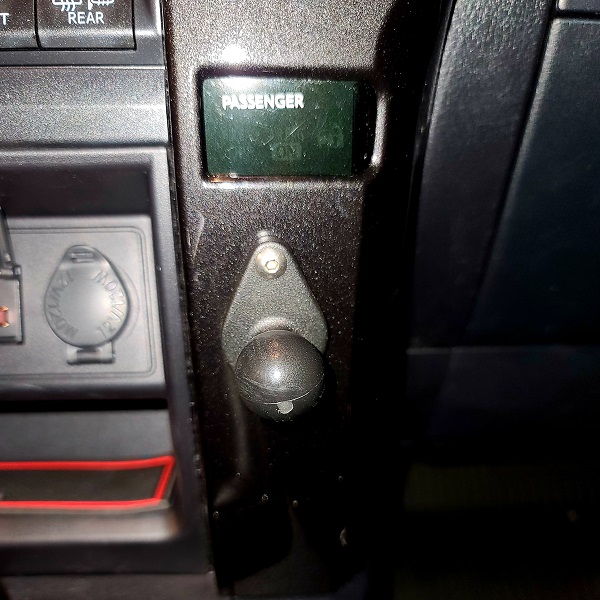

I went with the bolt on Ram Ball, Ram Mount and short connector. I love this and have gotten my cup holders back.

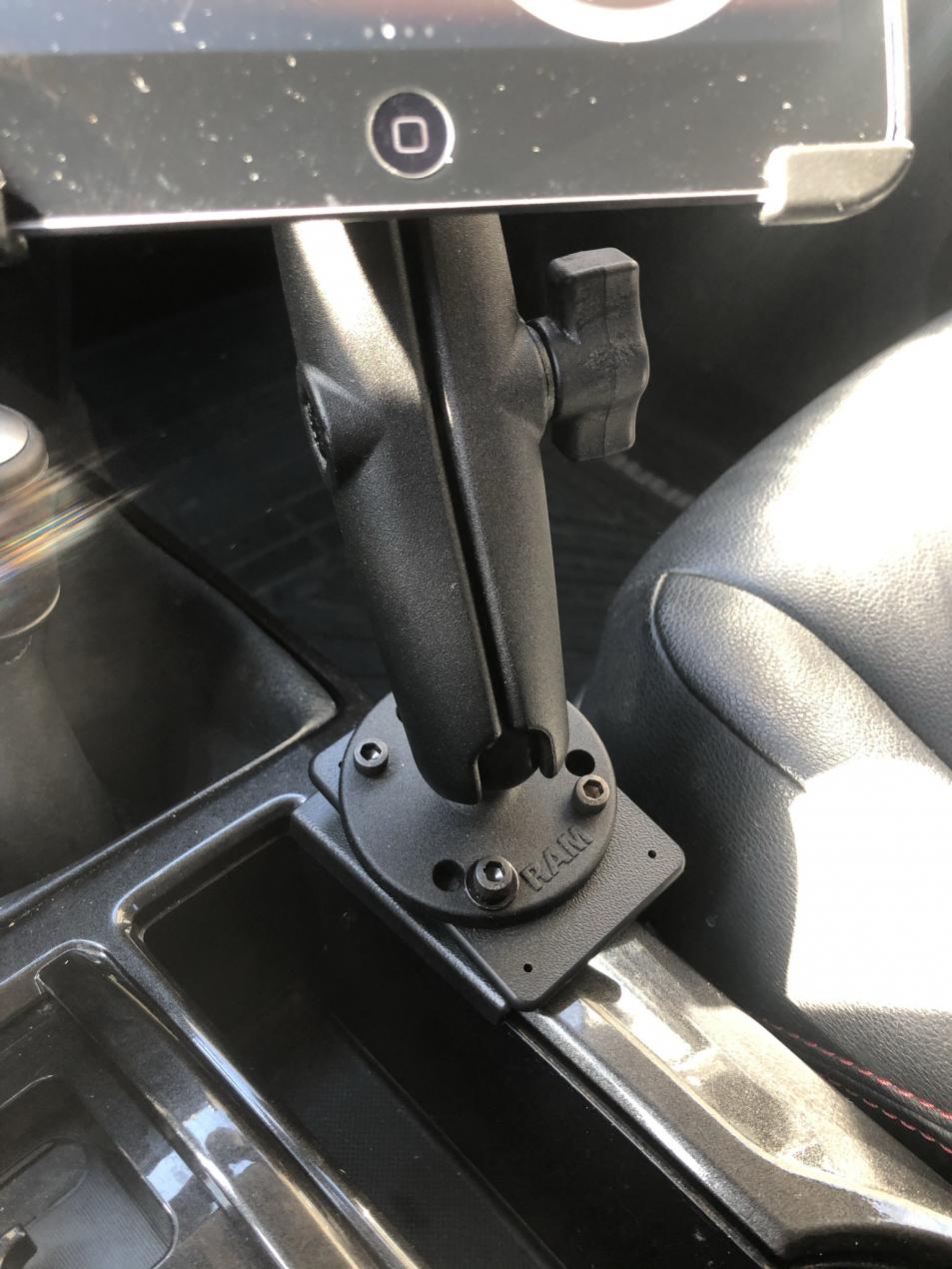

ProClip Mount
Has anyone tried the Ram Tough Wedge in their vehicle?
Just looking for something to keep the phone out of the way when driving. I use Car Play when out but I just need something that keeps the phone out of the way. Cup holders are usually occupied.

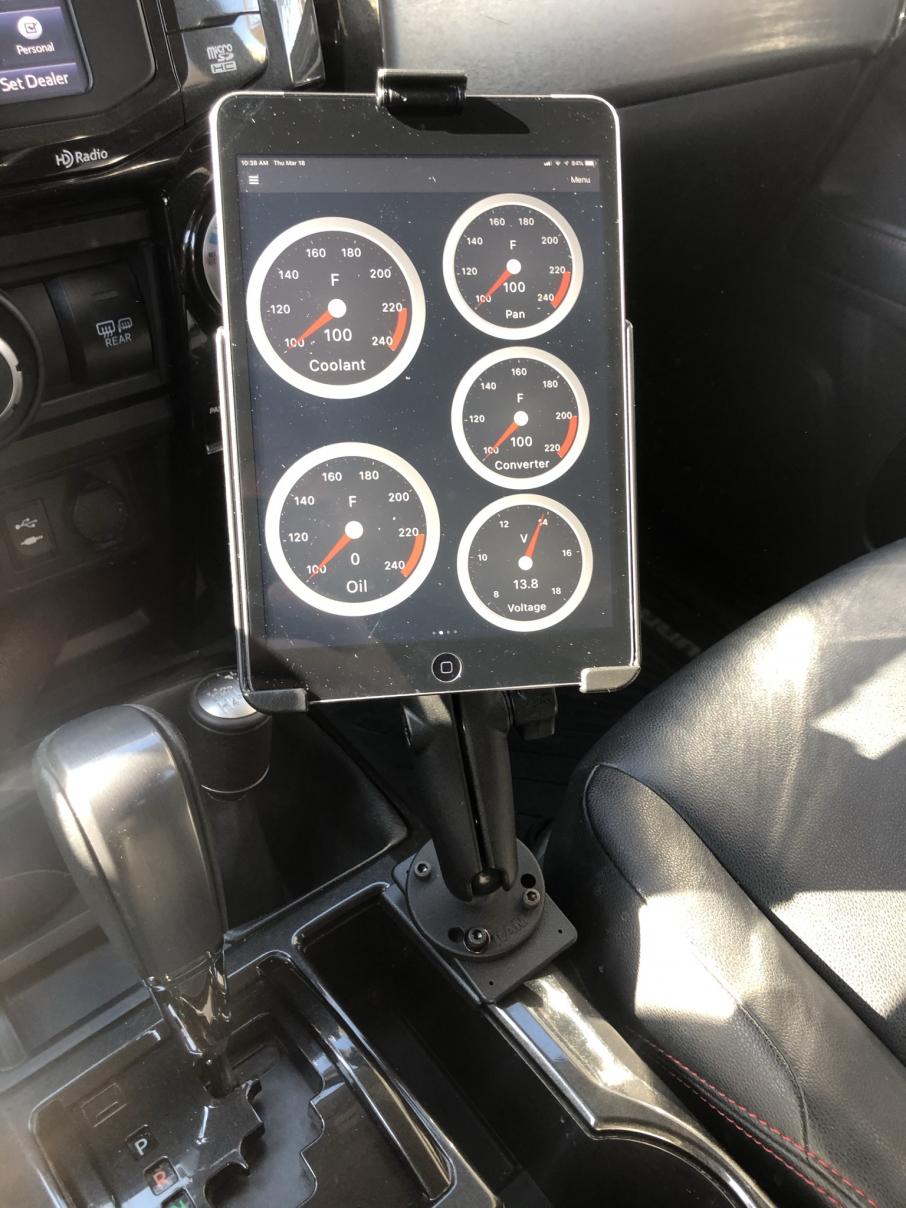

Didn't try the Ram wedge but really like my ProClip console mount. Attached Ram double ball swivel to it with Ram iPad Mini holder. Looks huge but can do same with phone. Passenger has plenty of room. This thing is solid. Have wheeled hard with no problems. Double sided tape ProClip provides is good. Didn't need to use any VHB tape as I had planned.
