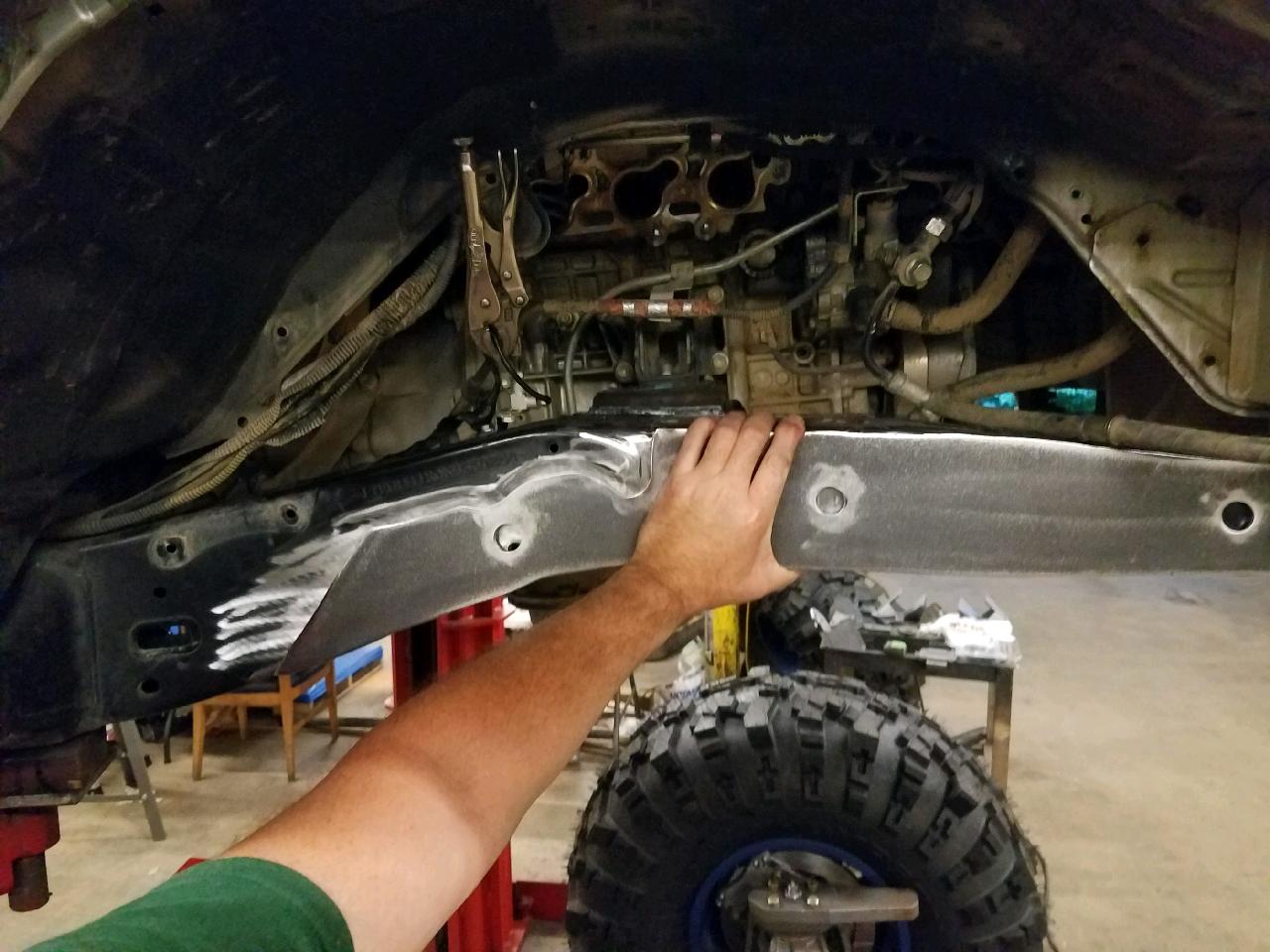

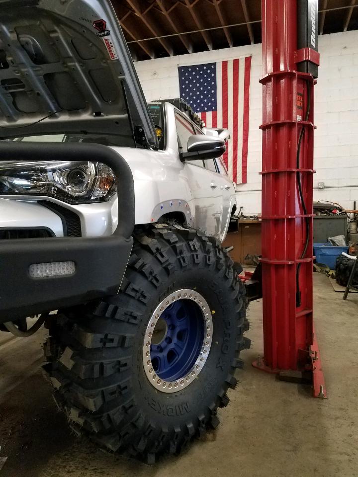

New tires

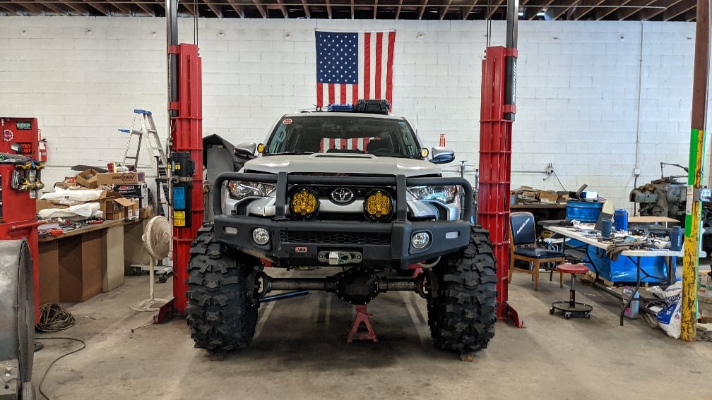

Week 4 ended the 4R going on a diet.
Yesterday there as a bit of cutting of the body / bumpers to get the tires to fit. this is all done until the suspension is installed to test everything. The photos below show was should be full compression.
The engine has been raised 2" and due to the whipple supercharger we will also have to trim a little of a few of the hood braces.
Tomorrow the rear links will get welded in and steering ram mount mocked up.

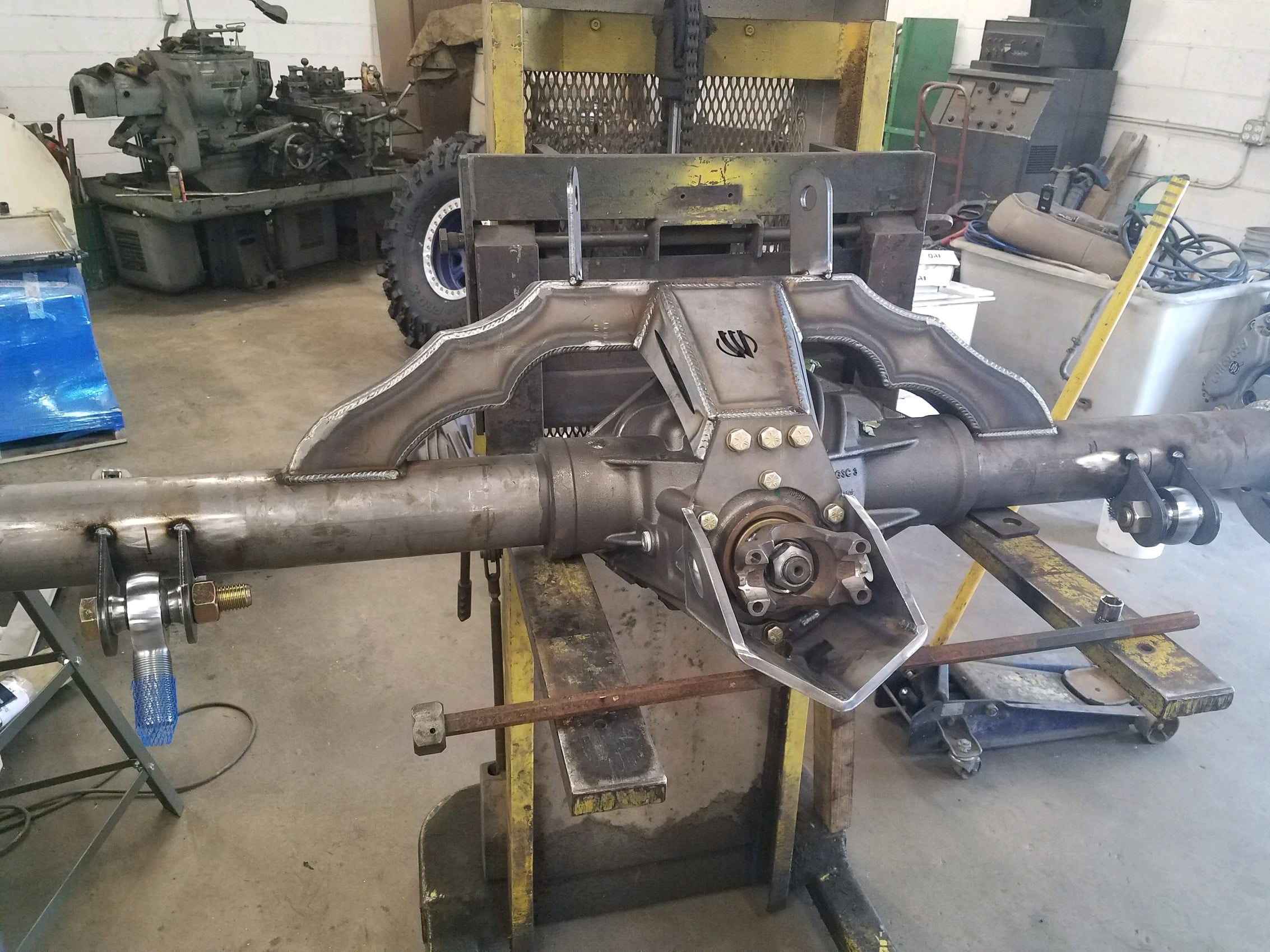

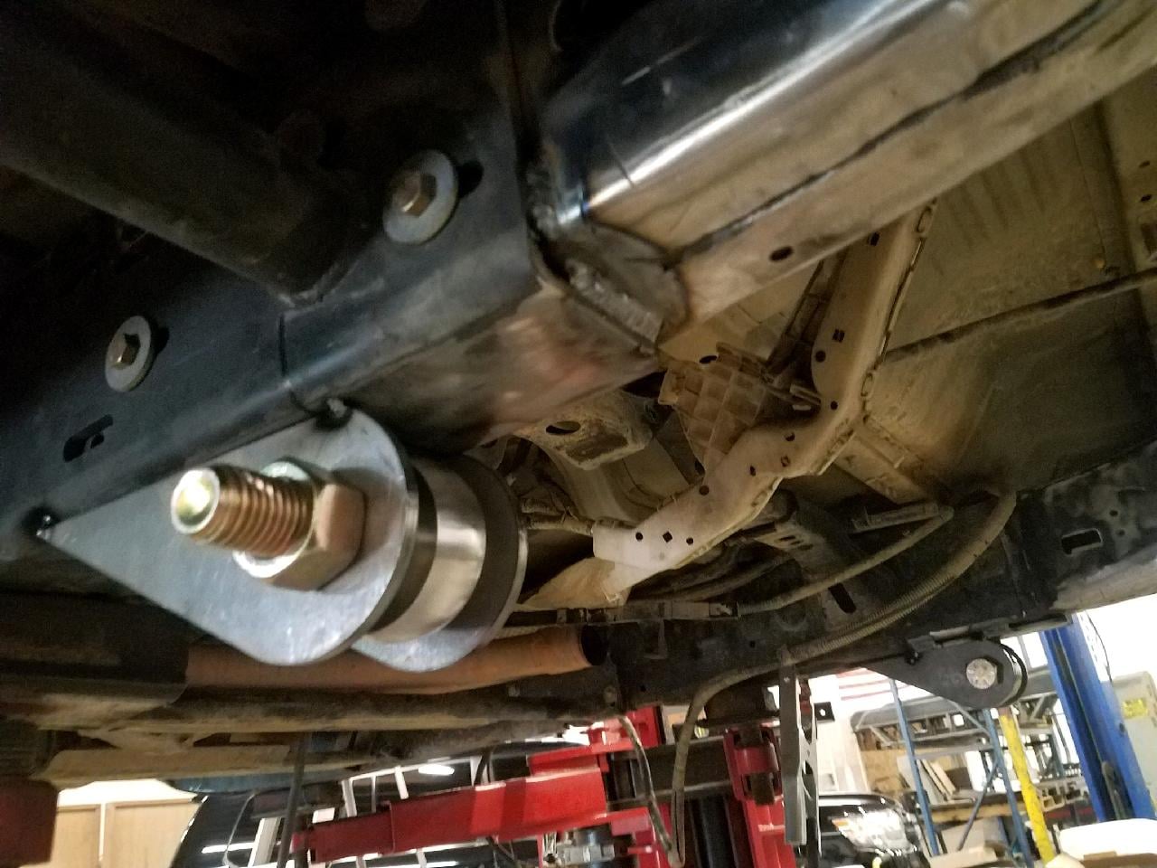

Rear Axle almost ready to be mounted
Now we will start seeing a lot more building and less tearing apart.
Today as I mentioned last week we started on the rear axle. All parts arrived yesterday so mounting the rear axle is immanent.
We didn't want to mount the upper links so high up but that's what gave us the best results. It will be braced and be plenty strong. We have measured and checked and measured again and should have no interference with the floor under full compression but it will be close.
The following items were accomplished:
1. Welded truss to rear axle
2. Mounted and welded the pinion tie in guard
2. Mounted lower link tabs
3. Mounted half of the upper link tabs
4. Welded sliders to frame
5. Tacked the lower link tabs to frame
6. Upper link tabs welded together and will be tacked to frame first thing in morning
Tomorrow rear axle will be mounted with 4 links and then check all clearances, work on coilovers, and finish any cutting required.

Good thing you're having to cut a lot off because that rear axle doesn't look light! What's it from, a D8 Cat?
Yes it looks heavy but both axles on the pallet weighed in the very low 900# range so without pallet let's say 425-440 on average each. It's a very common rear axle to use in back for SAS's but not as common to use for both front and rear. Their origin is from HD trucks.
The 14 bolt axle was originally from chevy/gm in vans, HD trucks, and the suburban. As I mentioned in first thread, the foundry who made these has closed so new ones are hard to find if not impossible. However hope shouldn't be lost as there's still the junk yard, which is not as easy as it was in past. Now I've discovered the new Ford super duty trucks are using a new 14 bolt which I suppose is sourced from AAM. No idea with Chevy and Dodge use in back today on their HD trucks.

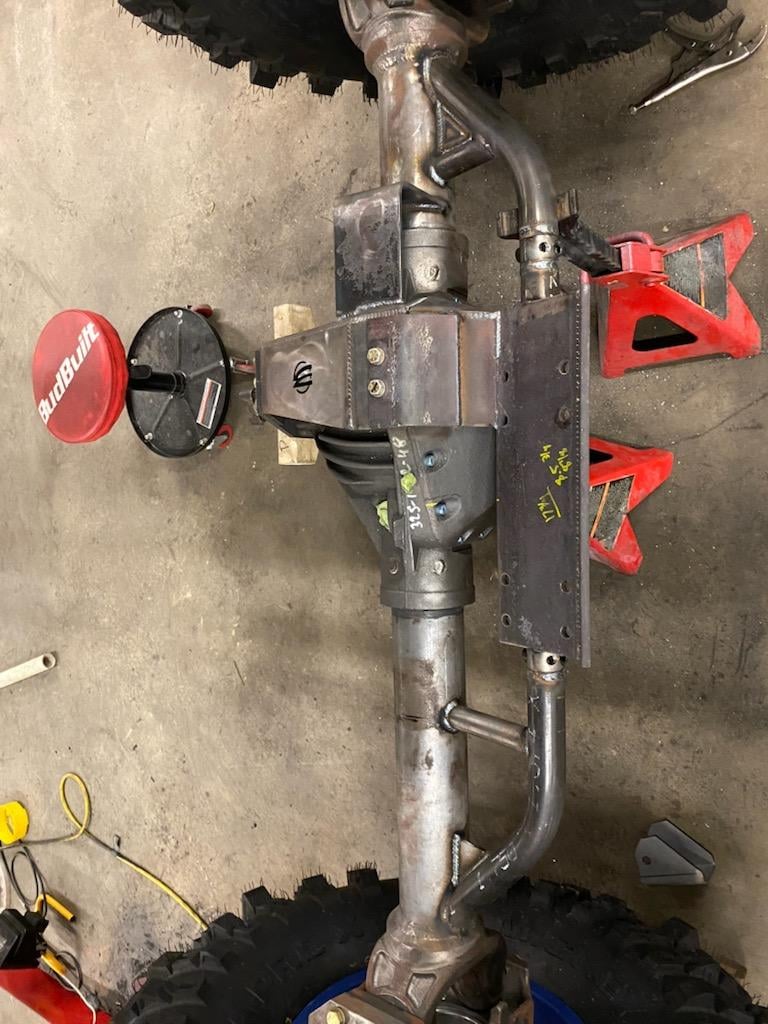

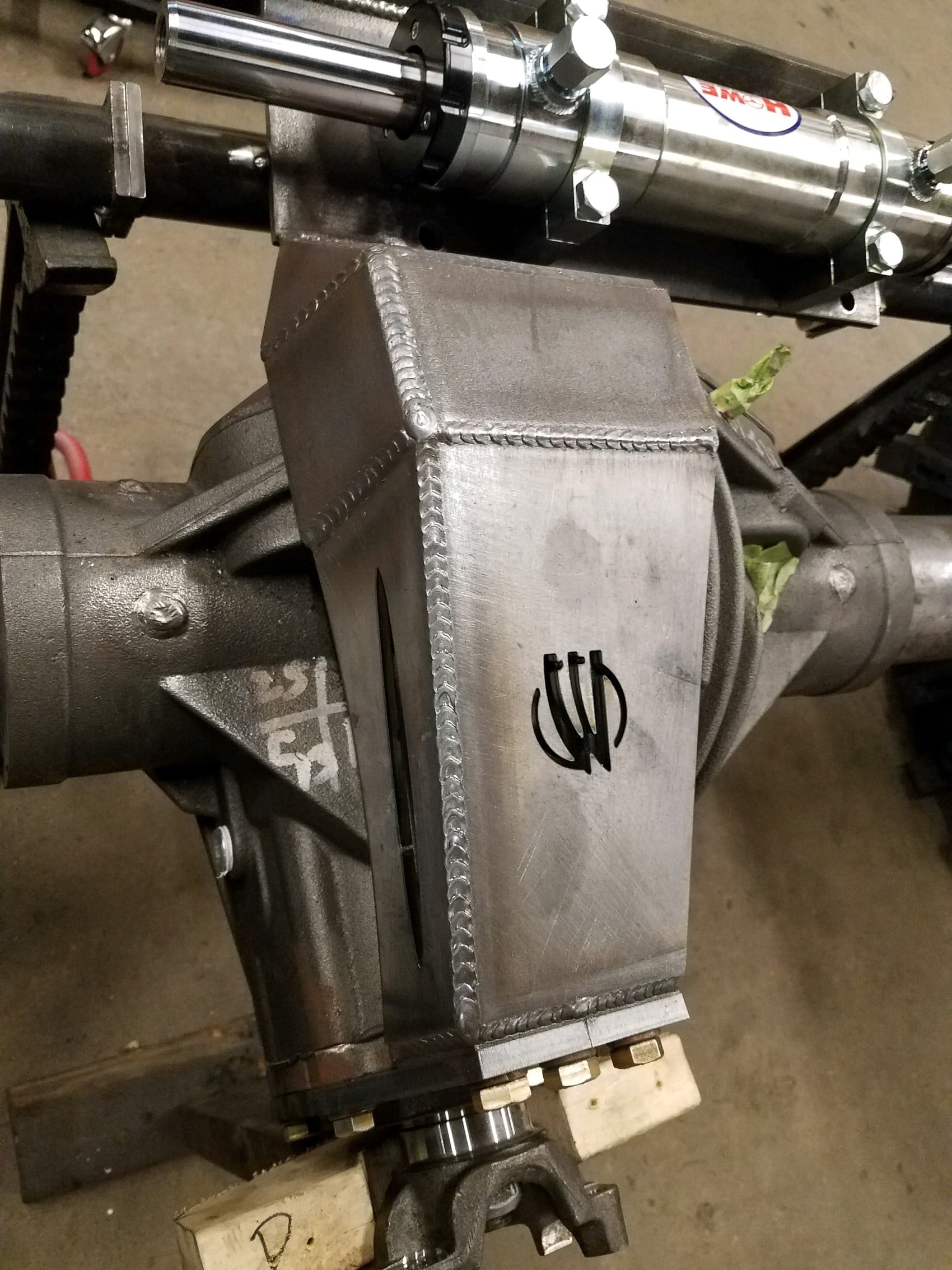

4. Front Ram has been mounted with some additional protection built in.
5. Front pinion guard installed and tied into the ram mount protection. this was featured on Wide Open Designs instagram page this week

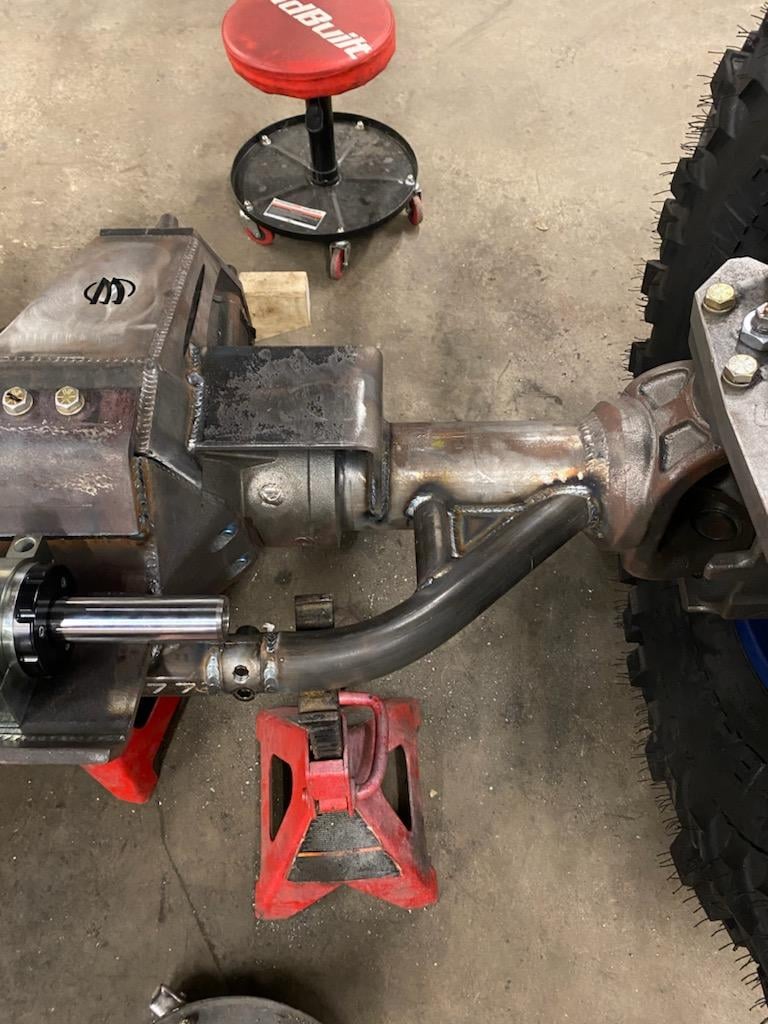

Below is the nearly finished front axle steering rack mount. The front is removable for front diff maintenance.
