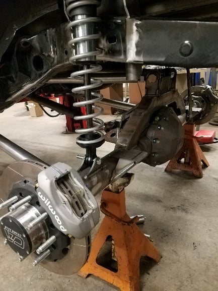

At this point I tend to agree on the spring rate. The springs in now are the helper springs not the main upper spring. Those will be in 500# range. We are working with wide open design on the springs and they build rock buggies and rock bouncers which is again an entirely different world. We are not sure the starting rate on the helper springs which is why we ordered 5 set of springs on Friday for delivery Monday. They are great in that we can send back all the springs we do not use. So by the end of the day Monday, I'll know what the final mix is front and rear.
Definitely not a go fast truck. This truck would not do well at that and would need additional suspension damping like most of west coast do with bypass shocks.
In any case short of a custom built rock crawler or rock buggy with ifs 4-6" is most common amount of up travel with lots more down travel. Last year I wheeler with a guy in cherokee who had 60" of total travel. He had so much up travel had rear floor cut. We could add 2" more of up-travel in the rear but would have to cut the floor to allow the links to move up into cabin. The expense of doing this is just not worth it. My 4R will be plenty capable and serve me well for a long time. I have 16" shocks and we will limit the total travel to 15.5" split between up and down.

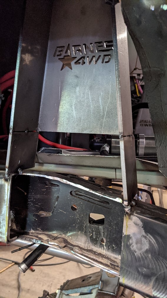

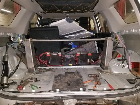

Here's the only photo I took today of the beginning of frenching the rear shock towers. You can see how thin the frame really is. In fact this part is a little thicker where the holes are but rest is rather thin.

With 16" coilovers you are looking at multi rate springs, where you have multiple springs with differing spring rates stacked on top of each other. Also keep in mind with a solid axle, the spring rates will be much lower than with the IFS springs which are leveraged like 2:1.
When you start getting into this realm of travel, you can't sit at 50% ride height without being massively tall and a horrible COG, so you sit low in the suspension travel and have tons of down travel.

For example, I had 700# springs in the front with my IFS and today have a 150# helper spring in which may go up to a 175 and then the top spring will most likely be in the 250 range. I will confirm all spring rates on Monday once we have the best set installed.
We have done our best to keep the truck as low as possible naturally, several weeks ago we jointly decided it was best to raise COG up 1" for better clearance of the tires. It's not so much the height as it is the width of the lugs. Now we have zero clearance problems under compressor or lock to lock with the steering.

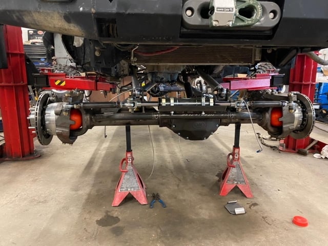

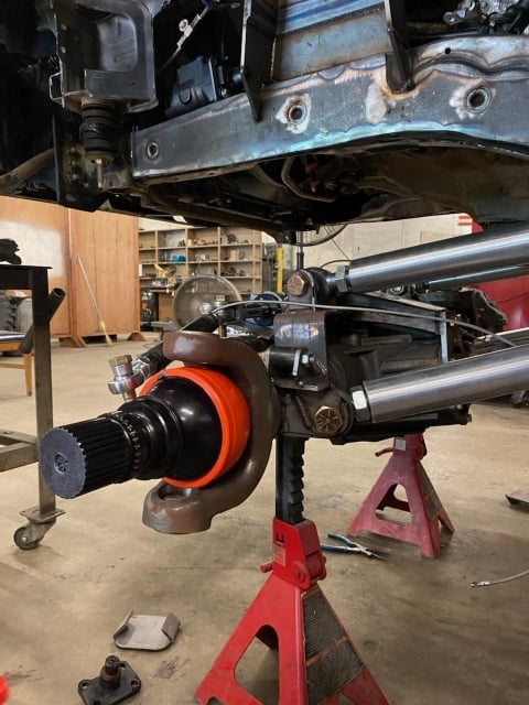

Here's a few photos from the end of the day yesterday and from today getting the front axles getting installed.
You see the rear tire at full stuff, the amount that was made for the steering pump and then two different angles for the front RCV axle shafts.
It was one thing to see on the axle the 47 spline female end but now to see it on the RCV is just awesome.

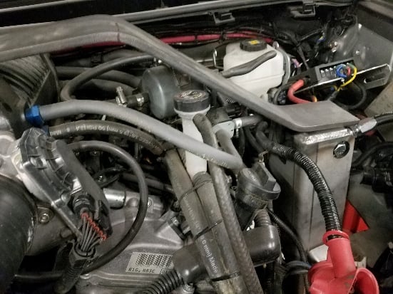

A short update from this morning. After first looking at the fuel tank and sending unit on Saturday it was determined 100% late yesterday we would need an external fuel pump. After some correspondence with Gadget from URD we determined what to get, etc.
We were not able to find a Holley, Aeromotive, etc for delivery within Tuesday so, I went to Amazon and found an evil energy pump, filter, and mounts which will ship today for delivery tomorrow. So today they will prepare the supply lines and electrical connections to be ready for a "quick" install" tomorrow when it arrives.

The bump stops have all been installed and that took longer than anticipated today. You can see in the one photo they were melted on the inside of the frame rail in the back.
Also got the shock Tower brace installed in the front. Had always planned for it to be tubular but after trying to find a way to do it around the front of the supercharger decided to do it with the flat stock which will be both to the top of each shock tower and go over the top of the supercharger and still allow the hood to close without any issues.
Also nearly completed the brace between the two rear shock towers it just needs to be removed with two bungs welded in so it can be removable.

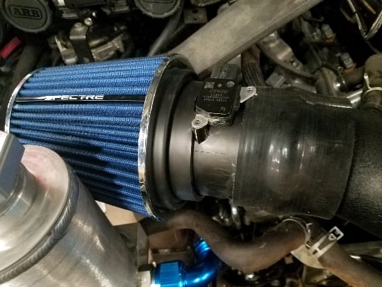

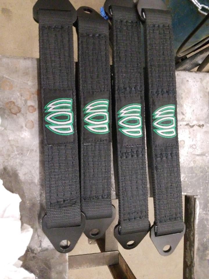

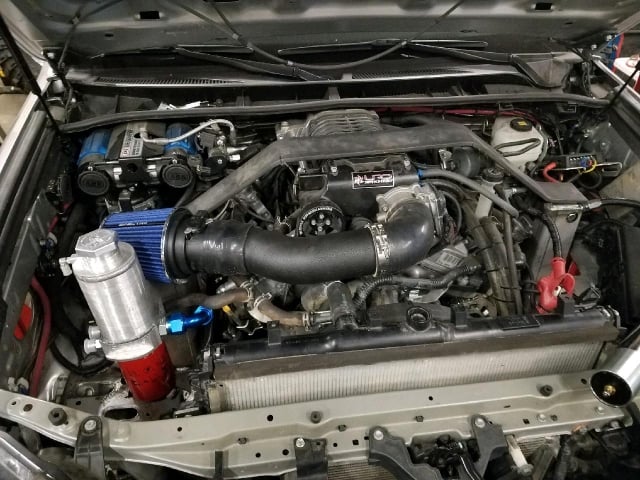

Also, got the air filter more or less placed. Tomorrow morning very early the limits traps will be put in and then route the final bit of plumbing for the steering and lockers. Have a few more mounts to produce to mount the few steering pieces and that will be the second thing completed tomorrow morning.

6. Install limit straps

Well we finished a lot but not all of what I listed above for today. It will be driving and at ATR but I will not drive it off-road. This is the case because we have not been able to test it at all yet.
On top of this we've been having a heck of a time with fittings. Today we ended up tig welding two aluminum fittings together for the oil filter relocation but I ended up breaking that fragile weld when attaching them to the block off plate.

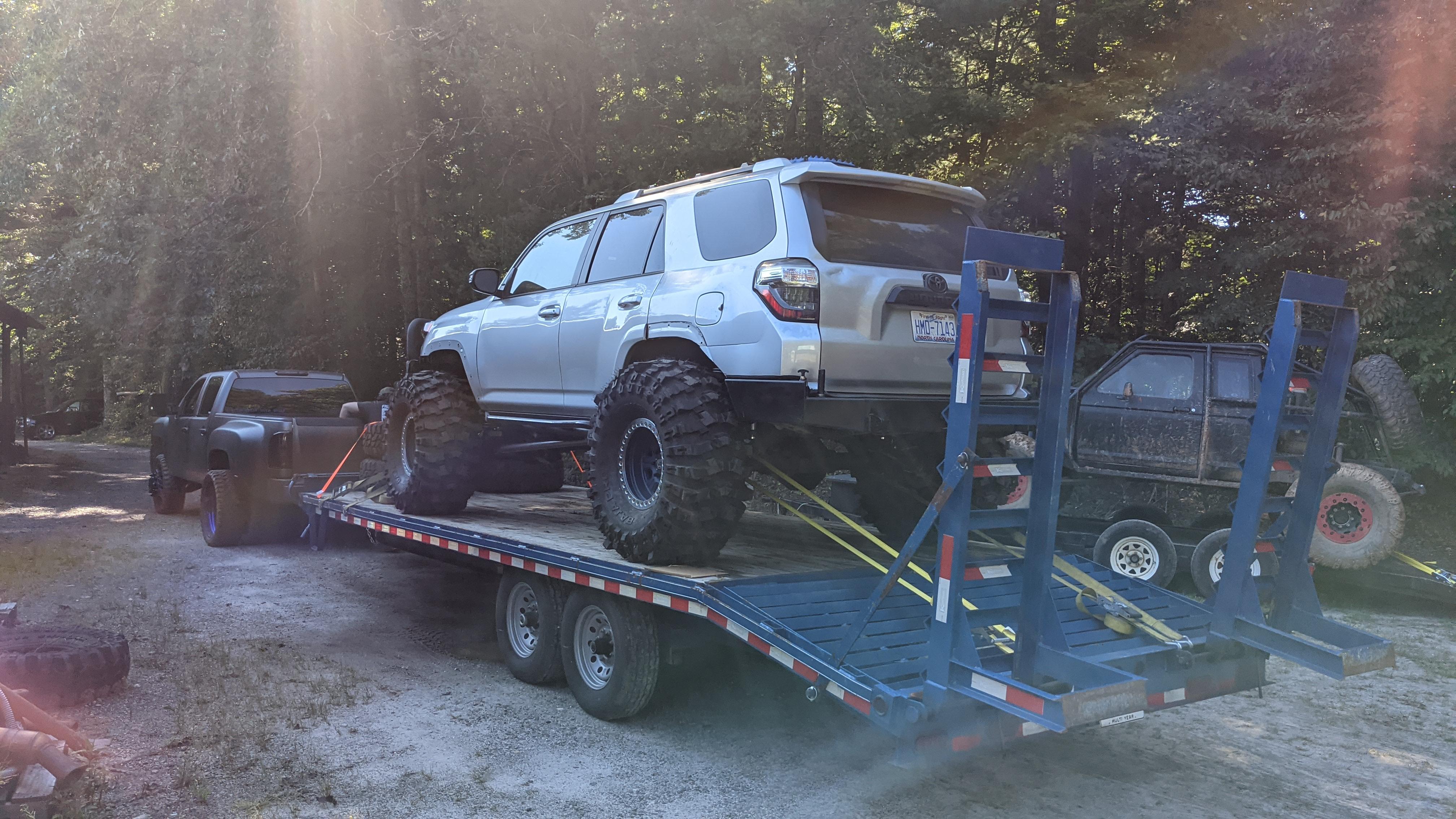

Well, too many fuel pump problems last night and the truck is not drivable at the moment. But it's on the trailer and we are taking it.
