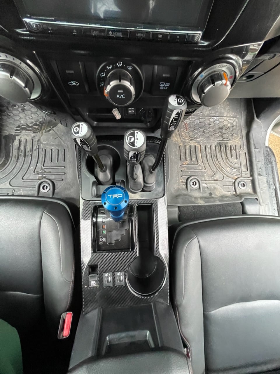

Atlas or at last is ready for action....nice progress on this

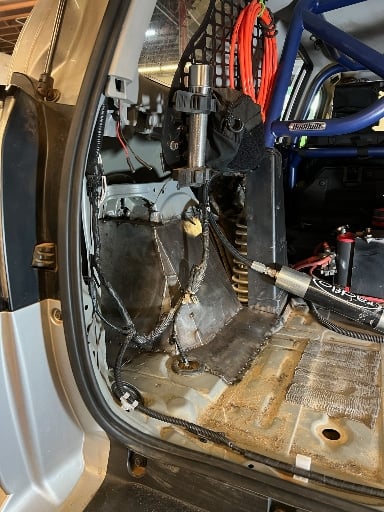

Yes, it's been ready for a little more than 2 weeks. install of the atlas per the calendar was a little more than 2 weeks, actual time was a few days. spent more time on the cable routing for the shifters and the atlas itself. we brought the cables in near the firewall in front the heater fans and stuff in front of center console. we had to make some simple guides for the cable to make a soft 180 to go back to the shifters.

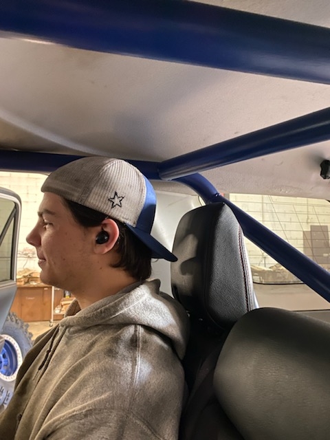

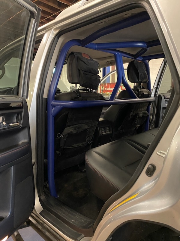

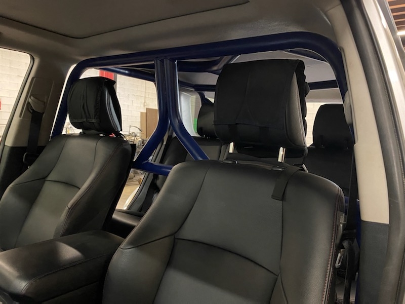

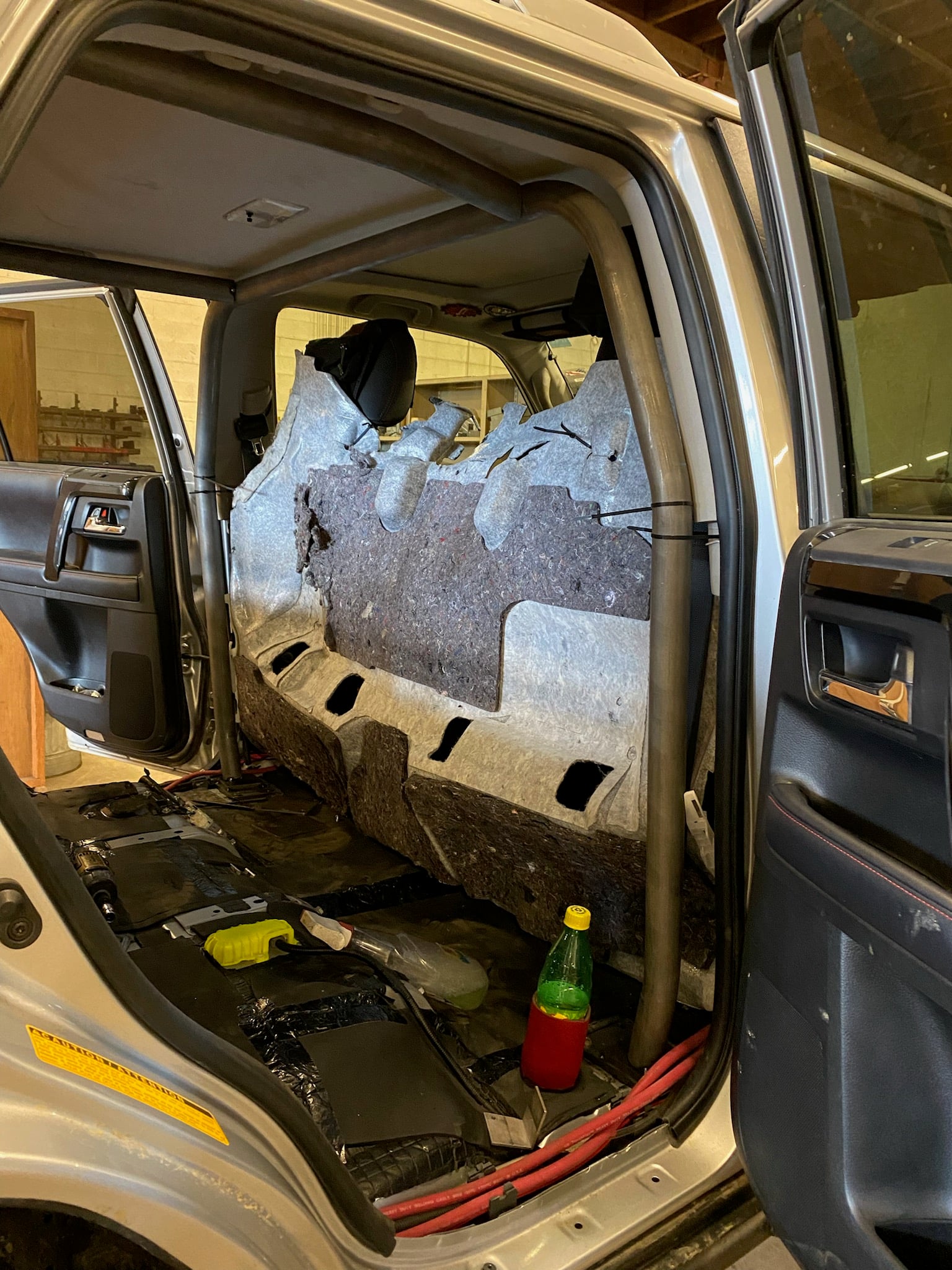

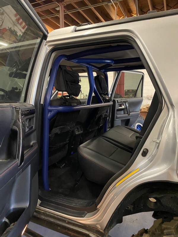

The internal cage is done. Probably the first cage inside a 5th gen. We are continuing to think/plan how we will manage the A & D pillar. The internal was built to maintain some level of comfort and access rear seats.
The internal cage was built using 1.75" .120" wall DOM tubing.

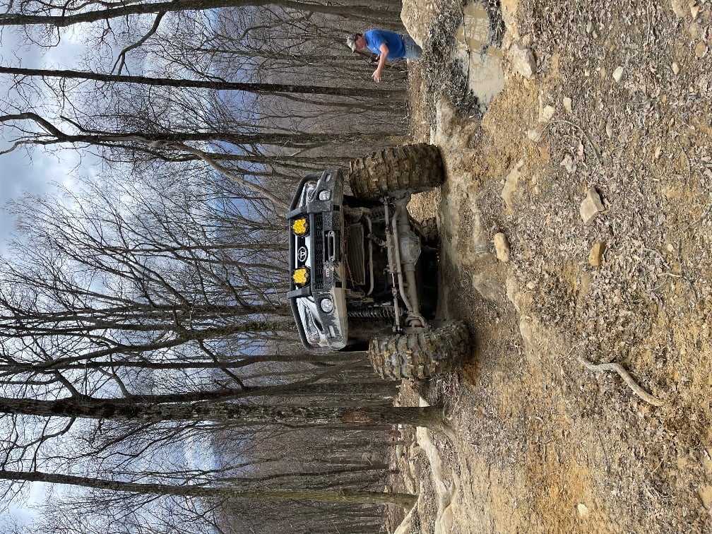

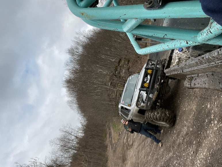

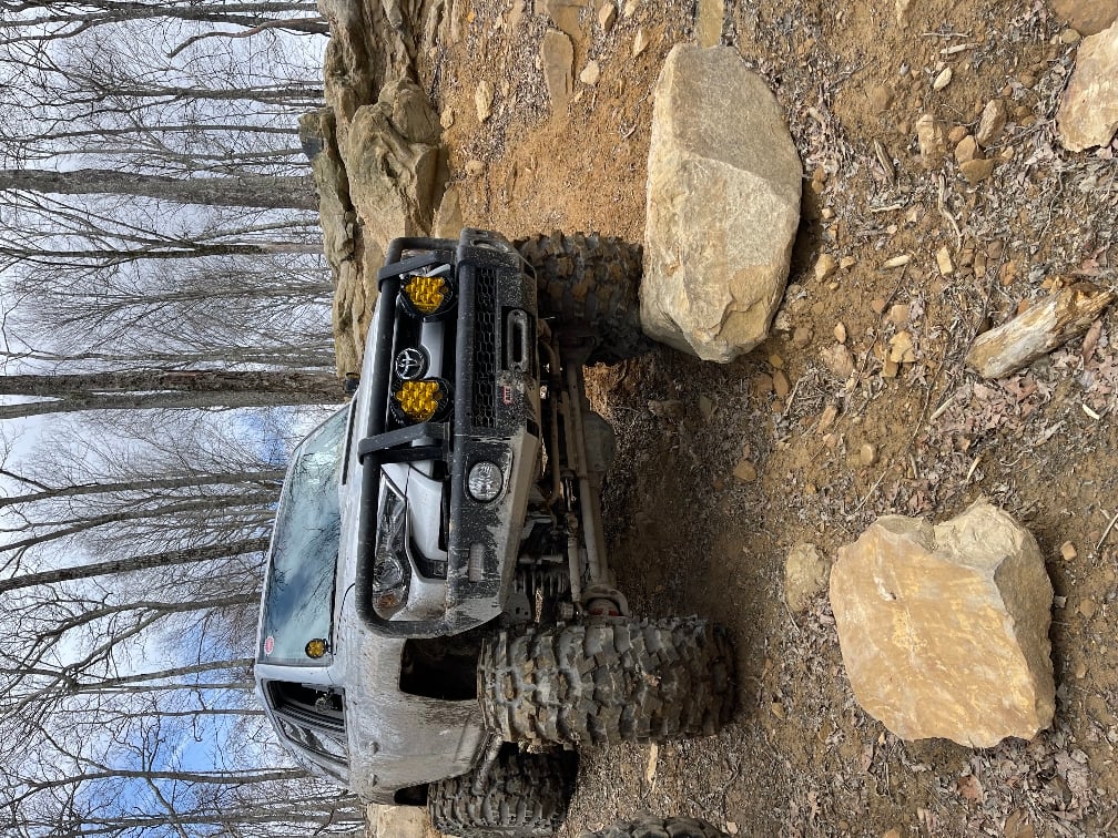

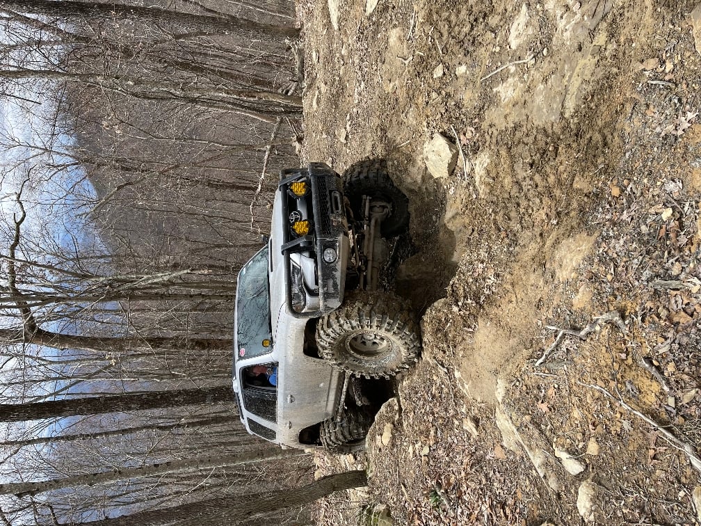

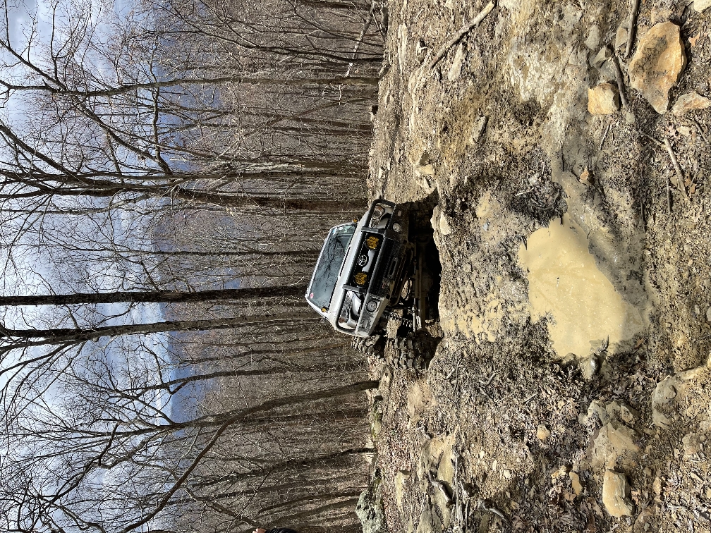

While I put together some videos from this past weekends trip to Black Mountain park in Harlan, KY, here's a few photos. This was by far the hardest I've pushed the 4R ever and my first trip with the atlas installed.
I went with #wheelin with Willie and the guys fr Budbuilt. The other vehicle is an '82 scrambler with LS5, 14 bolts front and back, np203 case, and branik shafts.

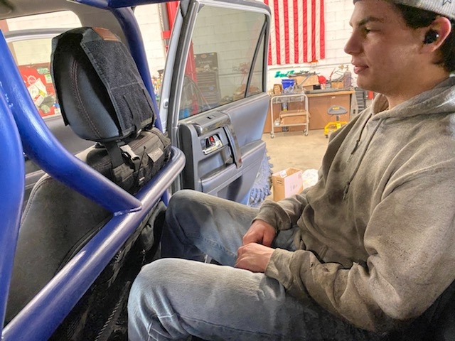

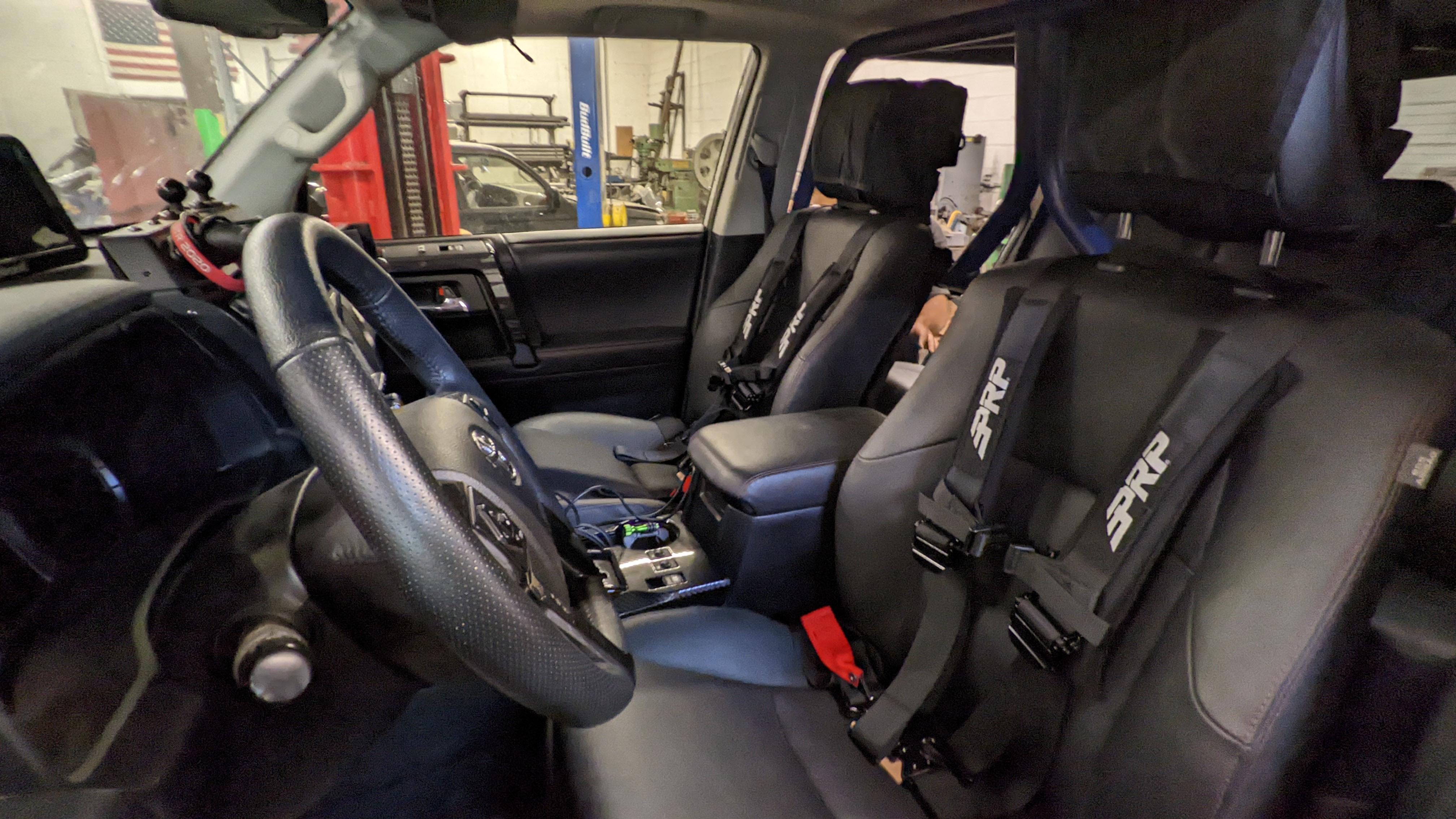

Also finally got the 4 point harness installed. Connected shoulder straps to cage and waist straps to stock locations. We had to mill down the stock bolt for the shoulder strap and used bolt on seat inside. It was a simple install. Ended up connecting stock shoulder strap to receiver under the seats to avoid annoying chime.

Don't 4 point harnesses usually require the bar to position the shoulder strap parallel or above the top of the shoulder?
Yes, it's more common to have them higher up, but no problem here and well within what is commonly done. If we would have put the bar higher up it would have caused other issues with seat positioning, reclining, etc.

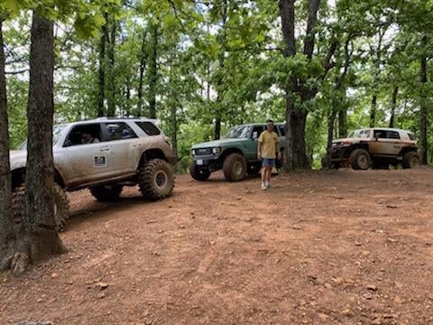

Here are a few photos from last week at the Texas event.
The first one we have three Toys on tons.
I'm in the front then there's an fj60 on 40-in tires with an LS swap and finally in the back is Ken's FJ cruiser from Off-road hub which has Irok 42s. It was great dealing with them.

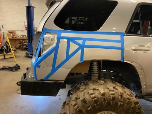

A few more photos from today. The rear wheels finally getting boxed in with sheet metal welded to the body.

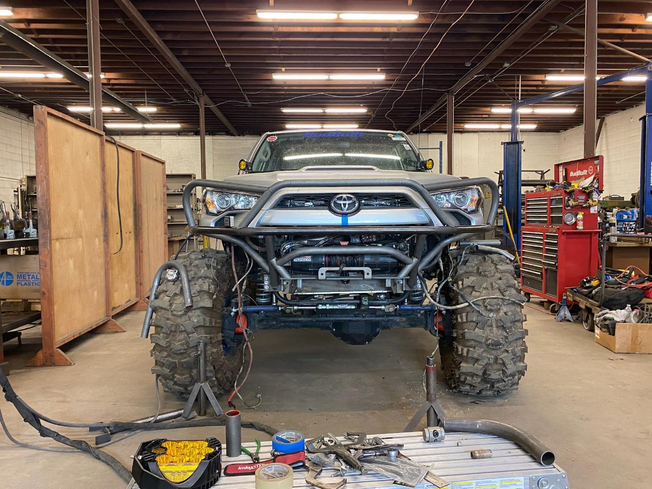

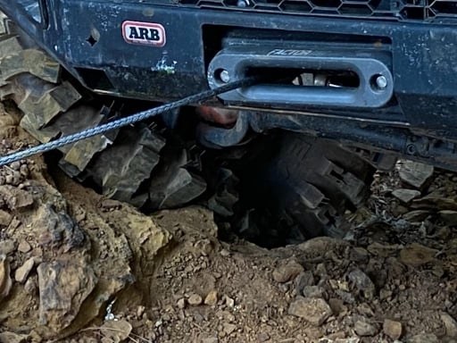

Also looking to remove the arb front bumper as it's showing to be a weak point for what I'm doing. It's a fabulous bumper for most people just not working for me. I will list it for sale soon.
Will build a tube bumper starting with a hidden hidden winch mount. The bumper will tie into the mild exo cage which will complement my internal cage. All exterior tube will be 1.75" .188 wall.

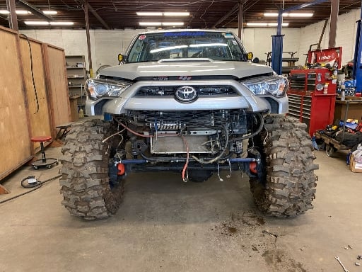

Here's the start of the new tube bumper. Maybe one more small tube and then weld everything. This solution has moved my winch back a good 5-6".
Sent from my Pixel 5 using Tapatalk

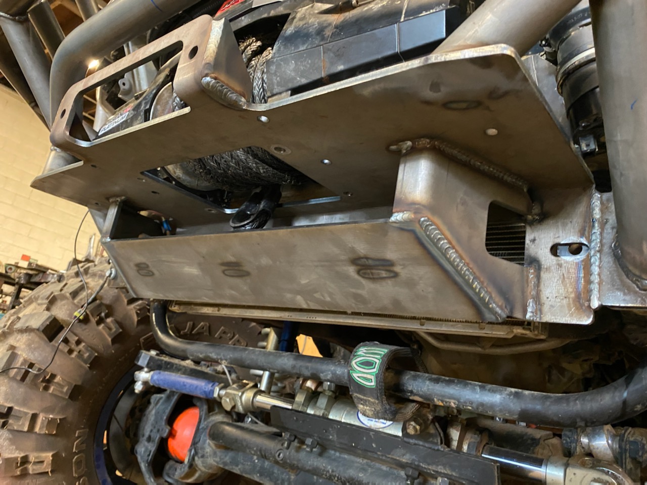

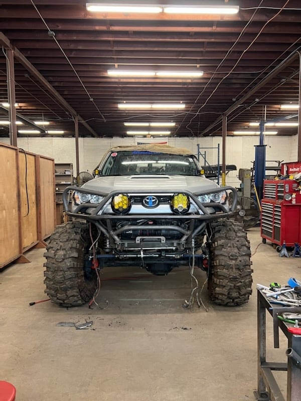

Here is the final bumper. It will be sand blasted today and powder coated on Monday.
My lp9's have been frenched back into my remaining upper bumper.
Added the small skid if you will under the winch to protect the radiator. It's gusseted underneath. Also put a gusset on the fairlead.
