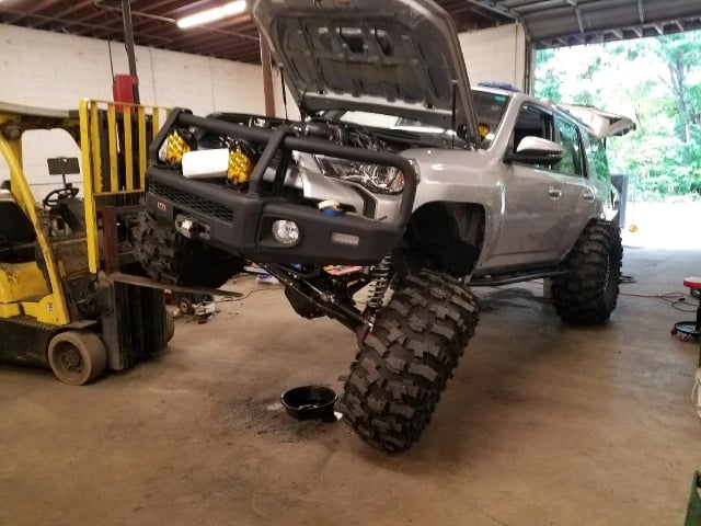

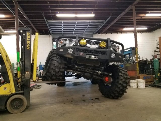

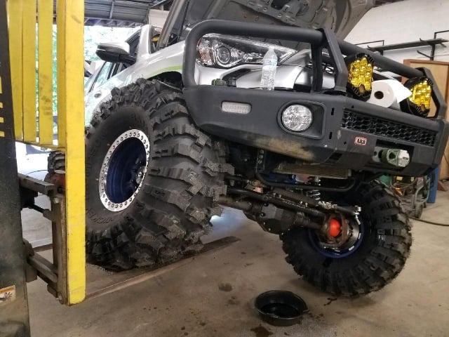

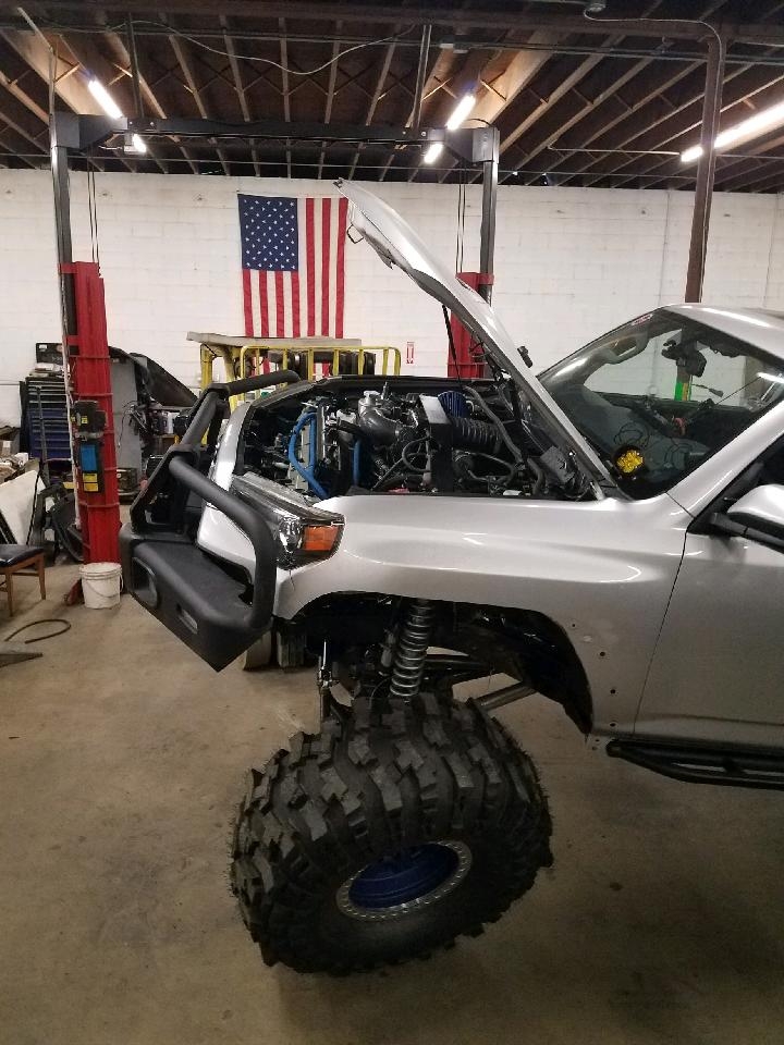

The truck is just about done. Here are some flex pics from today. Ended up trimming the front and rear fenders a little more to get the maximum flex.
I will take it back to windrock the end of next week and hope that the atlas transfer case will be here about two weeks after. This is going to be an amazing vehicle and beyond my wildest dreams and terms of capability.

It was put back on the lift to get a good look at what really happened my first day out. A lot easier to look at everything when it's up in the air then on the ground and all dirty.
So here's what we found:
1. Both rear bump stops had issues. I knew this as I had to tighten them up after day 1. The passenger can ripped the frame a little. All is no problem and easy fixes. We will remove both and reinforce the frame in this area and fabricate different top to bracket to keep the cans secure.
2. The bump problem is what most likely caused my cut fuel line and hard starting issues but more on that soon. At some point the top of the rear links went up and first just barely cut the fuel line. The driver side top link went up and crushed the evap line, this alone is most likely what caused the hard starting issue.
3. Need to extend pad for front bumps a little as depending on angle of axle they are hitting the edge or sliding off under compression.
4. Few other minor details on links and steering rod ends.
5. For my major steering issue, we are going to add more line and either a secondary cooler, small fan, or something.

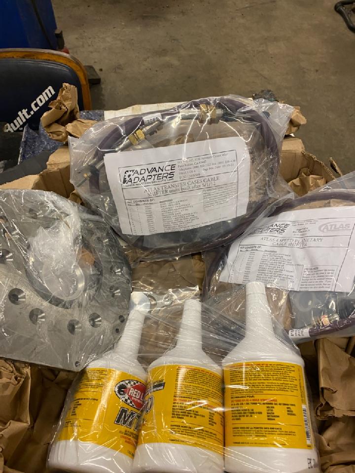

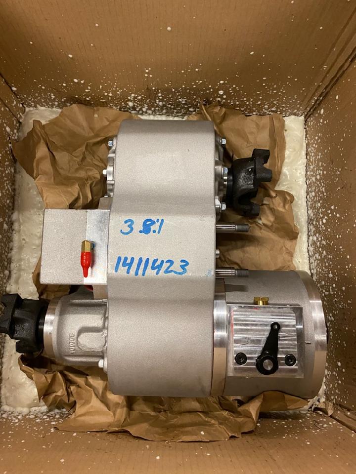

An early Christmas present arrived today. Finally after nearly 6 months the Atlas 4sp has arrived. Total reduction is 10.4:1 (3.81 x 2.72).
This should be installed soon and maiden voyage with it and even further strengthen frame in December.

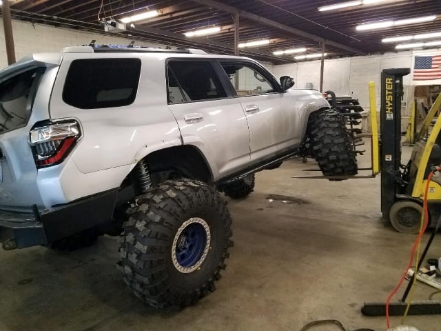

Today we got the 4Runner weighed and if you look at my very first post in this thread you see when I drop it off, it weighed 6,000 lb and today with the spare tire in the back it weighs 6,680 lb. I would say if we remove the tire and put the drawers in it's going to weigh somewhere around 6,450 lb. All of the weight gain even after all of the cutting is coming from the wheels and tires. So really wheels and tires aside it has lost weight.
