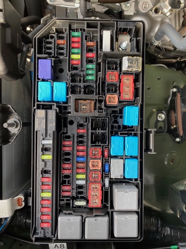

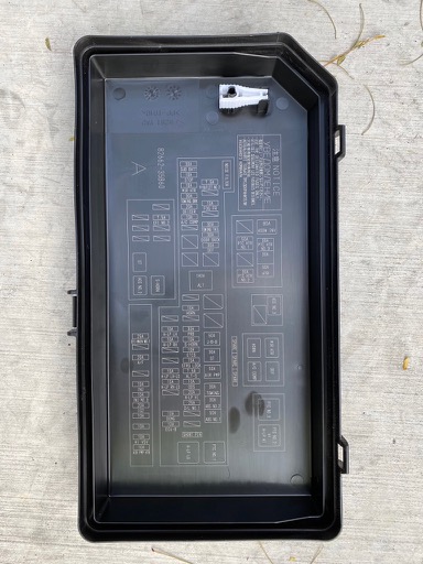

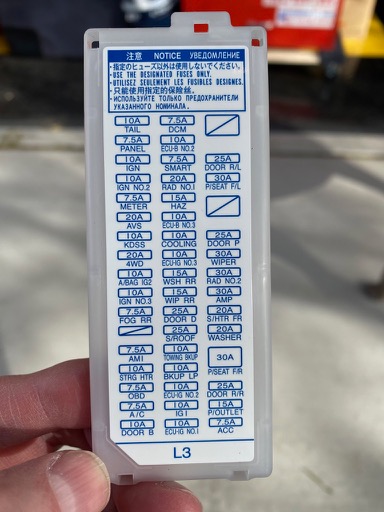

I'm looking for the "mayday" fuse in my 2020. It's not marked under the hood (there are two unmarked 10a fuses in there but neither one of them are it) and the previous year diagrams look completely different from what I have.
Did you check the fuse box on the driver side kick panel?
Not yet, no. In previous years it was under hood so that's where I went. I'll pull down the dash panel and check that at some point.
Interesting that it appears the 20s are totally different from an electrical architecture standpoint.
Here are what the 2020 fuse boxes look like. Unlike any diagram or pic I've seen from previous years and wherever that "mayday" fuse is, it's either hidden elsewhere or named something else these days. Bastards.

DCM fuse is what other Lexus vehicles had for telematics, give that one a a shot.
"DCM (Data Communication Module) Connected
Note Indicates the DCM is connected to the vehicle. The vehicle is able to communicate with mobile networks and/or the internet.
That makes perfect sense. There’s a DCM indicator and signal strength meter on the head unit. I’ll give that a try.

Well, that did it. Data collection disabled. Shame that basically kills the useful bits in the remote control app too but not surprising and really a small price to pay.
