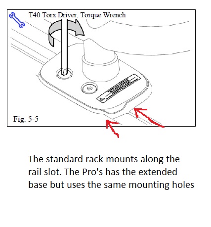

It is my understanding that they use a different mounting base but essentially fit into the same spot as any other 5th Gen 4runner. If I am wrong someone please say so as I am planning on getting one in the not to distant future for my 2016 SR5
Bolt holes are the same 2010 to 2020. Trail and pros have a different bolt/ gasket setup than other trims
Here’s the hardware kit I used for my pro rack. It’s actually for the fj. But if you compare the bolts, foam and composite washer, it’s identical.
Your correct [emoji1417]. I have the pro rack on my ‘16 limited. It bolted right up.
