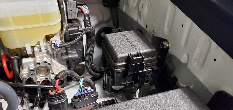

In the 2020 there's a fairly large factory relay/fuse box in the place where we usually install relay boxes/power tray. I assuming this new OEM box is due to the added TSS. The harness for this box is super short and there's not anywhere to really put it.

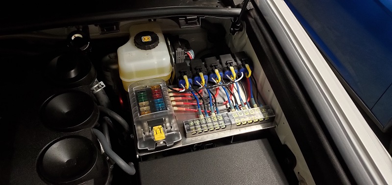

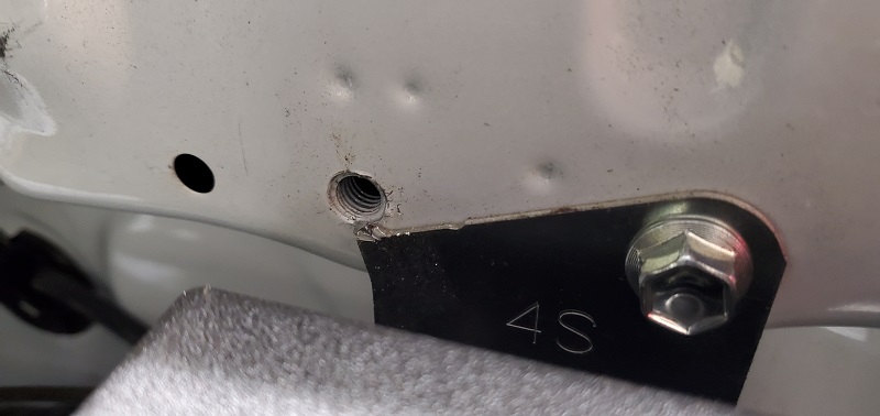

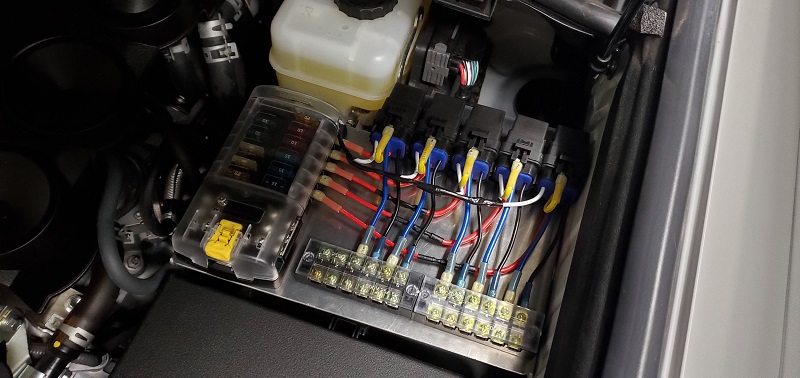

I had a hard time deciding where to put it but just ended up putting it over top the new fuse box. I made my own relay box using the blank tray from powertrays.com. It was one of the most difficult things I have done to my vehicle. Trying to screw in the two screws into the sidewall was near impossible with that new fuse box. I hope I never have to get into that fuse box because I don't think I will be able to put the powertray back on, let alone remove it.
I also had to clip the little retaining/grounding piece off the bracket that holds it to the sidewall. I will try and post pictures. I'm new around here so sorry for any formatting issues.
I think if I would do it again I would find a way to put it on the other side of the engine compartment, but then I would be restricting myself from a second battery.

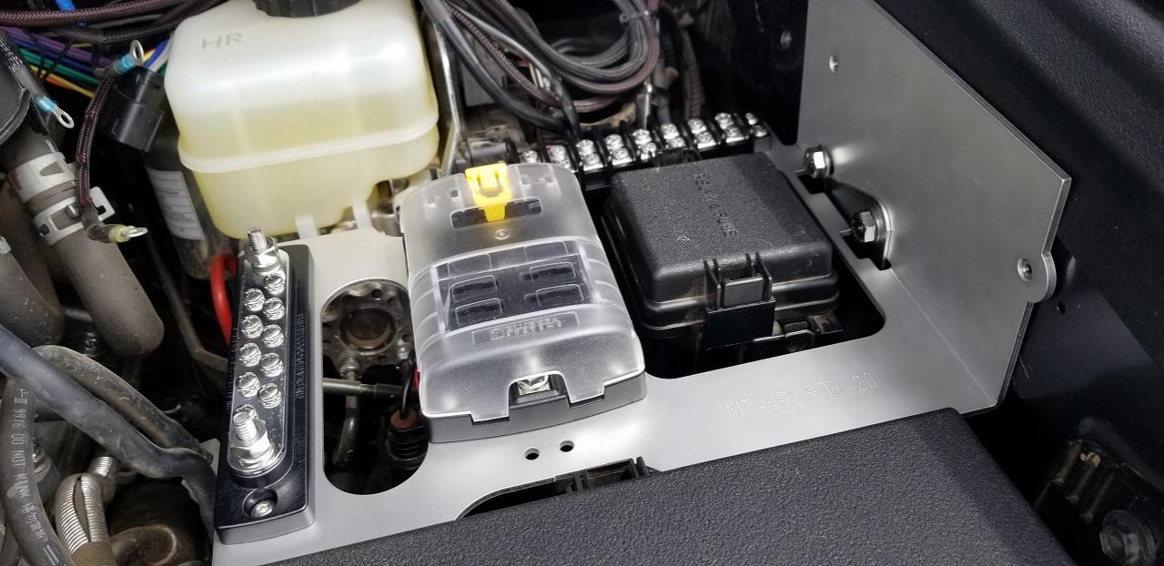

Here's what Spacebanana was talking about. Just got these in. Couple cables coming in this week.... ready to ship now without them.... PM me for more info

If you're asking about the Mount tray, I do not think so. I may be able to work up something so it would, but I do not have the footprint nor needs that the SPOD needs to be attached and connected right now....

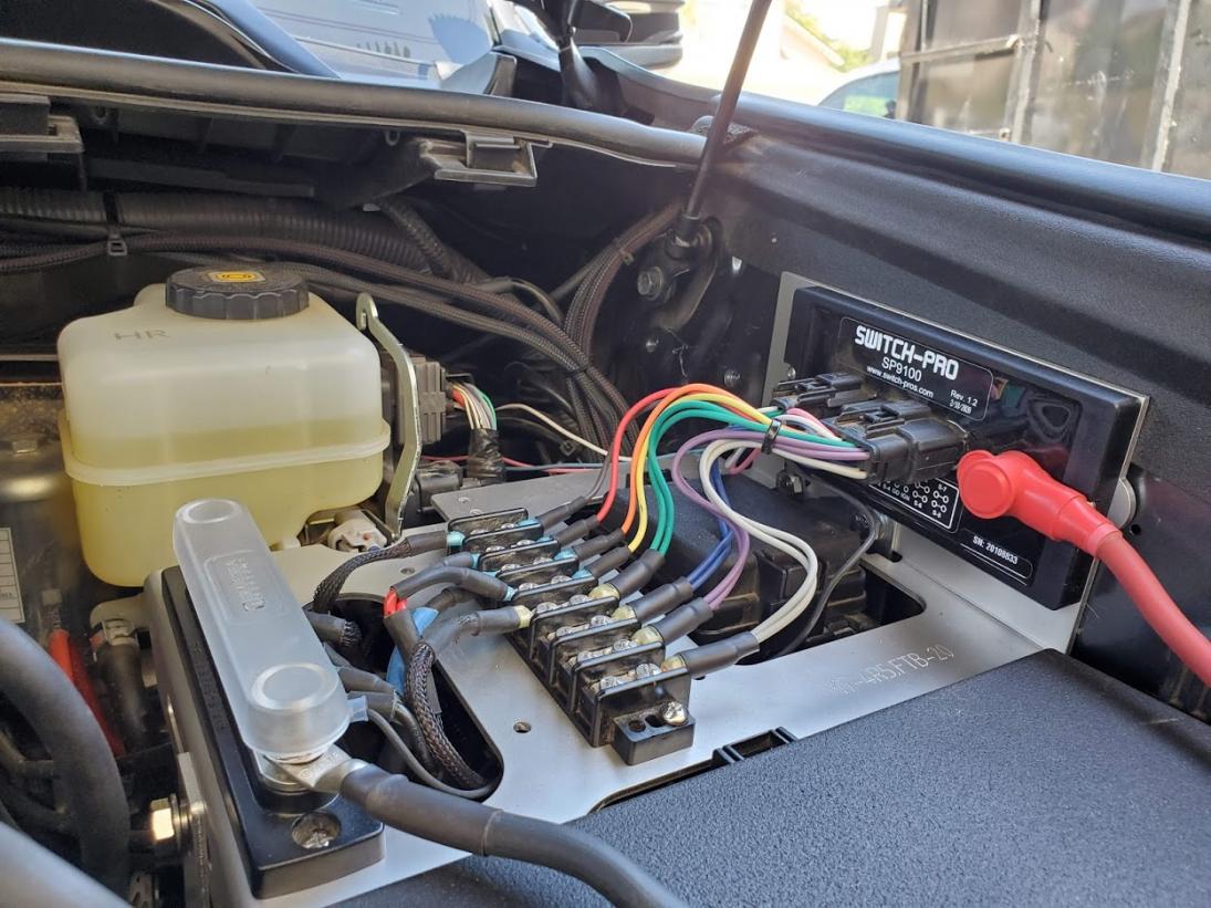

On Instagram, sdoffroadmt posted today a picture of their 2020 5th Gen Mount Tray that vertically mounts the Switch-Pros Power Module per their installation requirements for warranty retention. sdoffroadmt shows the Terminal Block setup.

Just message Derek via IG or here on the forums (he posted right above you) to purchase. The photo he posted is of my install. I will be helping a buddy install one today and will take photos and a write up in a separate thread.
