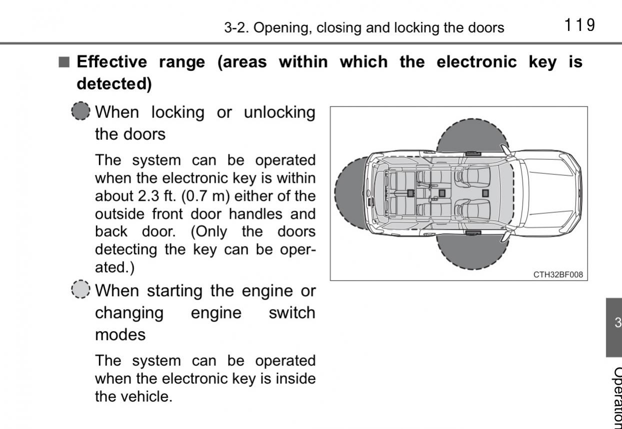

Post 8 page 119 in manual.
2.3 ft

That's not for button pushing the fob to unlock. The 2.3 ft is how close the fob needs to be in order to open the doors without pushing a button on the fob.
Now I'm curious as to the actual range. It seems strange to say, but I have not used the buttons on my fob once. I prefer just grabbing the door handle and unlocking/locking.

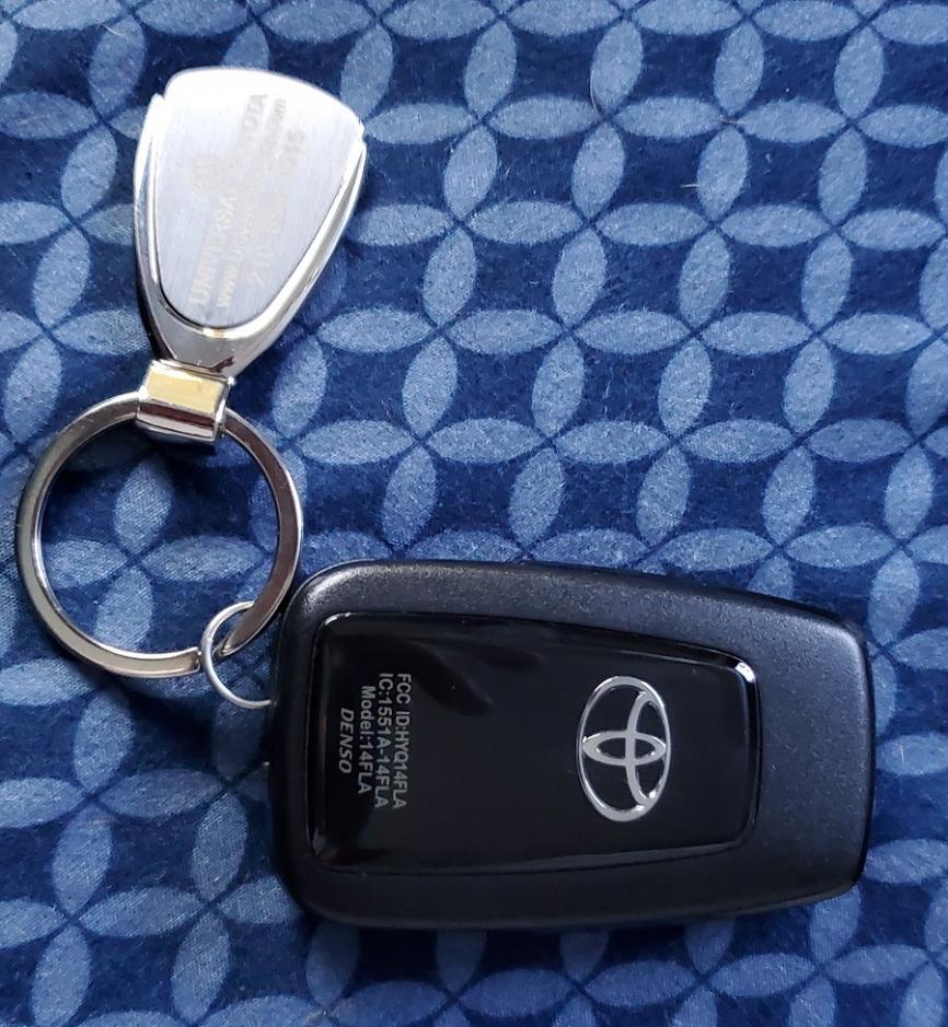

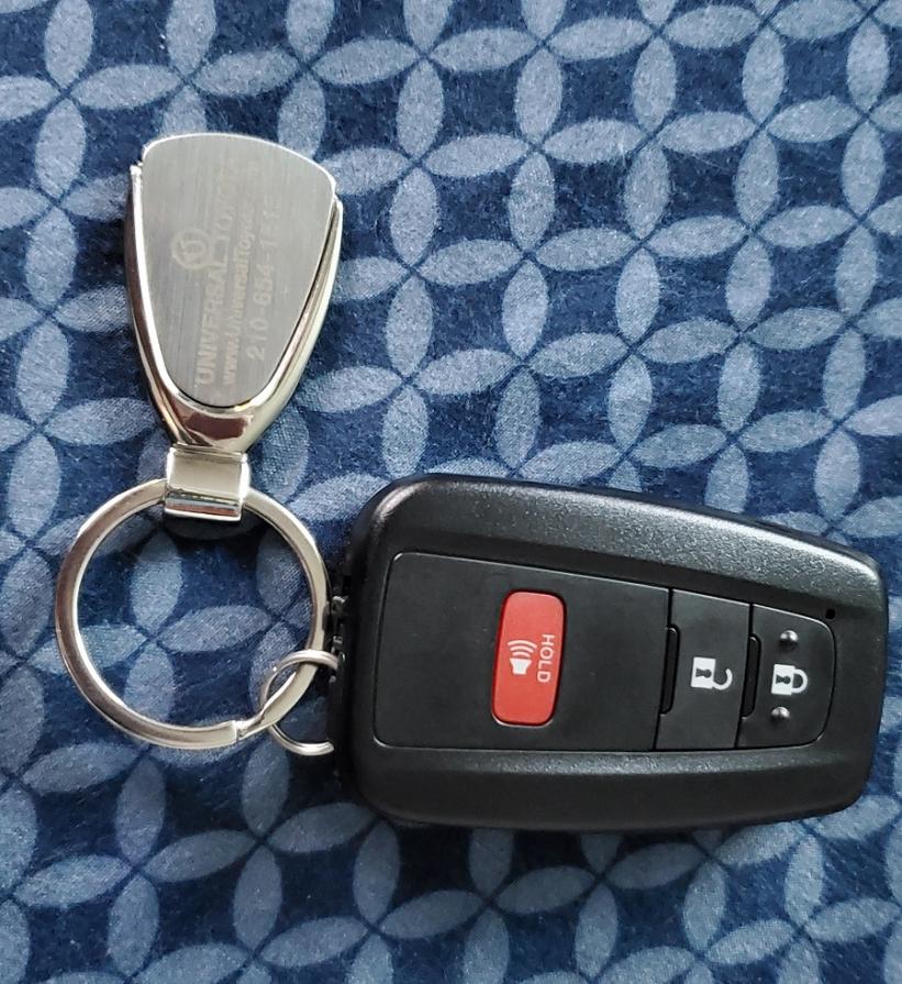

They changed key fobs for 2022's using the latest Prius's 14FLA fob.
Supposedly, according to dealer ,all trim levels of 22's have the smart key and push button start.
You are correct, I was mistaken…..
