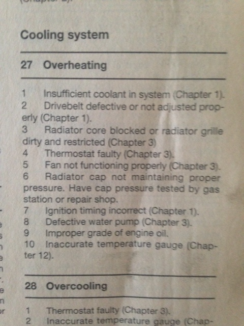

Morning guys,
89 Runner, 22Re rebuilt about 30K miles ago.
Noticed it running a little hot last week...checked coolant, which was low, so I added some and it immediately fixed the issue and went back down to normal.
Then yesterday it started running hot again, so I turned around, and drove it back home (about 1-2 miles). It started to dip into the red minutes before I was able to make it home and cut the engine. I added more coolant. This time, it didn't seem to fix the problem.
Then I realized that I had put 5w30 in it when I changed the oil about 3 weeks ago. :wtf: I should have used 10w40...maybe this is why it was running hot!? I drained out the oil (did not look weird or milky) and put in 10w40 yesterday. Started it and drove around the block to give it a test - I pulled up to my neighbors to help him move an AC unit...truck idling in street. When I came out, the coolant was leaking out and temp gauge running well into the red! I zipped back into my driveway two blocks away and cut the engine. The radiator hose was blowing hot air back into the coolant bin, so it was bubbling.
I let the engine cool for a couple hours. Then I drove it up to a reliable engine mechanic about a mile away who's worked on it in the past. Almost hit the red on the 4 min drive up there.
obviously, my guess is thermostat, or water pump. but My bigger concern is possible engine damage. It felt and sounded totally normal last night on the quick drive up to drop it off.
I know it's hard to say but wondering,
Have any of you had a 22RE get into the red briefly and been okay engine-wise?
thanks
Living in Florida mine has gotten up to the red a few times, mostly when im running on the highway in traffic without clean airflow and mine dont seem to care. I dont think Ive ever run it to the point of boiling but these are sturdy little motors that can take a lot. If you are concerned do a compression check or send off a coolant and oil sample for analysis. To fix it, Ive pulled every hose on the motor and pushed garden hose pressure through every orifice I could, then filled it up with plain water and a handfull of powdered laundry detergent. Trick I read about that can help remove deposits and "polish" the system. I then drained it and did a prestone flush kit through it and then I filled it with plain green sulfate free coolant. I also have removed my A/C so I dont have the condensor in front of my radiator either. Its been doing a lot better so far this summer.
depends on how hot it actually got... the factory gauges are less than useful for determining that unfortunately.... good luck hopefully you don't need a new headgasket!
BLEW A HEAD GASKET! Compression problems.
Going to need a new 22R-E.
