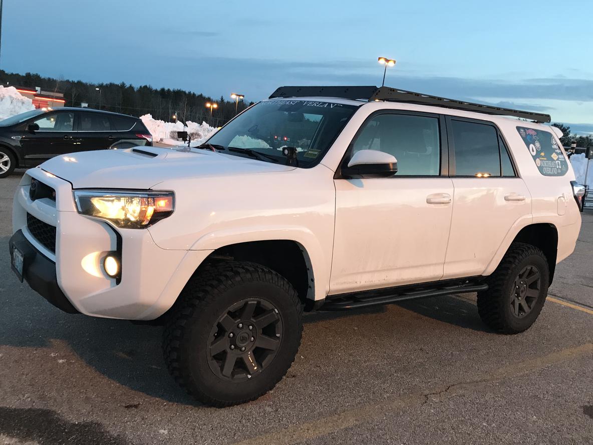

I’m running the 255/75R17 KMs from a stock rubicon. OME light kit and spidertrax.
Nice looking rig! The spacers help the look.

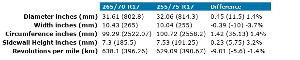

255's are roughly .45 inch taller from the curb; i think its invalid that wider tires provide better wheel protection from off roading.
I feel like most speedometers read 1.5 to 2 mph too fast; so this taller tire will keep things more accurate at the speedo. This also means you'll accumulate fewer miles on our 4runners thus helping resale value.
Then again, these changes are so small that no1 would even notice any changes except in vehicles handlig behavior

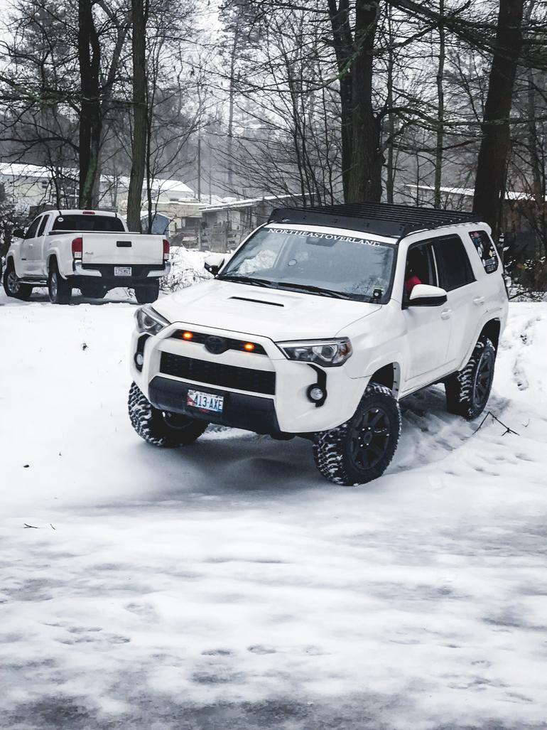

Thanks. Added sliders a week ago and it rounded out the overall look! Almost time to start using the new additions, can’t wait.
At least you get better options if you’re not interesting in just E range tires. I off road but I don’t crawl rock and really don’t need the overkill E range so I see this option opens some doors with that.

Thanks for posting this. The chart really puts it into perspective. Maybe it’s just the pictures that were throwing my eyes then because the difference is pretty marginal.
