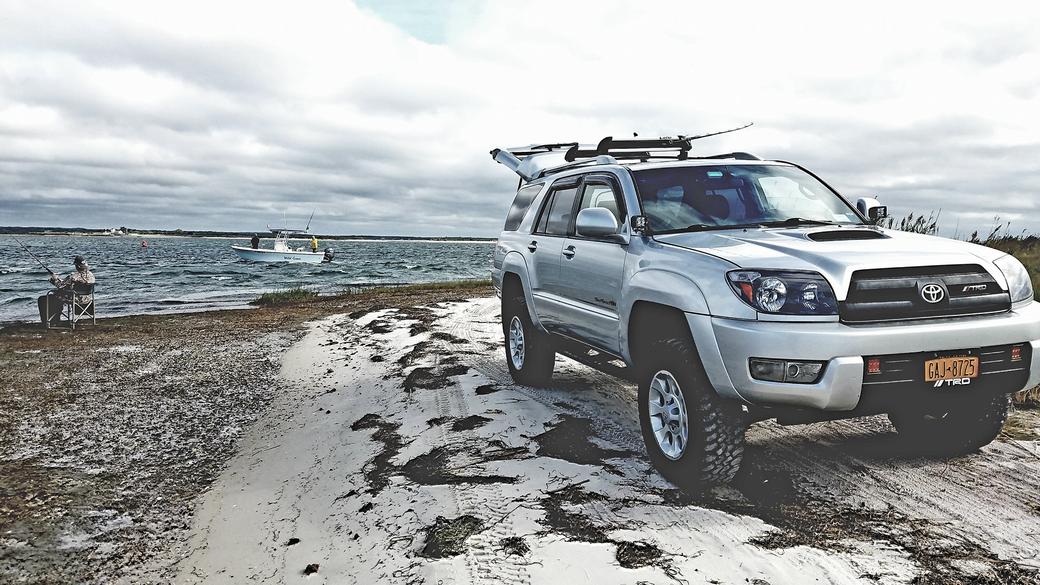

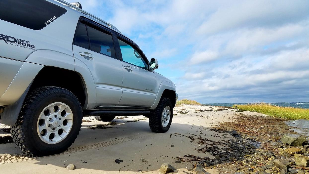

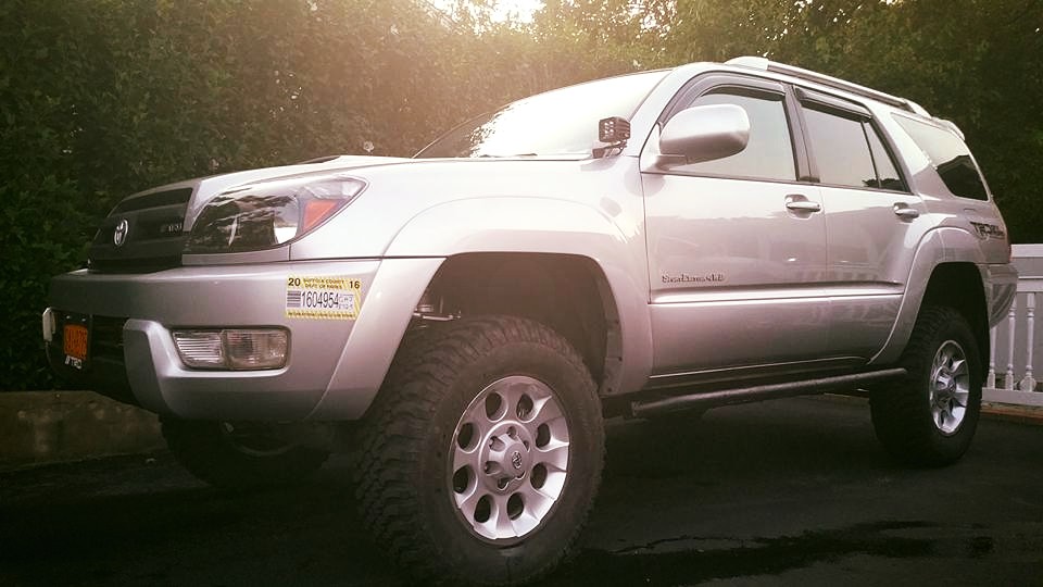

I have the 5th gen trail wheels with 255/75/17 km mud's off a jeep rubicon, No wheel spacers,
were brand new when I got them.. usually can be had cheap from guys lifting there jeeps.
put about 20k on them so far.. planning to upgrade this spring to 255/80 or 285/70.. haven't made that decision yet..
*Rubbed front mudflaps so they were removed..
*full lock in reverse just barely touches inner front fender well on the bottom edge.. will be trimmed
