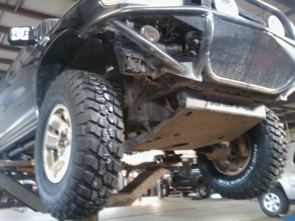

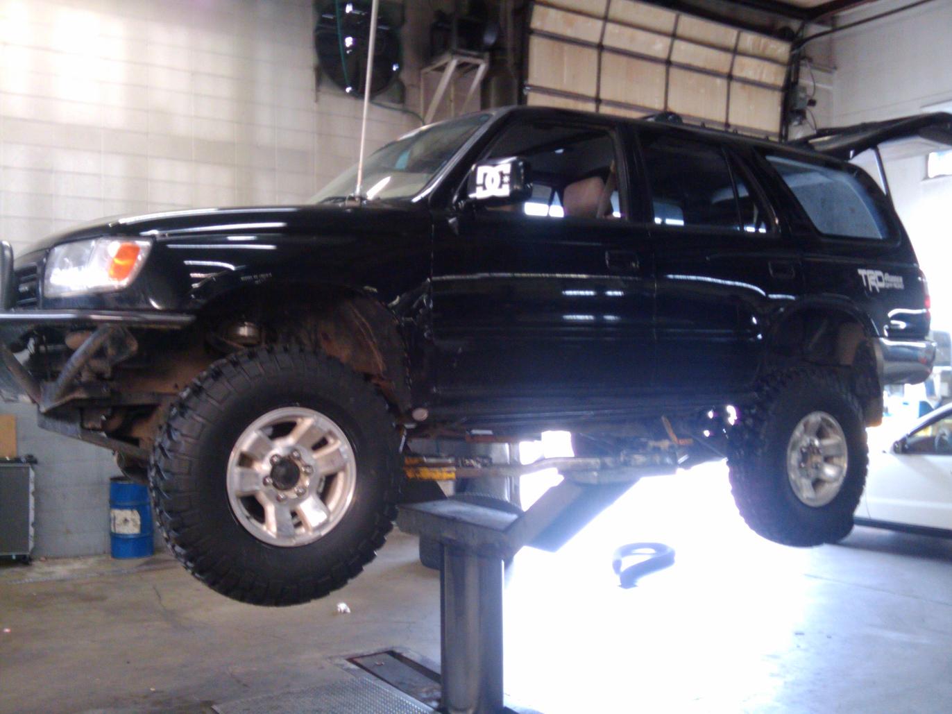

today was a big day for me...
i already had the lift, toytec 3inch spacers with landcruiser fj80 coils in the rear...
but i got the km2 255's!!
so far im in love. they are freaking sick, fit my runner perfect SR5 with the flares taken off, no rubbing up front but i do in the rear, i rub on the mud flaps so im going to trim the bumper to fix this, but this was at full flex, not your flex that someone with 35's stuffed would even attempt. In a huge ditch with the locker on, and also on a flex ramp at a local 4x4 shop. i still dont belive those guys claiming they dont rub with those 35's i could see myself rubbing like crazy with the 285's! these tires fit perfectly in the wheel wells at full flex, i extended my bump stops with 2.5in square tube with holes drilled in it. worked beautifully.
im going wheeling tomorrow morning and will get some better pictures.

i got mine from my buddies fj80, and you will need new rear shocks, i just replaced mine, but had the stock ones on for a few months it was a rough ride because they were maxed out sitting on level ground. and the spacers off of toyteclifts.com
