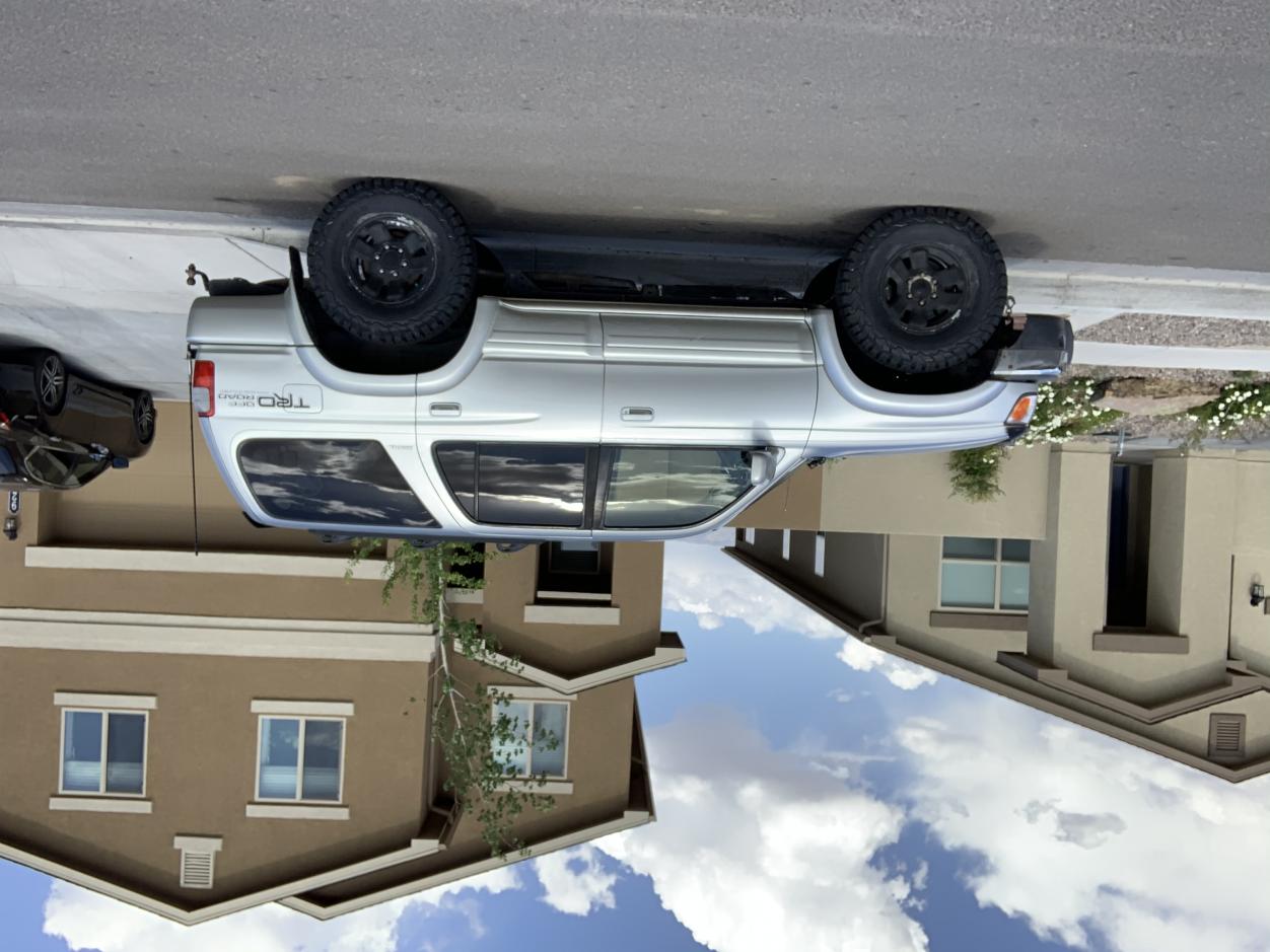

Sorry to drag up an old thread, but I felt it was better than creating another one. Is anyone run 255/85R16s on the factory rims? If so, how much lift is needed? Can I get by with 2” using the narrower tires?
I wanted this size so, so, so, so badly.
The time came to get new tires (just last month), and I just couldn’t justify getting a MT. Ended up going with 285/75/16, sadly. They’re okay...
I mounted mine on stock 99 rims. I have a 2” body lift also. I’m also running 1.5” wheel spacers, but that is to partially counter body roll from the lift.
255/85r16 DC extreme country’s.
~3” lift all around, maybe more like 3.75” in back. All in the suspension, no body lift. Did some firewall smacks for the front wheel wells, but nothing crazy. Had spacers initially to clear the stock upper control arms. Eventually put SPC uppers on and removed the spacers.
Rubs frame lightly at full lock and if wheels are turned and compressed 75% or more they rub the firewall.
Awesome clearance and road manners, I love this tire size and combo, been running it for 4 or 5 years.
As the fronts wear out I replace with new.
