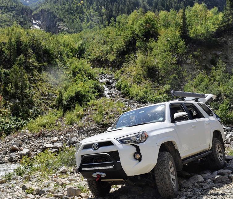

I went with the Duratrac's 255/75/17's and very happy. I Overland on trails in Colorado ranging from dirt to 4+ trails and they grip well with little to no slippage. They are a true 32" tire and weigh the same as the stock Dunlops, just a hair thinner, so the mpg actually increased on the highway to 21+ until I added bumper/lift but still average 19 - 19.5 mpg as a daily driver with the extra weight. Just my 2-cents...
The (maybe) good thing about the duratrac 255/75s is that they are p-rated. So they should be about the same weight as the stock tires, give you about stock mileage and do better offroad. Win all around, as long as the sidewalls hold up.
