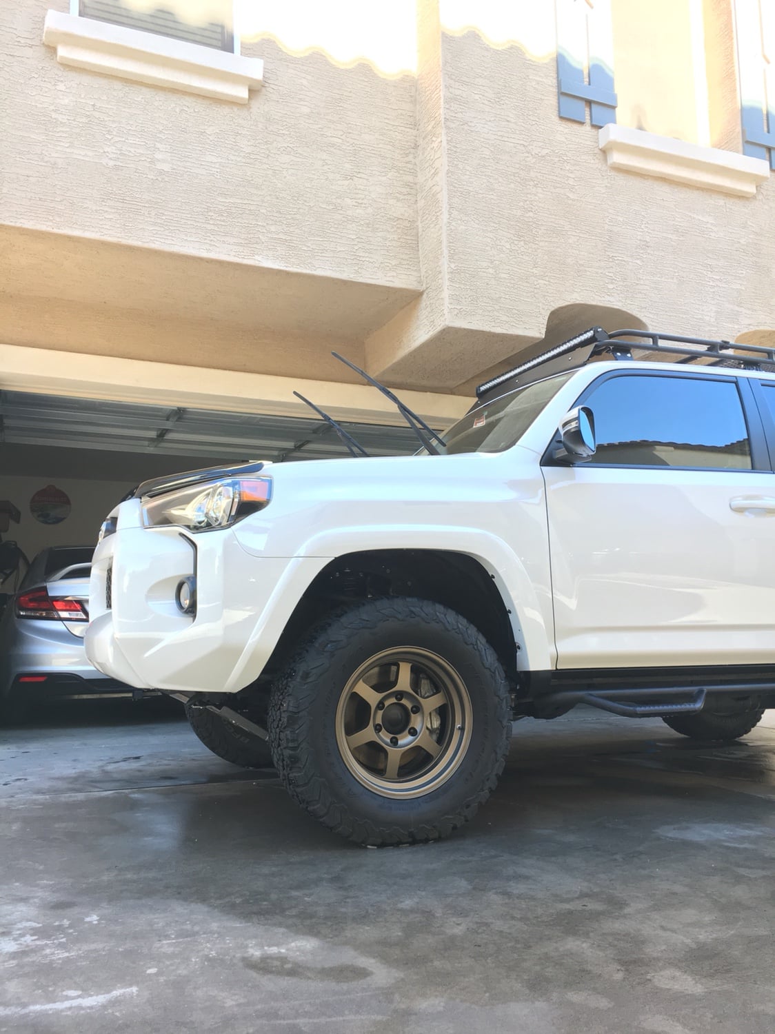

If you buy the right WIDE, LOW offset wheels, you can rock 265’s and they won’t look too small. My 265’s look great when they’re dirty, but when they’re cleaned and shined they look a tad too small (I don’t shine them anymore)
IF this weren’t my wife’s DD/our family trip hauler I would have gone 275’s or 285’s. c load 265’s are 10lbs lighter than 275’s

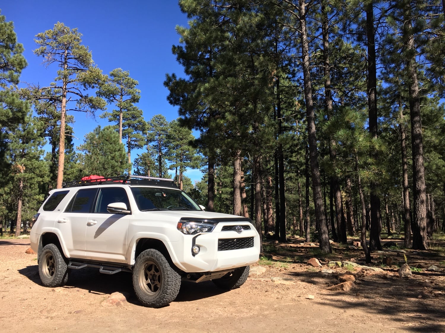

By the way, I get rubbing with 255/75 and -10 offset. I removed the front mud flaps and will be trimming the front liner. Let me know if you have any further questions.
Attached is a picture of the 255s with a lift.

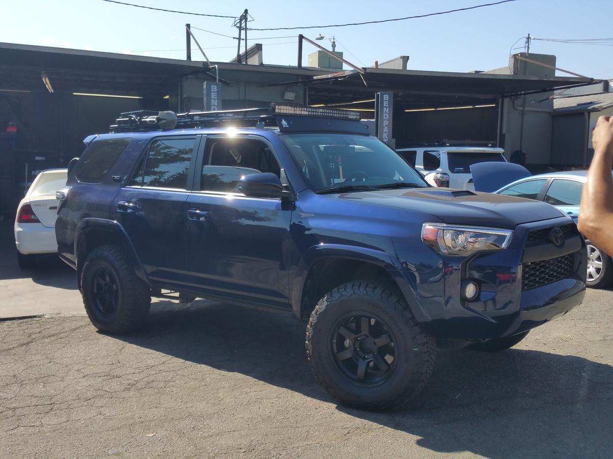

Been running 255/75/17 KM2's for about 10k miles now with 1.25" spidertrax, Bilsteins set at 2.5 up front and OME 895 2" coils in the rear. Had a tiny bit of rubbing up front (fixed with a heat gun and some pushing).
I've done quite a bit of wheeling with them, everything from rocky trails in Colorado to muddy backroads in Arkansas. I will say they perform great on and offroad. I seem to be averaging about 17.5 MPG, but thats probably not acurate. I can definitely tell the difference in sound after 10k miles, they have gotten a lot louder, which is to be expected with any MT.
I'll probably end up going the 255/80 route after this set just to get that extra inch of height, and most likely switch to the ST MAXX.
