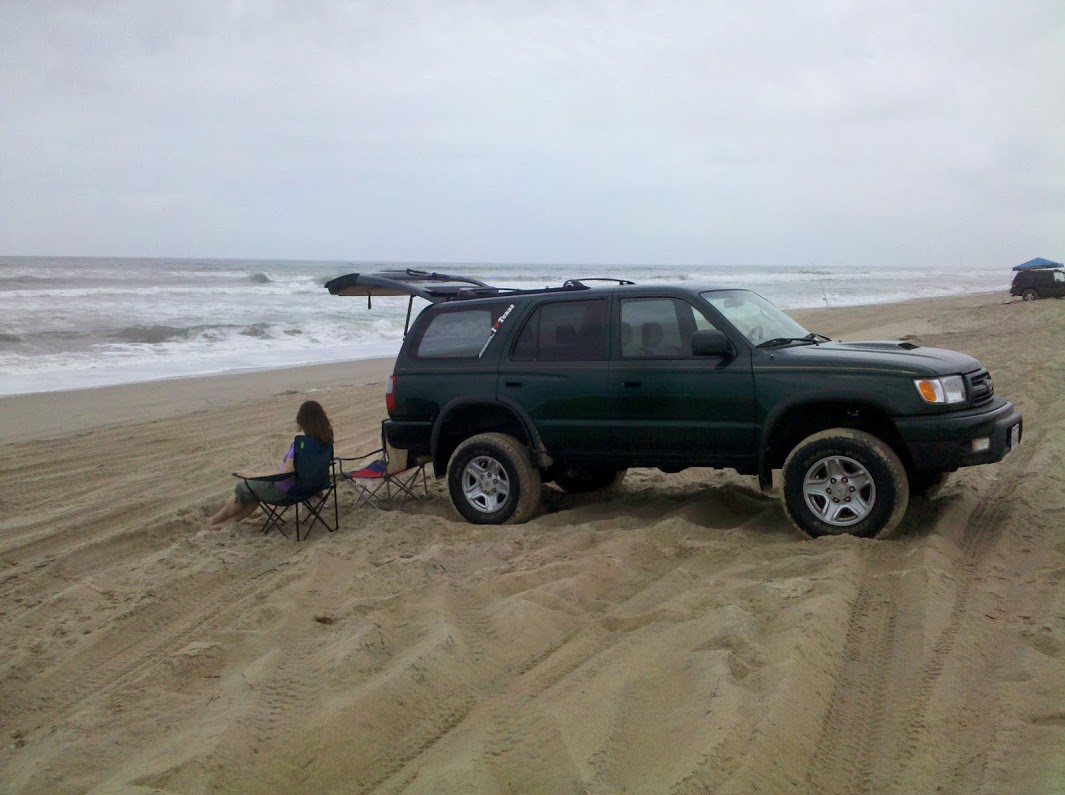

Here's a 1999 on LC 7 Wraps with Tundra TRD Front Springs and a Toytec 3/4 Top Spacer. Total lift was about 3.5 inches in rear, and 3 in the front. Stock 265/70/16's.

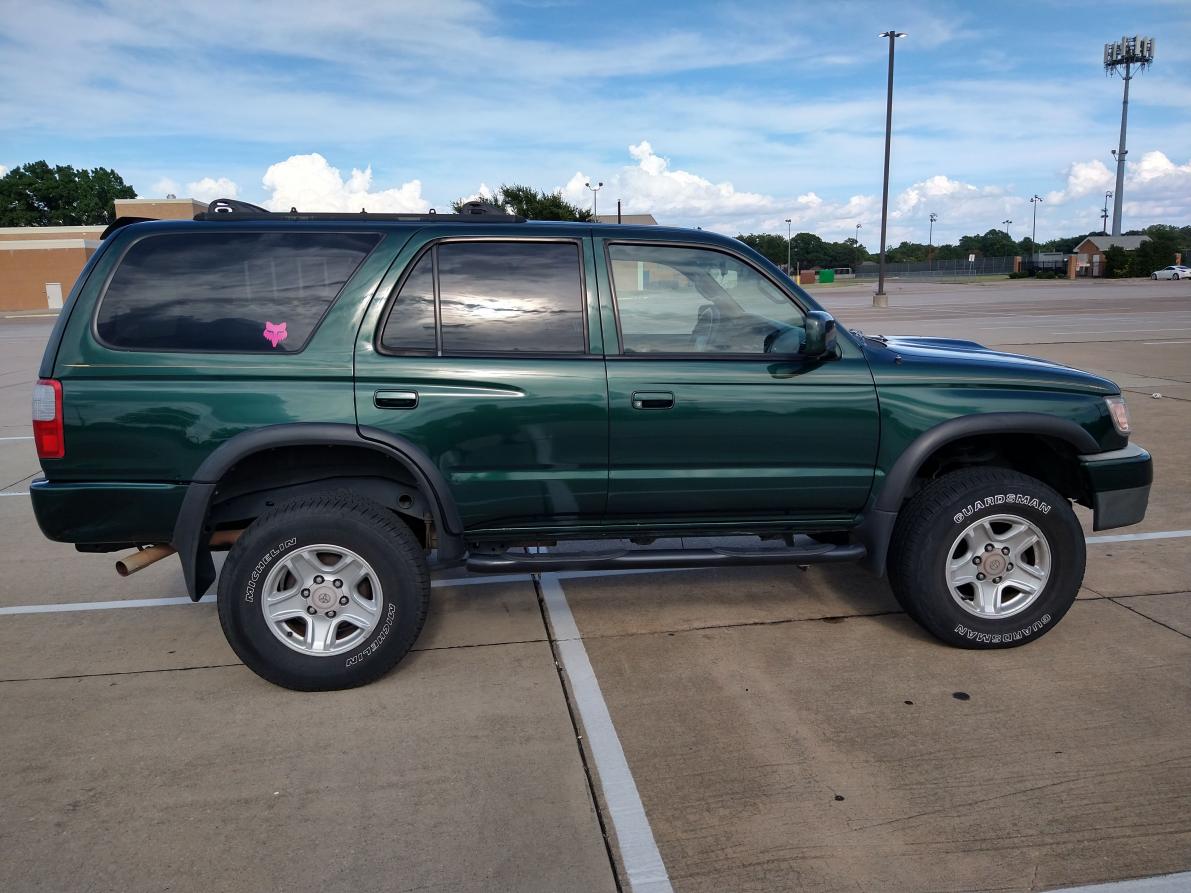

2nd Picture on the Street in a 1.5 Daystar Rear Spacer on 99 Talls and the 3/4 Top Plate Spacer in the front. Total lift about 1.5 inches.
This looks great! I wan to do the same. What leveling kit do you have?
I'd like to know the same. I like that look.
I had a lot of driveline issues with the 3" Toytec lift so I'm really contemplating keeping it much more mellow on this one.
But dang....it sure looked good...
