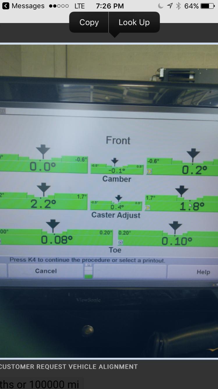

I mounted some Falken Wildpeaks to 2017 17" 4runner wheels and had them road for balanced and have had nothing but trouble. I'm running 36psi and it feels like the truck is being blown around on the highway like its windy out when there's no wind. It's particularly noticeable between 55-75mph. I have new Bilstein 5100s front and back on stock springs, new upper and lower ball joints, new inner and outer tie rods and an alignment. The rear has stock springs with the daystar 1.5" lift. Nothing else seems worn. Any ideas? I'm really getting frustrated at this point with these tires!
