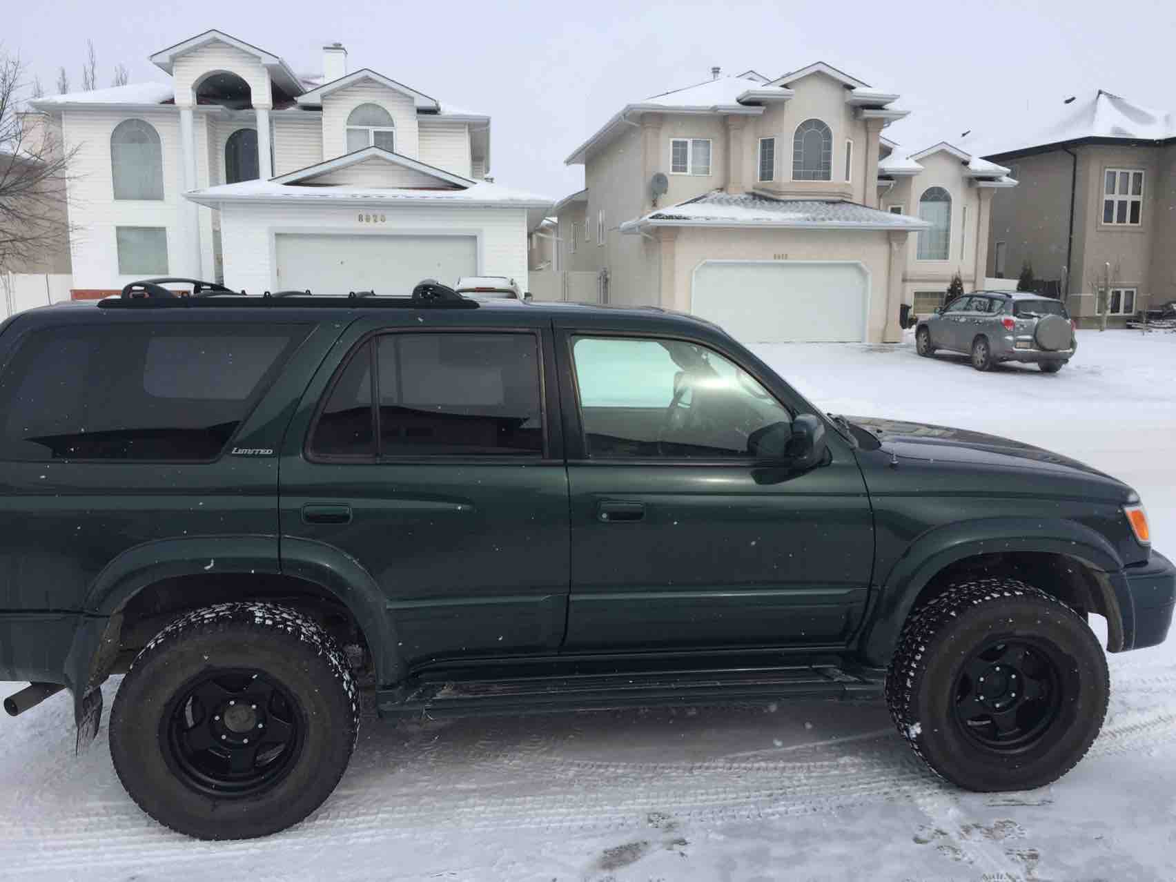

Picture of the vehicle
Here's a picture of the '02, with the 265/70R16s. I'll share another when I get the new ones installed.

Thanks. I did end up getting the BFG 265/75R16s last night. Picking it up today. I bought a new spare too, and the guy at Belle Tire looked at me like he thought it was nuts spending all that on tires for a 20 year old truck. LOL But he didn't realize the work I've done to it and how clean it is (only 115K). I DO like the idea of the 5 tire rotation, and they rotate them twice a year for you for free. So that's the plan. It's my daily driver now but working from home I'm only putting 3-4K a year on it driving up north occasionally.
Is that a '97 Desert Dune SR5 with the stock black flares? That was my first 4Runner. I put 250K on it and sold it in '06 to a guy who was going to ship it to Syria (where I'm sure it is still chugging away). Should have kept it.
‘96, but yeah. Bought it with 230k and Just turned over 250k on it this spring. Head gasket failed into cyl 3, newer 30k (such a score) motor goes in this weekend. Body/frame is in fantastic shape, this motors gonna put it past 400k for sure.
Wild someone picked yours up with that many miles in 06 to ship it across an ocean!
