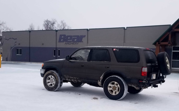

Now, I am building my 96 to be my overlanding rig. I currently have a custom rear bumper with swingout tire and am just now starting on my sliders and front bumper. I'm also trying to decide what i'm going to do with my suspension (I believe it's the factory suspension with 220k miles) and can't decide if I want to lift it or bring it back to stock ride height. My concern is that some of the local trails that I go to quite often tend to get tight for my 4runner without a lift. What would you do?

Thank you for the great explanation! I have loaded it down and it sags tremendously (it already sags as it is which is why I'm considering the lift). In the picture above, it has a set of 265/75r16's on it but they're worn out. Has anybody lifted just the back to give it a small rake when not loaded which would then level it out when loaded?
Okay, it sounds like the suspension needs to be addressed no matter what. No problem. I don't claim to have all the answers by any means, but if I were fo build again, I should pick one of two different paths.
