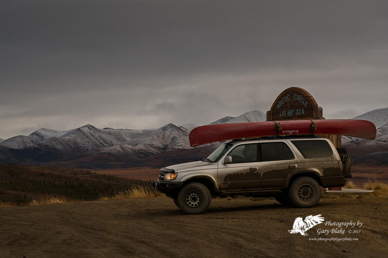

Currently running 3" Lift with Michelin LTX M+S 2, 265/75R16 light truck rated for the stronger sidewalls. You really need to build based on intended usage - overland usage generally means long stretches on the highway to get to places where you want to "overland". I picked these tires because they are tough enough to take a pounding on extended sharp gravel roads and won't kill your gas mileage. 3" lift and bumpers with better entry/exit angles for crossing the inevitable wash outs on exploratory side trips. Toytec lift will be going soon because it just didn't last and with the weight I am carrying I will be going with 2.5" body shocks (Icon) and heavier springs.
Photo taken on the Dempster Highway, Yukon Territory, on an 8 week 13,000 mile "overlanding" trip last year. (You can see the rear end is sagging quite a bit with probably only 3-400 lbs of gear)

Thank you everybody for your input. Unfortunately, I had to go ahead and do the bumper because the original bumper was completely rusted out and I need a receiver in order to use my bike rack. My buddy and I built it so I ended up with approximately $200 invested in it after everything was said and done. The swingout was a last minute addon which turned out great! But, it's causing the sag issues and I've put fixing it off too long.
I think i have a gameplan figured out though. I'm going to go ahead and throw the OME 891 springs on the rear to fix the sag. I know this is going to give me approximately 2.5" of lift and will give me a slight rake when unloaded. Once I get my front bumper and sliders built (starting on them next week), I will do the front to match.
