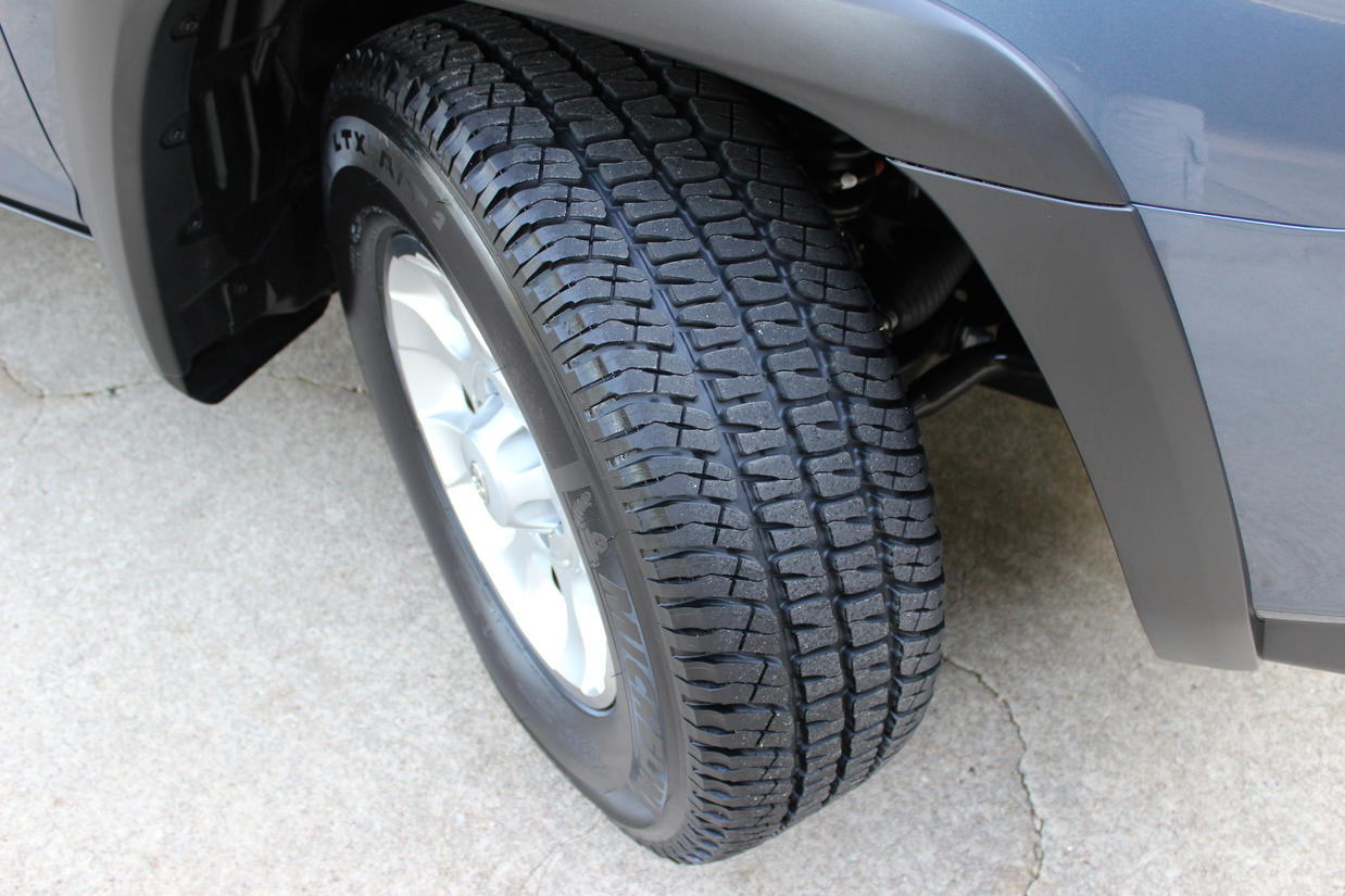

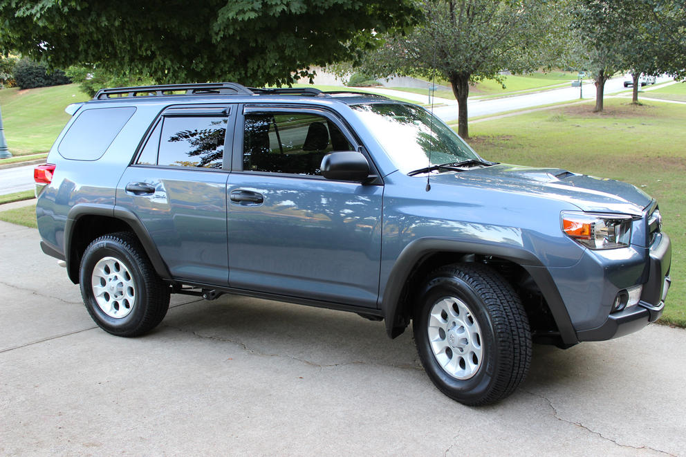

Well it's been 6 weeks since I brought home my '12 Trail and counting the original Bridgestones it has had 4 different tires on it! I started with the Cooper AT3's P rated - stock size - nice tires - if they would have balanced correctly I would have kept them. Had them rebalanced three times - twice by the tire store where I bought them and once from my local dealer. All times I had highway vibrations that annoyed me to no end for a new vehicle.
I then decided under my 30 day satisfaction guarantee to switch to the Michelin MS2 P rated stock size. As we sometimes do in life this was an over reaction. They are very smooth tires but I knew I would be limited in my off road adventures so I swaped them out for hopefully my final set.
Yesterday I had the 265 Michelin AT2's installed, LT - E Rated. I was close to getting the same tire in 285 D rated but I just didn't want to deal with any rubbing issues, slower acceleration/braking and mpg loss due to the heavier tire weight. The stock Bridgestones are 40lbs, my LT 265's are 48 lbs and the 285's would have been 55 lbs. I do think that the 285's would probuably look better but this time my practical side won. I likely will be 98% road travel so I wanted to optomize for that and not the 2% offraod. I don't plan on a lift anytime soon, and these E rated LT tires should allow me to off road with confidence - at least to anywhere a stock Trail can go!
So far performance wise on the street I can definitly say that LT E rated tires are much better than any of the P rated tires I tried. No more floaty feeling or hesitation with curves and corners. You do feel the bumps a little more but nothing bad, the better performance greatly outweighs any negative issues.
I must say I have learned a lot and I am grateful that tire companies provide satisfaction guarantees!
One last suggestion to those Trail owners with vibration issues at highway speeds. Both of the Michelin tires have had no vibration issues - so maybe it's the tires? I would also suggest that you insist on the raod force balance - with the Haweka adaptor and a low taper balacer cone. This helps to make certain that the road force balance is working with a stable tire. I also had a different Hunter road force balancer used for my AT2 install. It was the "Hammerhead" model and the tire store manager said it was the newest technology. It uses a solid metal cone that is matched exactly to the size of your inner wheel hub. I asked to watch the install and the cone used had very little taper and fit very tight. They then secure it on the front of the wheel and place it in the balancer. All I can say is the results were perfect - highway speeds up to 80 were smooth. These Michelin AT2's are a nice compromise if you want an AT tire that will be more on road than off road!
