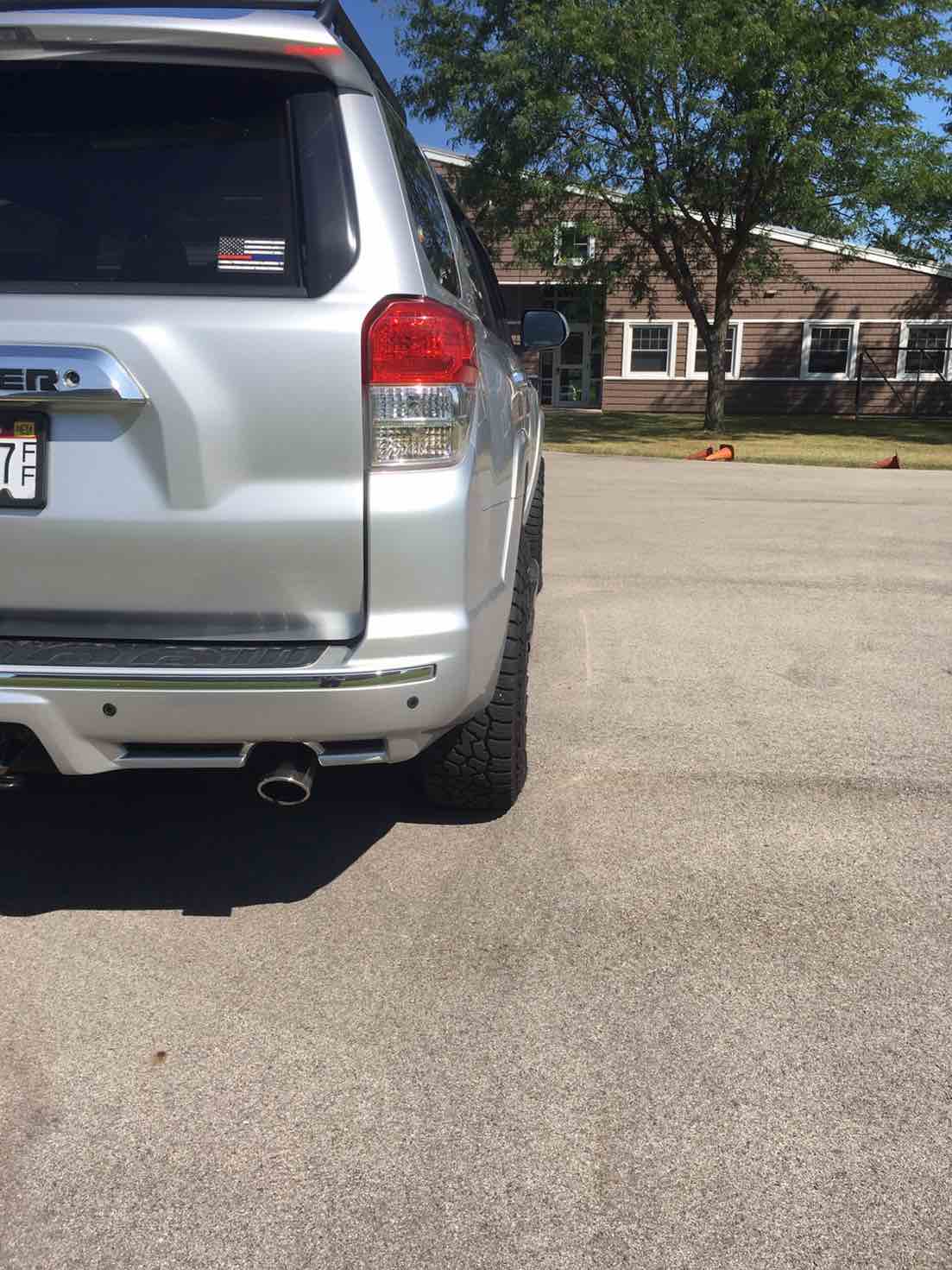

Truck is stock, no lift, no level...it's the wife's family hauler..instead of going 285 and having to trim stuff out as I've read, anyone stick with the 265's and add the spider trax 1.5" spacers ?
I want to get a more aggressive tire but they are still going to be tucked way inside the fender and I just hate that look..
Thinking of the falken wildpeak at3w, have a nice look and great reviews.
Any one with pics or inputs?
look in the lift and tire thread, there are plenty of users running stock size and spacers. IMO it is not a very noticeable difference, unless you plan on upping tire size. but the tires will sit flush with the fender. Also take note, some users have complained about rubbing with stock size after installing spacers and no lift.
