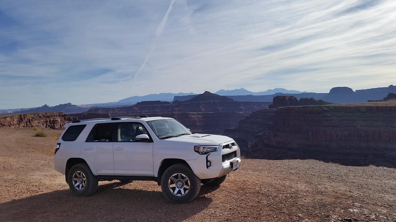

It'll look a whole lot like this. I have just a tiny bit of rub at full lock. I had a small fender bender (not my fault) and had the front bumper cover replaced so I haven't cut the new one yet. Otherwise it's good to go. I'll do a trim soon.

That looks great!
What is your details? That's actually exactly what I'm looking to end up with!:reddance:

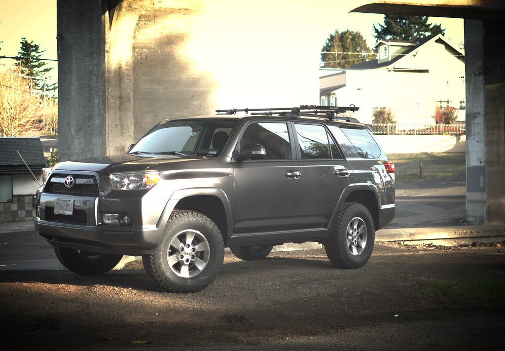

I'm at approx. 1.75" of lift with 285's. The Kuhmo tires I have are slightly smaller diameter than some other mfg's 285's, but only fractionally. I did the fender liner mod and have no rubbing at full lock and compression. Only tires I've read that have had some rubbing are the Duractracts due to their sidewall tread, but with the fender liner mod and correct alignment specs you shouldn't have a problem.....

"2010riddle" Nice truck! did you lift the rear also?
That looks great!
Thanks.
I've got Fox coilovers up front and a rear 1.5" daystar spring spacer with Fox 2" rear extended travel shocks. Visually pretty much any adjustable coilover should be able to net you a 1.5" front lift. I personally like the slight rake it had OEM because I use it to haul stuff and tow a trailer fairly frequently. I'm not a fan of spacers, so I'd like to swap in different rear coils, but this was a quick fix when I punctured an air spring and I haven't gotten back to fixing it. I was worried about running stock height on longer rear shocks. I don't know if I'd bottom them out or not. So I tossed in the spacers.
