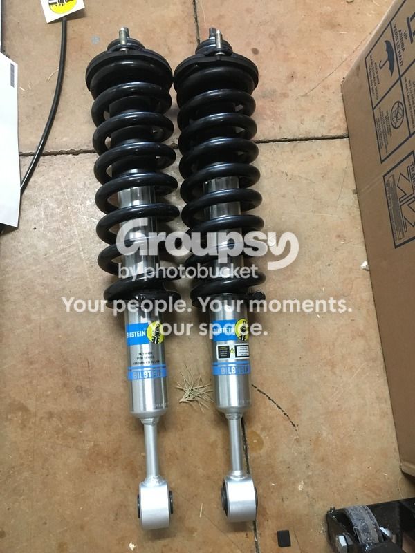

Well finally got around to doing the Bilsteins this morning. Here's a few pictures of the struts. It's raining today so no installing them on the runner. These were some SR5 struts I found on C/L so I could have them ready just to swap out.

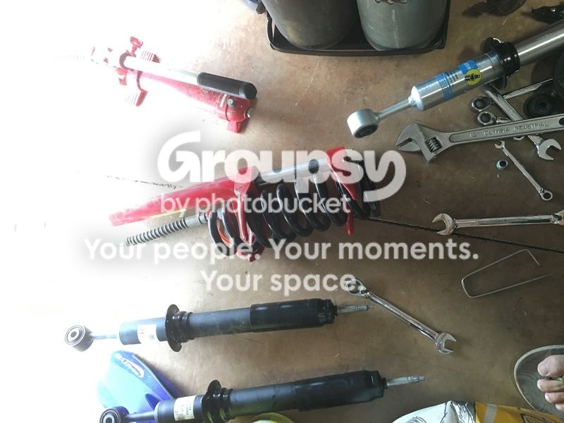

The swap went fairly easy since I have a hydraulic compressor:
IMG_0550.jpg~original
Took me about 20 min.

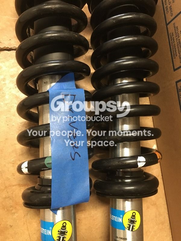

Something to take note of is that the springs seem to have a color coding? Whte and orange is on your passenger side, and white and green is on the drivers side.
