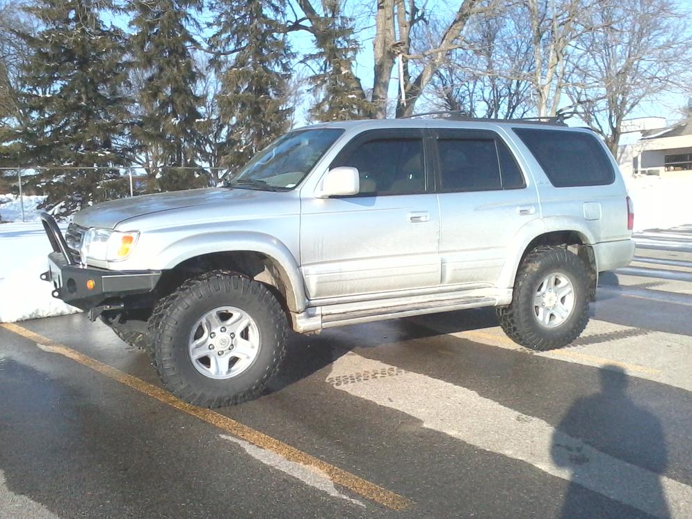

I just got a set of 285/75/16 Kelly Safari TSR's on my 2000 4Runner limited. I have them mounted on stock 5 spoke rims without any spacers. They do not rub the upper A-arm. The shop told me that they did not hit the frame at full turn in either direction. I have not noticed any issues under normal daily driving since I got them a few days ago. I have not had a chance to flex the 4Runner out, but I suspect they will rub the pinch weld and maybe other places. I have Tundra TRD coils/adj. Tundra Bilsteins in front along with OME coils in the back. I have about 2.75" of lift, but this would probably be 1.5" lift on other year of 4Runners. The Bilsteins are set on the lowest setting.

Not the best but here is a picture from my phone. :)

Update, as I was pulling into a parking space at work I believe the front drivers tire was rubbing on the frame. Haven't had a chance to check and see if it is in fact doing that and why the shop told me nothing was hitting at full turn.

Nice ride man!
