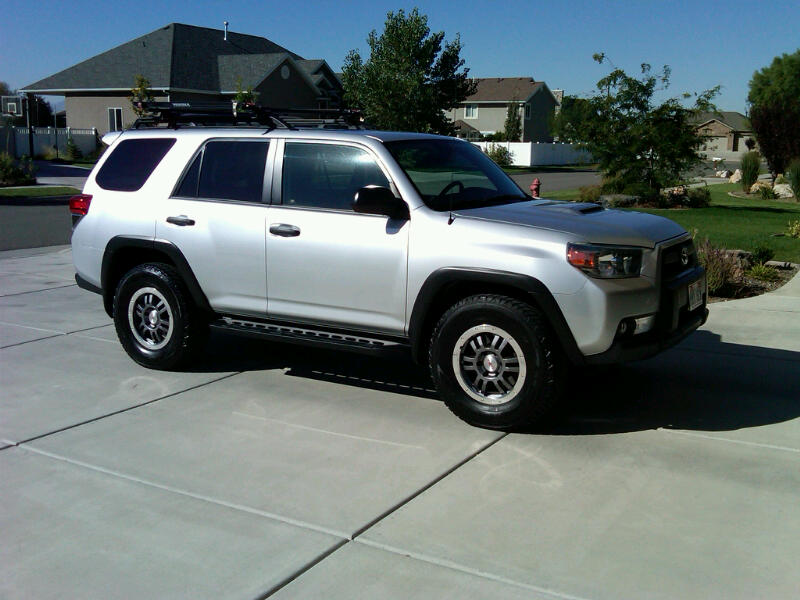

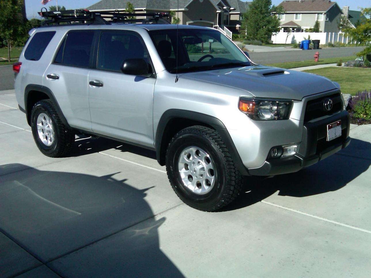

Just my $0.02. I'm pretty sure it'll look great either way (once you get rid of the Dunlops of course) so good luck. And, you asked for pics so here are 2 of my truck - one with the brand new 285s on the stock wheels and the second of the same tires (after 30k miles) on my new TRD wheels. For pics of stock size Duratracs on the same TRD wheels, check out some of 453030's pics in the links below:

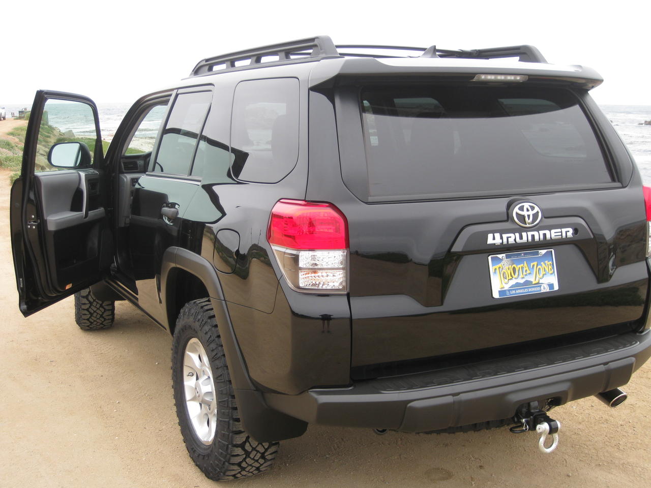

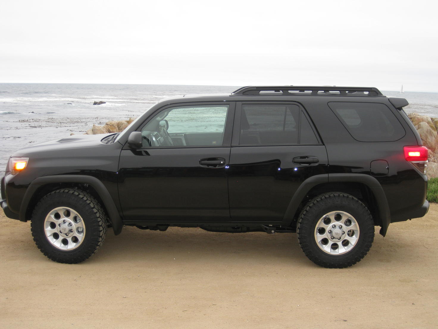

I was in a similar situation as you are a few months back. If you plan on a lift then I would definately go with 285's it just looks a lot meaner with bigger tires. Nothing worse then a lifted rig with small tires on it, just dosent look right IMO. I chose to go with the stock size Duratrac's. For me their PERFECT!! Aggressive look and feel and no need to upgrade you're suspension.
that looks great. C or E rated tires?
now if i could see 285s on stock wheels stock height!
