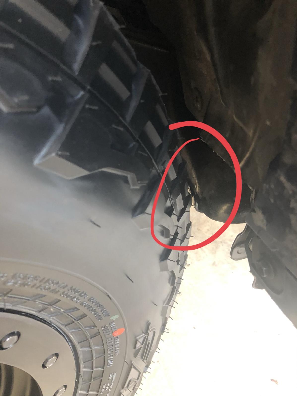

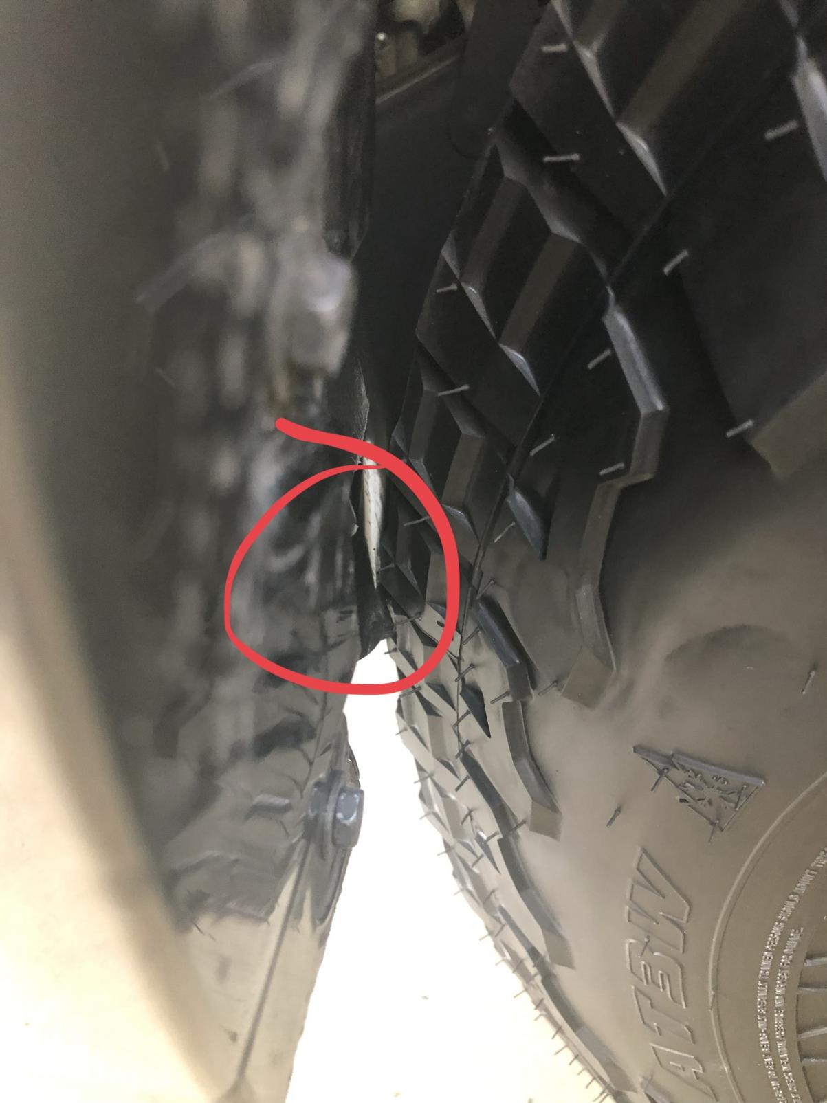

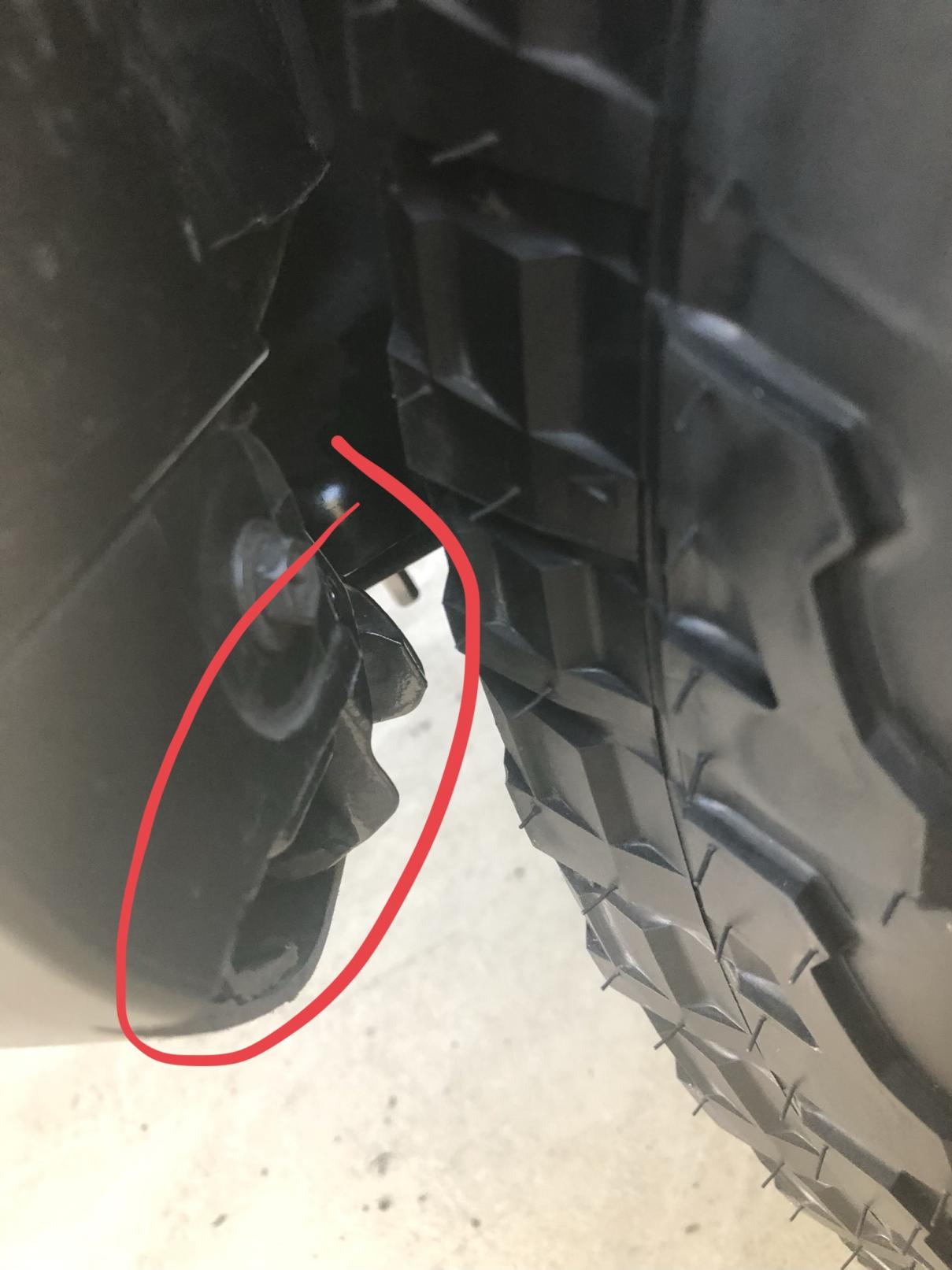

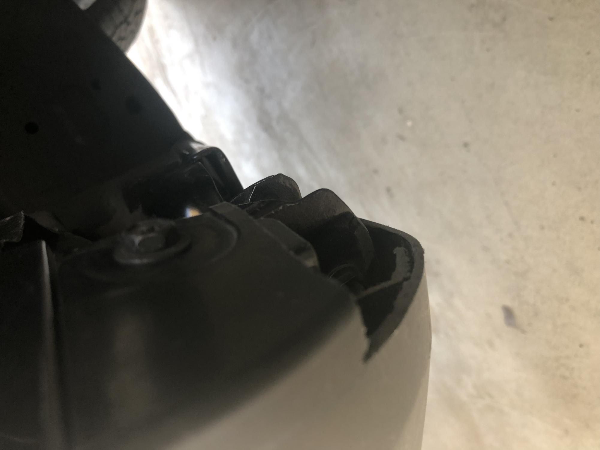

Couple updates...i cut both the mounting caps as they were rubbing a little, and just going to get the BMC done next week. I’m not going to mess with the caster and ride quality as everything with the 285 Wildpeaks is driving excellent. I took about 2 inches off the front fenders and liner and have plenty of clearance. I circled in red where I’m rubbing the body mounts.

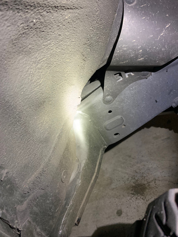

well this is what the 70 dollars at the truck stop buys you. It is a clean body mount chop as if it wasn't even there.
