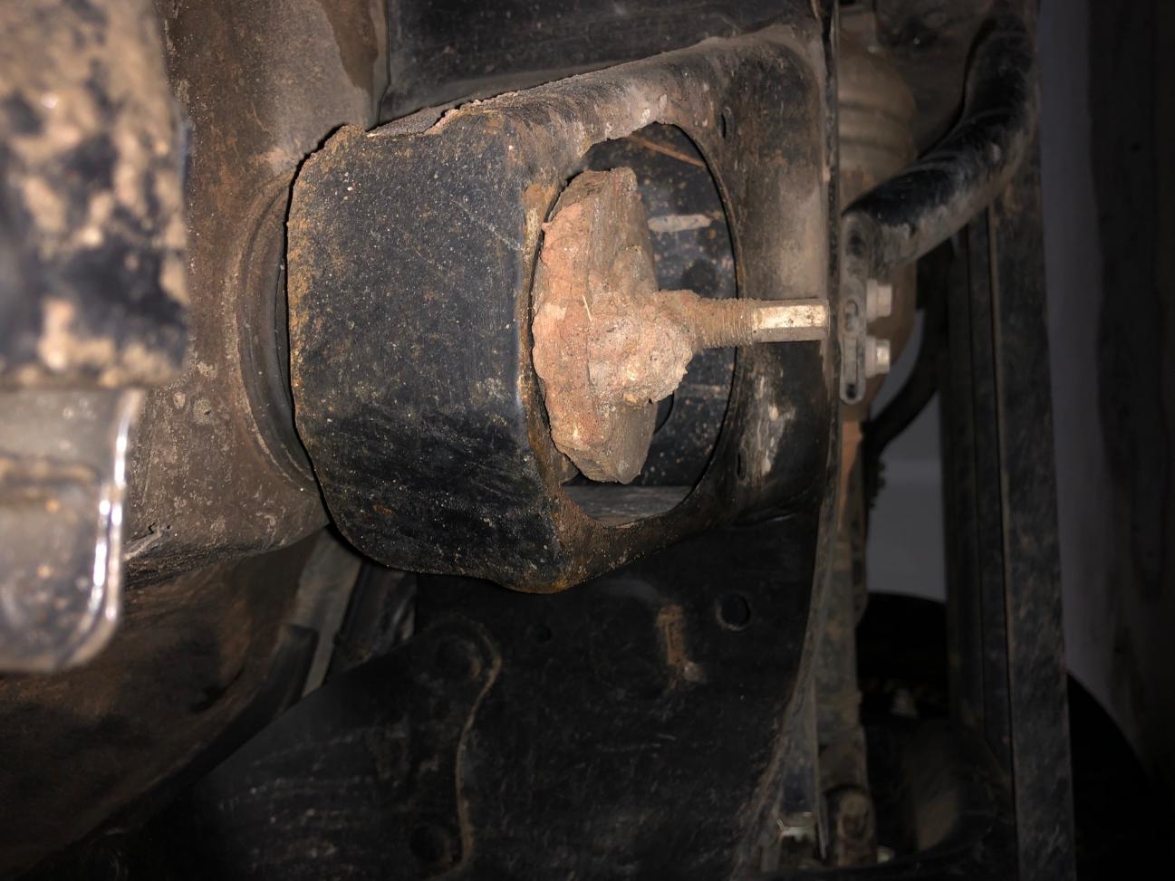

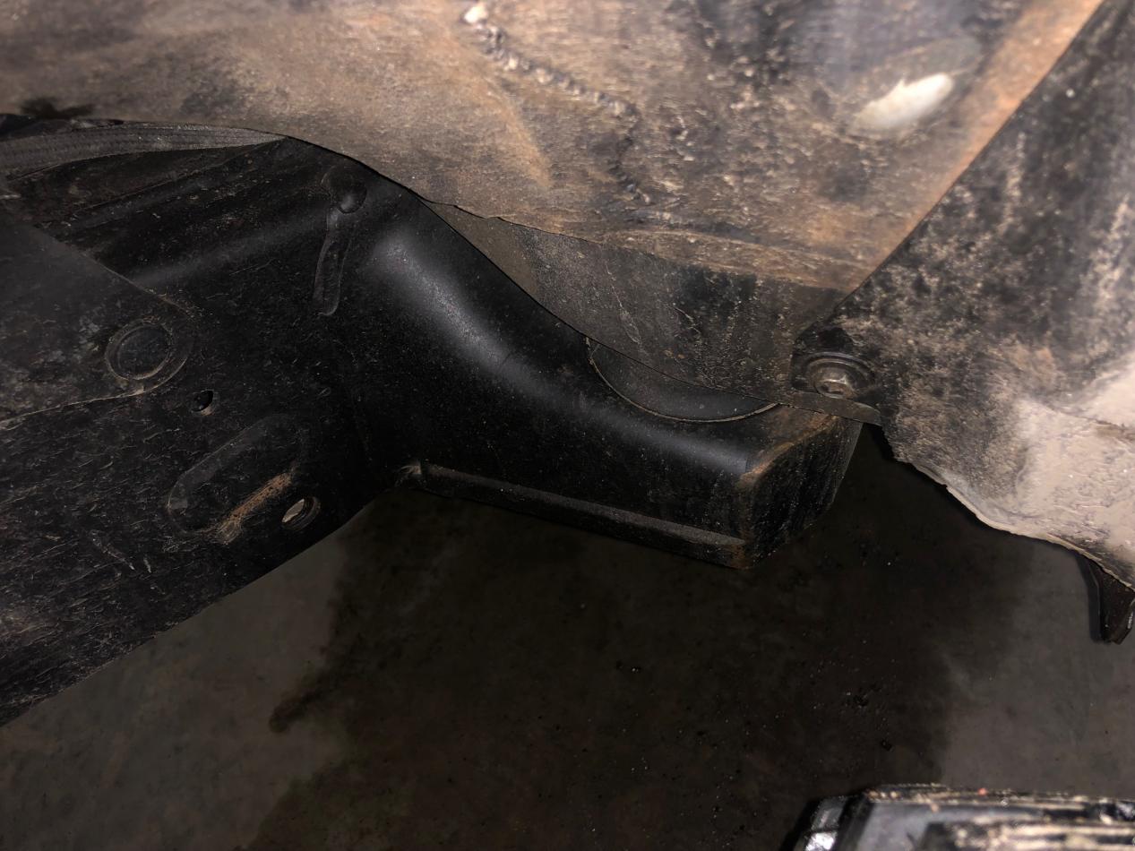

Metal Tech Plates
I went with the metal tech plates. Had a reputable shop in Bozeman, MT (Dark Horse Customs) do the BMC with placement of these plates for just under $200. Provides all the clearance you need and unless you know what you are looking for looks stock. Here are two photos. Don't mind the mud, been out with the rig in the snow/mud.

Ive got the 275s KO2s., and with spacers I still get rubbing with full turn in reverse. Even with the King suspension..Prior to the spacers, no rubbing. I'll probably do the BMC myself with a sawzall.

I’m getting chopped this week. I even trimmed off the worthless tabs that stick out by the fender coping. I’m still scratching my head at how poorly the mount cover plate is designed, and how unnecessary it is to stick that far out.

Just for information.....the mount is designed not for the actual Grommet, but as an extension made in high strength steel for an offset crash which causes wheel intrusion into the footwell area. The HSS also means there is no need for welding it up, it is beyond strong enough for the body mount itself!:phone:
Good information...which is why everyone just does the BMC, because it doesn’t impact the integrity of the structure.
