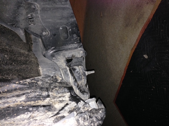

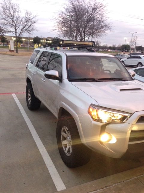

hey guys.. so i was looking to see if the 2015 4runner trail would be able to fit 295's and all i found was the answer no. decided to try it myself since its about one inch taller only than stock and about one inch wider. i did do the body mount chop, and trimmed some of the fender.. looks so badass in my opinion i love it. question is, i ordered a spacer lift kit from ebay for $140 front and rear. 3" in the front, 2" in the rear. its my dd, and i do offroad quite often. will i be able to just plug and play or do i need anything additional? if i go the bilstein route, front and rear, what exactly will i have to do? By the way, i have 1.25 inch wheel spacers front and back. let me know what yall think! :) loving the new look

Also, is the body mount chop done correctly? Did it myself haha..
I would put a filler panel in there to add strength. Looks a little flimsy with it just cut. Granted I am sure you will be fine.

The primary reason for dong a lift is to fit larger tires. Assuming you have full articulation without rubbing, why lift it?
I run a spacer kit. It's nice. A little thought. I am probably going to get 5100 bilsteins to help with that. I don't off-road at all really anymore. But my old runner did and the spacer lift was fine for 70k miles.
