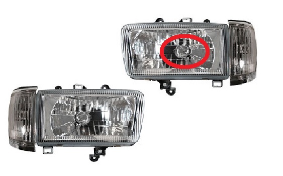

Thought I'd share a little insight on the composite headlights for the 92-95 4Runners.
I've seen a lot of posts where people have retrofit projectors into their housings. They work great, but I didn't want to have a small circle of light in a big rectangular housing. I also couldn't keep driving with the junk the truck came with.
I picked up a set of Depo Crystal Chrome Headlights that are direct replacements for European trucks. The optics and cutoffs are left hand drive with right hand traffic.
I also picked up a set of the GTR Lighting GEN 3 Ultra Series LED H4 Bulbs. They are definitely pricey, but well worth it! The LED chips on the bulbs almost perfectly emulate the filaments in a regular H4 halogen, and they output a ridiculous 1800 effective Lumens per bulb.
So... I can finally see everything, and I'm not blinding oncoming traffic!

The driver's was a little cloudy, and the passenger side had a broken mounting tab on the back on top. The spring is on the bottom causing it to always aim down.
There were a couple factors in changing them to something new rather than the OEM parts. The 9004 bulbs and parabolic reflectors are just old, crappy tech. The filaments are vertical in those bulbs, and very close to each other. The high beam filament is in focus in the dish, but the low beam is slightly out of focus, up and to the left. That makes the low beam pattern shine down and to the right. Light is scattered all over the place using this reflector whether on low or high beam, especially in combination with the fluted glass lens.
I knew if I wanted better light output I would need a more modern reflector design. I could have retrofitted some HID projectors in my current housings, but I still had the fluted glass to scatter the light. So, new housings were a must. Now the question was bulbs.
I studied and considered The ultimate headlight upgrade (not LED or HID) thread on tacomaworld.com, but didn't want to run HOT, 90w halogens with so many watts drawing on my system, even with a harness upgrade and relay. I knew I wanted LED because of the power savings, and I finally found the GTRs after watching so many awesome and informative videos by Headlight Revolution.
The rest, as they say, is history.
Finally... This was not a cheap thing to do. Between $189 for the housings (which did include a set of clear corners), $10 for the harness adapters, and $239 for the LED bulbs, I'm out $438!

did you remove the center deflector before you installed the lights? or is this just a matter of me getting the beam pattern adjusted a little better?
I didn't remove the reflector. I think your pattern is pretty close to mine. I think you're a bit closer to the garage door than in my pic. If you back up a few feet I think yours would be pretty close. Same flat driver's side and same up-angled passenger as you. Plus, my phone shoots in HDR mode. I think that throws off the comparison between ours. I will get a non-HDR shot tonight.
How is the pattern on the road? On mine, I get great light forward and to the sides. What isn't so bright is the first 10 feet or so. Byproduct of no up or down-facing leds I think. My lights far outshine other cars on the road, but their plain old lights are brighter on the pavement from the bumper and out maybe 10-20 feet. Mine do put light there, but not as much. I don't mind tho since all of my light is going to where I need it the most - down the road. Are you seeing the same on the road?
