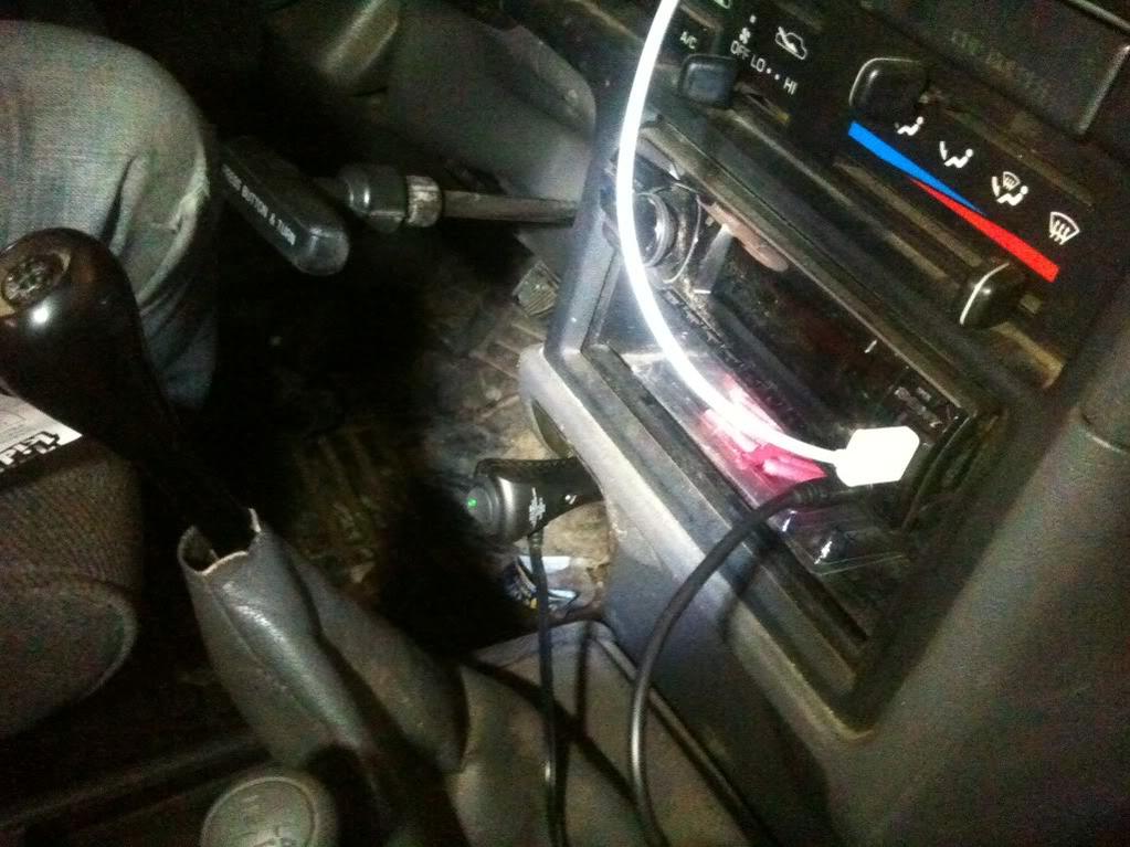

It is a manual transmission. FYI
Post #74 of his build thread.
to try a few more things today. If I can't get it started by the end of the day, I'm rolling it to a shop. I know a shop that won't charge me a fortune. Very frustrated.
