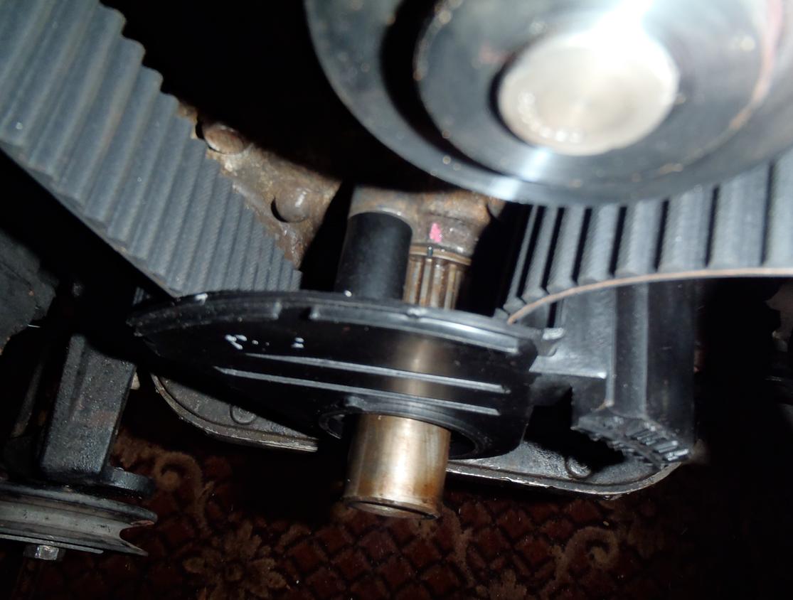

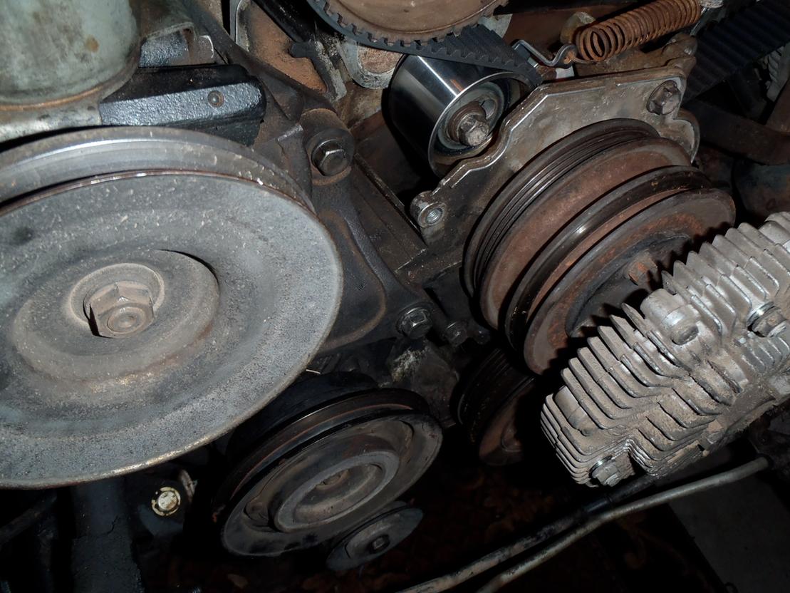

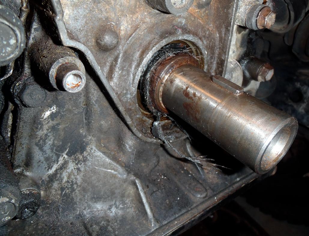

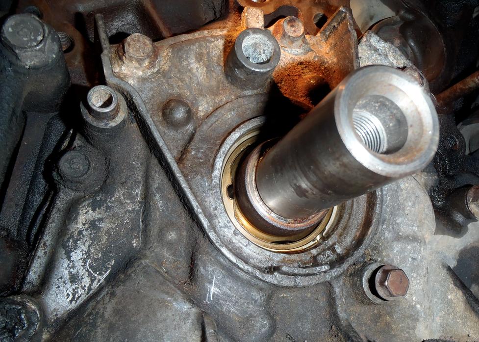

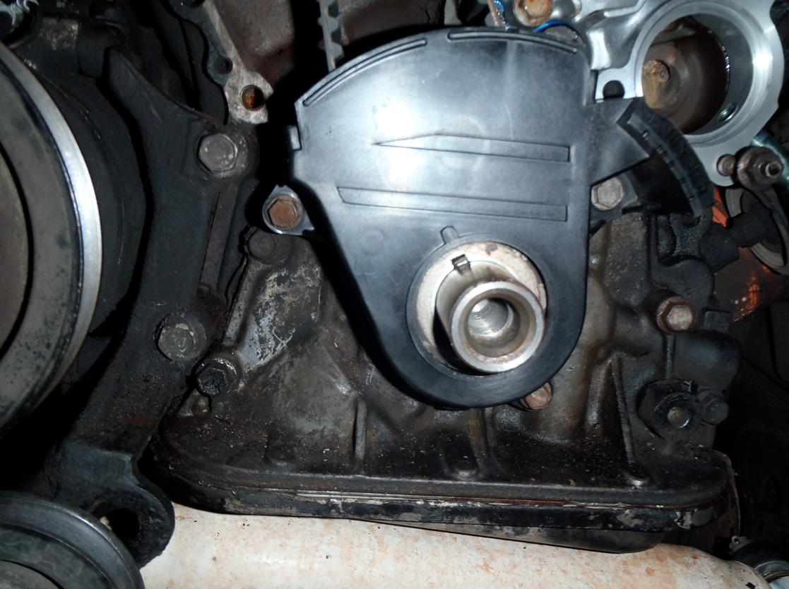

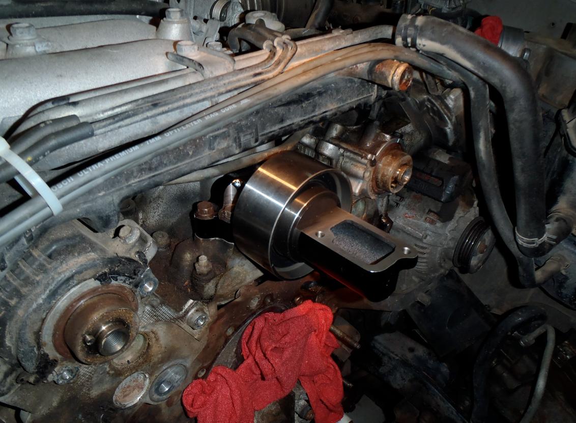

Finally had some time this evening. Take a look at the rubber that was around the crank behind the main seal. Got all that cleaned out with new seal installed and a little more. I might have this thing back together for Classics 2013.

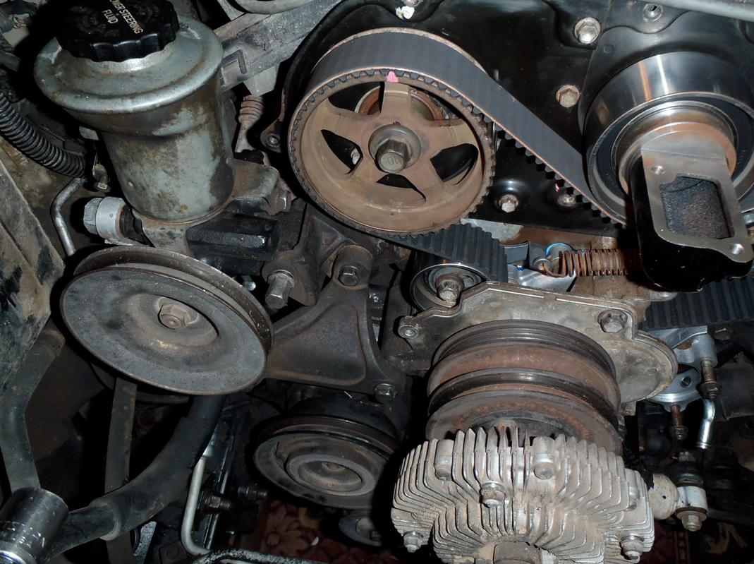

Note: The timing marks on the LH Cam Pulley and crank pulley are off. I was doing some test fitting when this bottom picture was taken. As it sits now the belt is back off. Heck none of the cam pulley bolts are even torqued yet.

I don't mean to question your work, but you might want to realign your timing. See that slack on the water pump side? When the engine begins to rotate, that slack will take up before the cams turn and you will probably be a tooth off on the cam timing. The chilton manual says to rotate the engine two times after installing the belt and then re-check the timing marks. When I did that on my engine, the crack gear was lined up, but the cams were about a tooth off.
So, to take up that slack, set the cams dead on, but rotate the crank about one tooth counter clockwise. Then, install your belt, and slowly rotate the crack to TDC until the slack is taken up. You will probably have to play with it a bit and might have to go 2 teeth on the crank. Just a suggestion.
ah glad you caught that. always get it as tight as you can on the opposite side of the tensioner.

By all means man. That's why we have these boards. Got to look out for each other. In this case I was only doing a dry run as I had never done a timing belt before. If you'll notice the crank pulley and all is not even installed and as mentioned the cam gears where not even torqued. I was just looking to see how it all lined up.

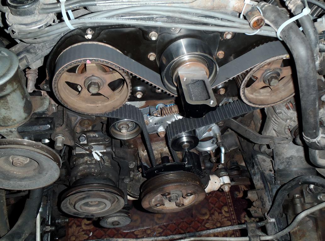

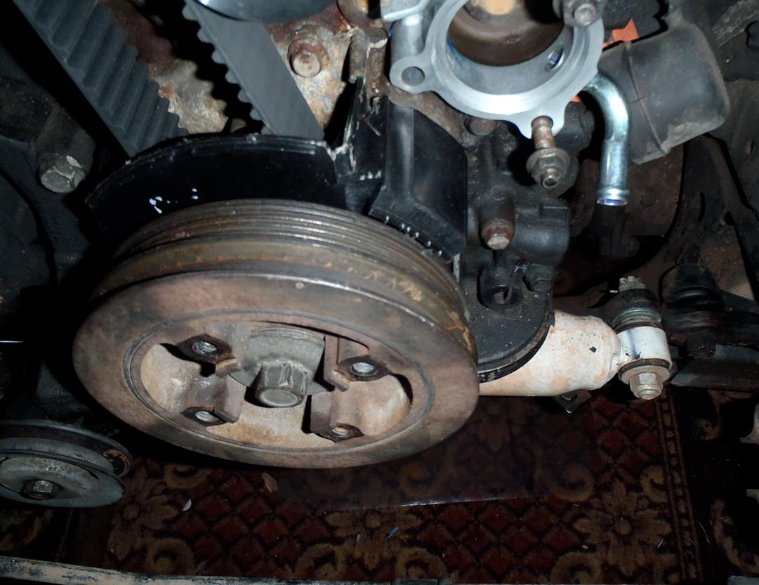

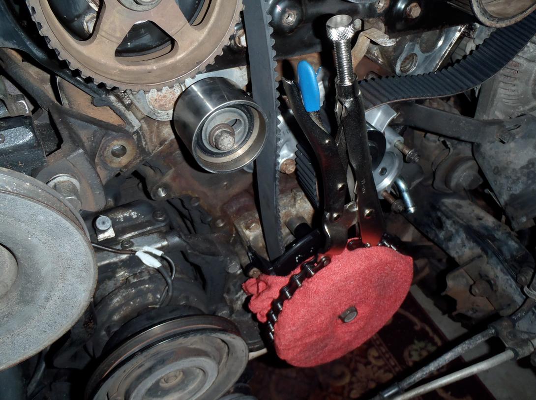

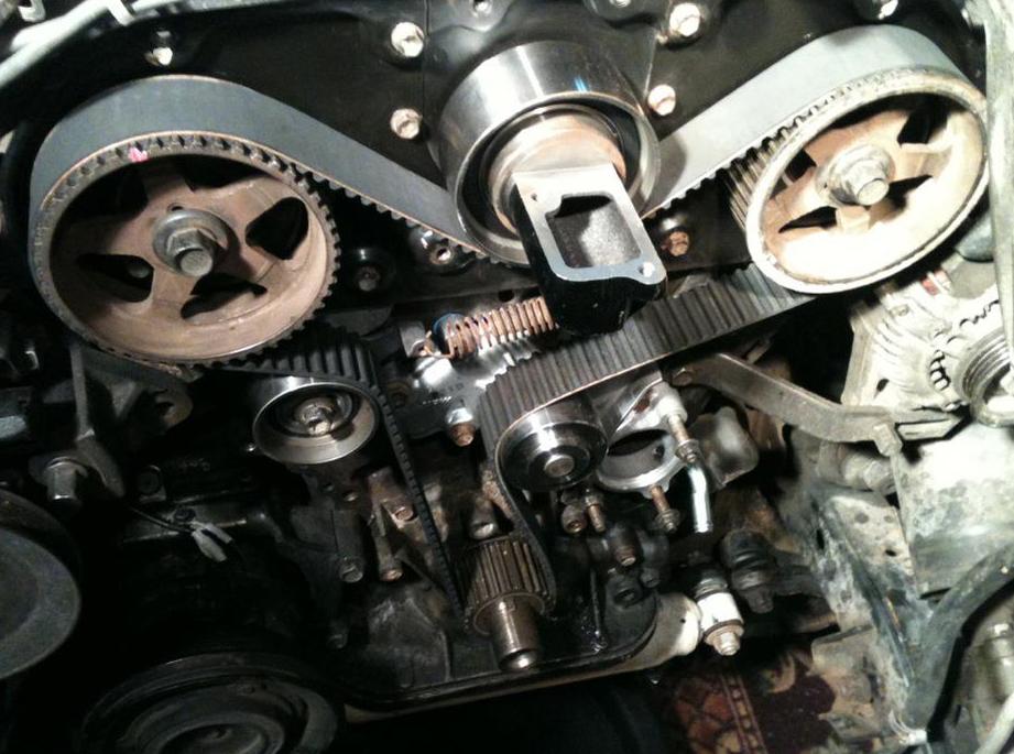

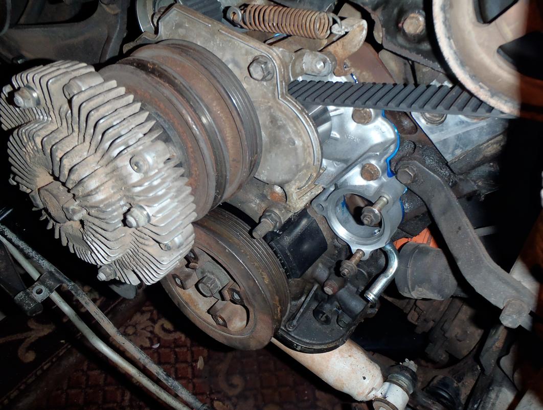

Since there are numerous write-ups on the internet regarding the steps and the FSM is fairly clear on the steps to take, I decided not to go crazy with a huge write up as I did this. The only advice I will give is to use a chain wrench to hold the cam gears and the crank pulley vice locking a wrench in and turning the key. With a couple of breaker bars, it is not that difficult. It of course helps to have a buddy give you a hand.
Here are some pictures for future reference in the event that someone has a question about a certain part. Pictures are always helpful IMO.
