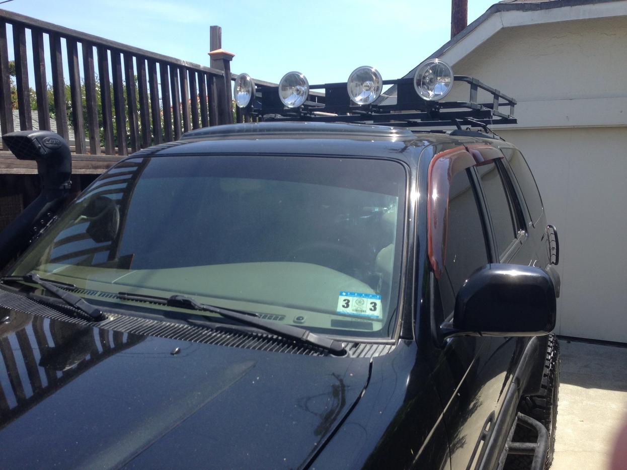

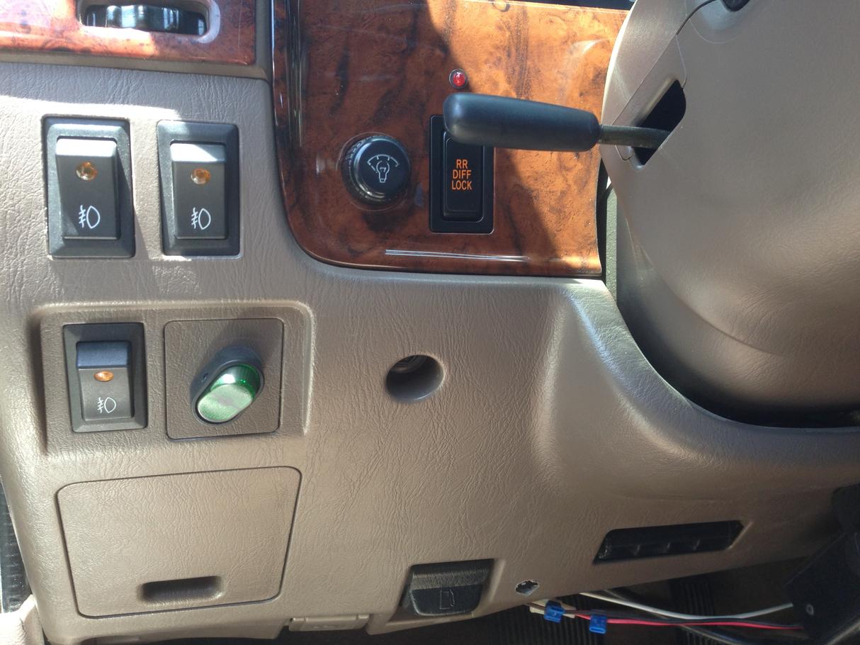

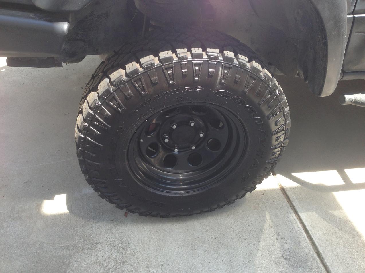

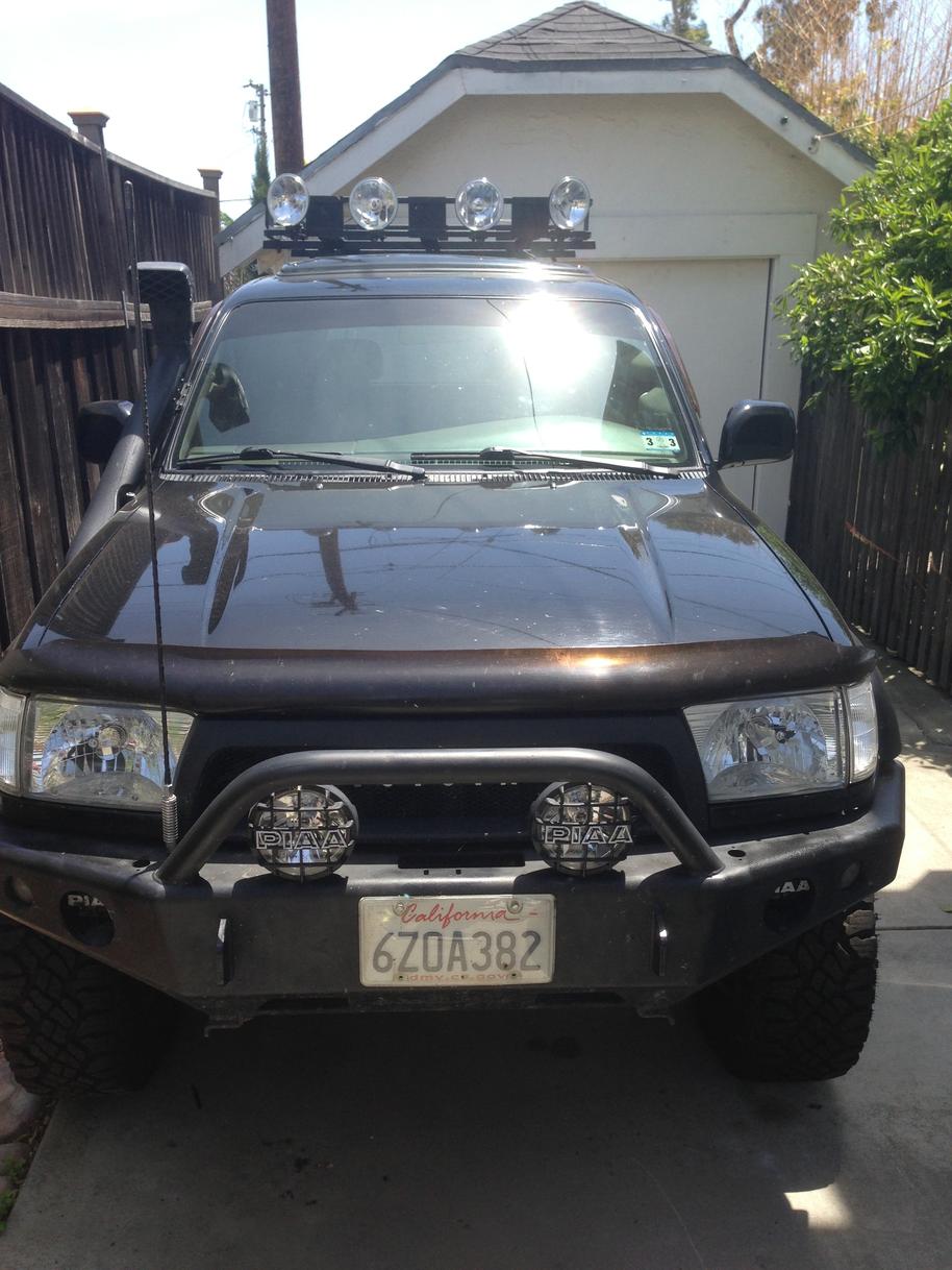

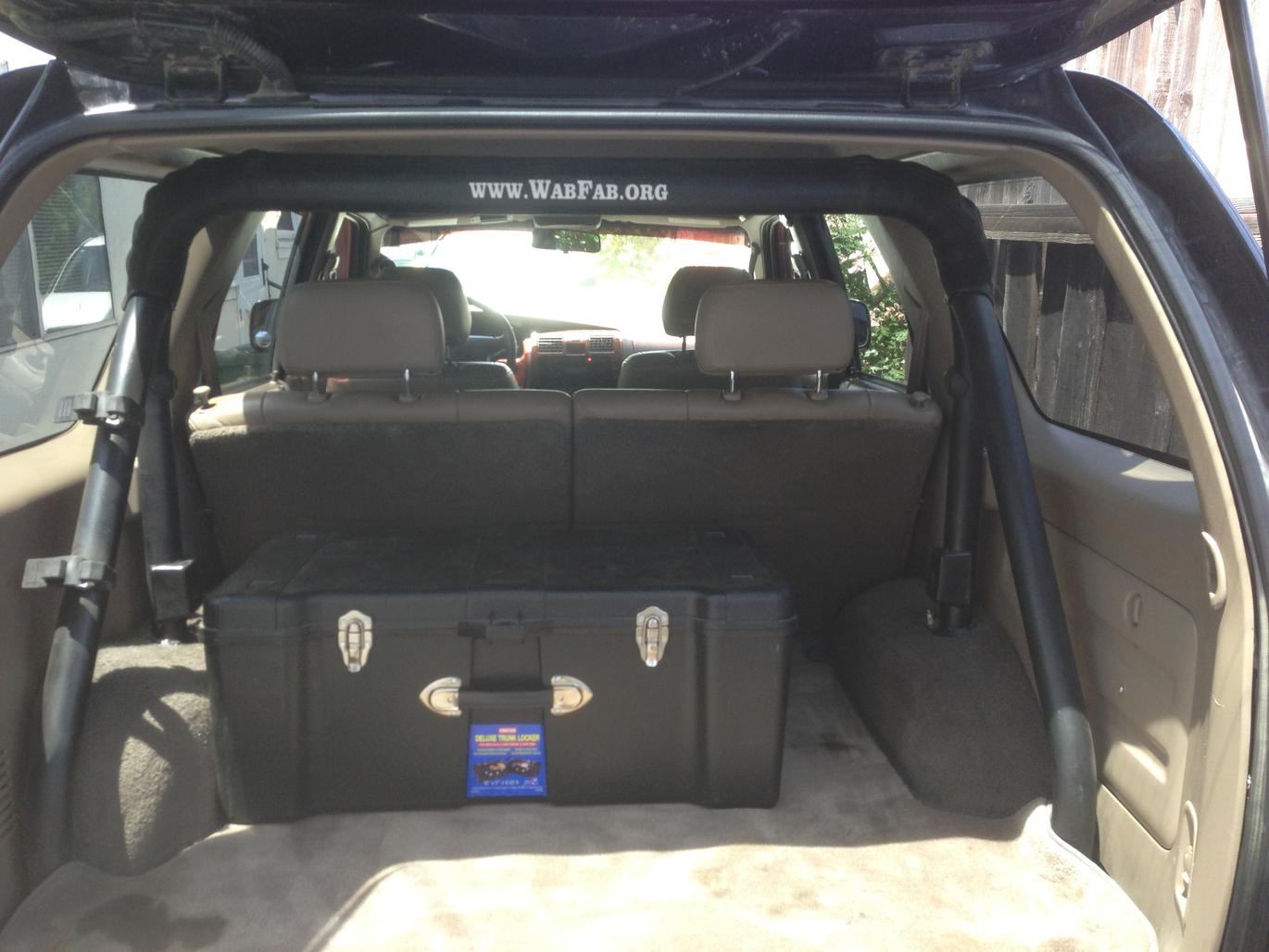

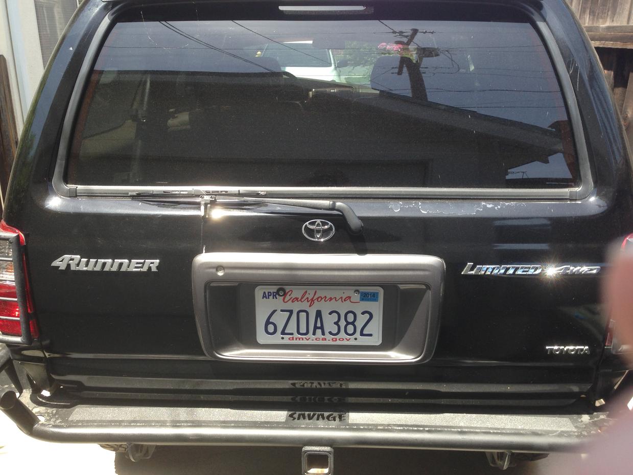

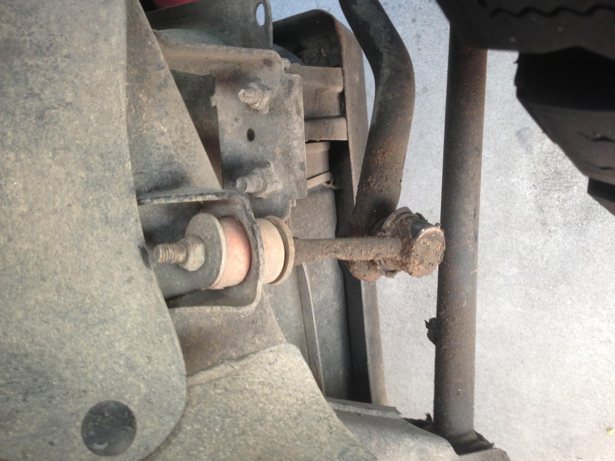

I think that I need to attend to this ASAP before wheelin'. I have never replaced sway bar links before. Does this look like it could snap at any time?IMG_0959.jpg
You're good. It doesn't look that bad and most people take off the rear sway bar anyways. If you replace them get some 3rd gen front sway bar endlinks or 2nd gen rear sway bar endlinks. They are longer and will allow more flex.
I went down to NAPA this morning and bought a set of front end links for the rear. My Energy Suspension sway bar bushings will be here Sat or Mon. I will do all at once.
Nice, it's pretty simple, but you will need an allen wrench for the lower connection. A ratcheting wrench will help a lot with this.
