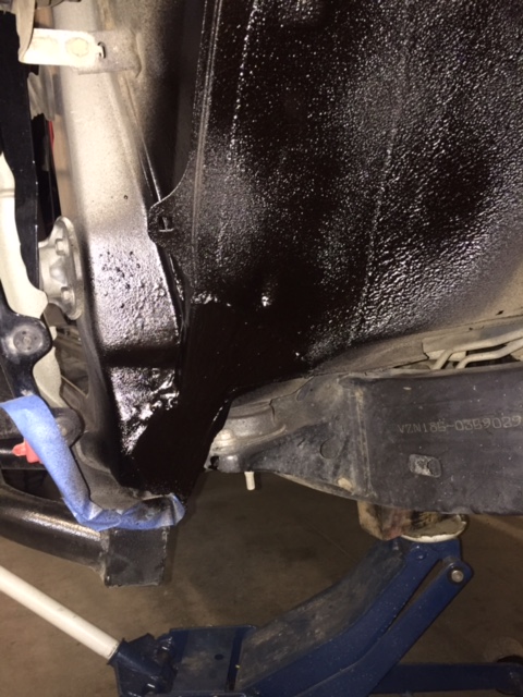

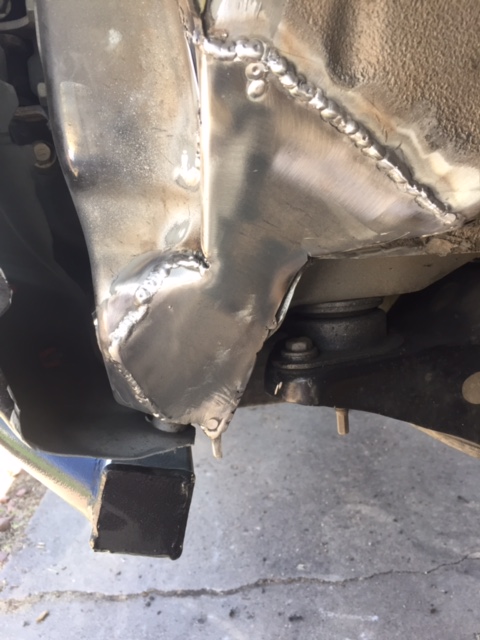

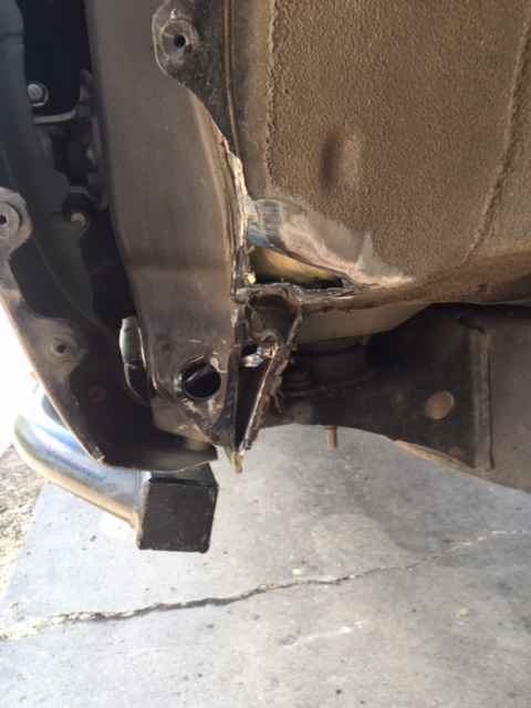

I am at work and don't have many pics of my tub. Here is what I was able to find. I will try and see if I can find some pics of it all completed and put back together when I get home.
