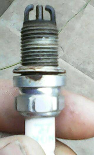

So know I know what proper cylinder 3 I tried injector noid light test and both were good. Decided pull plug and ran into major problem. There is caked on baked stuff around plug and threads inside head. Cant tell if oil or not. Any ideas?
This is the spark plug from cylinder 3
This is the picture of cylinder 3 spark plug

Try to take a pic of the coil boot. If the boot goes bad it will not fire correctly. Get a pic inside the hole where the spark plug is if you can. I've had this problem on both of my runners on plug 3 and 5. I've changed boots before to fix it, a coil another time and an injector yet one more time between the two vehicles. Boots are cheap: $15 or so.

i replaced plug and runs fine 4now and no CEL.
sparkplug boot is clean and new
cant get picture of gunk in the sparkplug tunnel.
