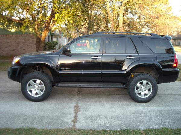

I have OME 885/895 on a v6 b/c im adding a bumper/winch combo in the near future. I agree, i would not use the top out spacer eaither. You still want alittle rake. It looks silly sitting nose high.
retco, that sits perfect IMO. Good looking ride! Couple questions for ya...what size tires are those? Are you running wheel spacers? Did you do the diff drop?

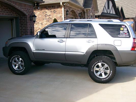

Here's what it will look like with 265/70/17's. This was before the bodylift. But i also have the top plate spacers on so the front will sit a little lower if you dont have the spacers.
Cool, that's a great point of reference. Thanks for posting that.
No problem. I was worried about that too. First i had the stock wheels and tires which looked really goofy. Next was the previous pic with the 265/70/17's and FJ wheels which i thought looked pretty good. After that was the 1.5" bodylift with the 265/70/17's which i thought looked goofy again. Just something to think about if you're thinking about a bodylift in the future.
Cool, so in that pic did it have a body lift in addition to the OME? Your 4R looks a little higher than the pics that some of the other guys have posted.
No, the pic on the 2nd page with the FJ wheels is without the bodylift. The pic on the 1st page with the black wheels has the bodylift.

G.I.G., here is a list of my set up.
OME 885/895 springs
OME 140/141 shocks
285/70r/17 BFG KO'S
Spider Trax wheel spacers
Light Racing Upper Control Arms
I have had the Light Racing UCA's for a couple months, they are great, my alignment came in perfectly. In the future this will always be a must have mod for me with lifted trucks.
