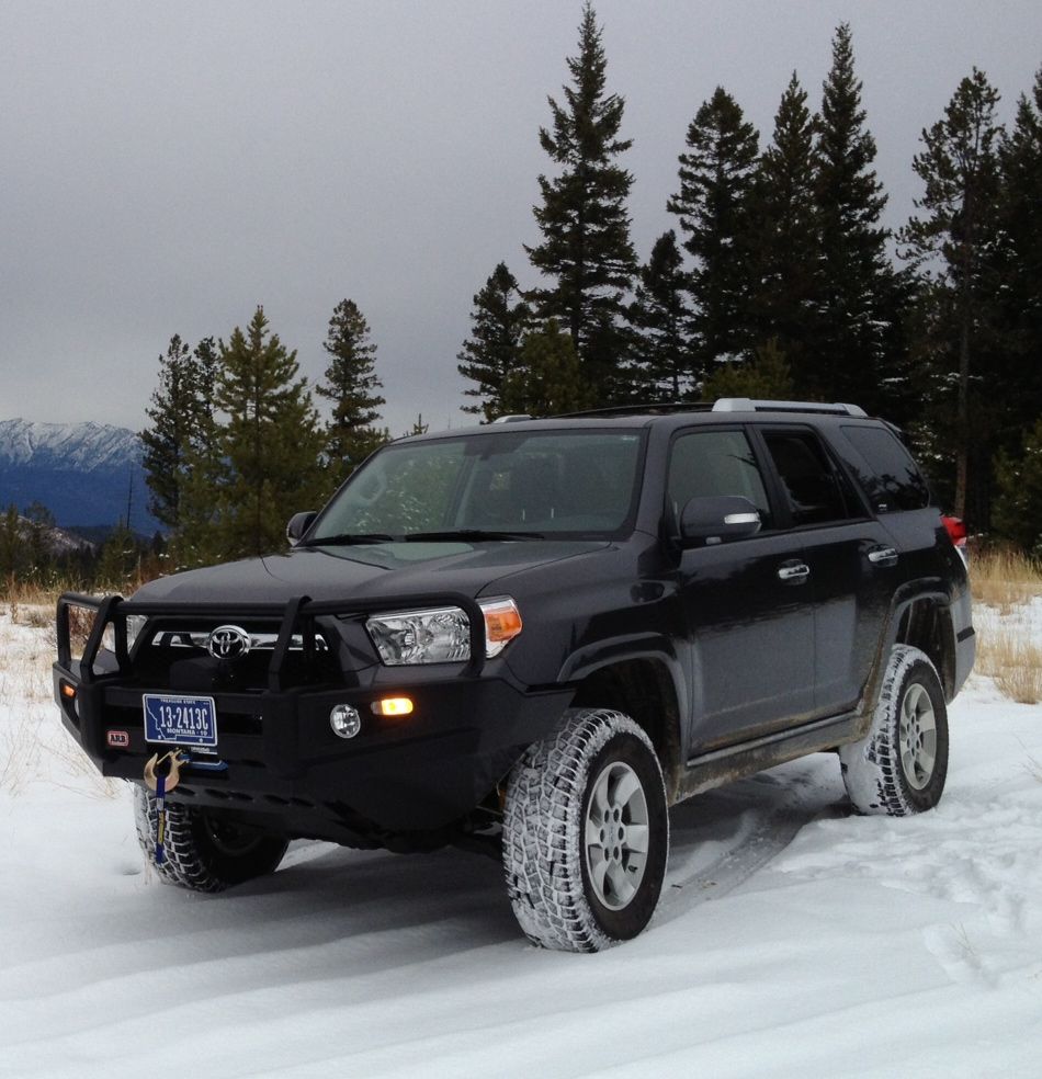

I've got the medium OME on my rig. Haven't done a lot of off road with it yet, just a bit in Montana, headed to Moab in the spring for a good ring out. Looks good and handles well. Although I will mention this about alignment. I got the OME as it was supposed to be an engineered system, and not high enough to require any additional aftermarket mods. I've had it to 2 alignment shops now and factory specs for Caster cannot be achieved. I'm in contact with ARB and my local shop that did the install to see what's going on here. Factory specs for Caster are 2.5º to 4.0º and mine sits at 1.7º. In searching forums, I've found that Camber is important to tire wear, and Caster shouldn't hurt tire tire wear but affects steering handling. It seems to handle pretty well but seems to wander a bit more than before lift. I realize there is aftermarket UCA's to accomodate this but OME was supposed to be a stand alone mod. I'll post more when I hear back from ARB- they have said they are surprised, and that factory specs should be achievable
Pic of my rig
Forgot, meant to show this pic
