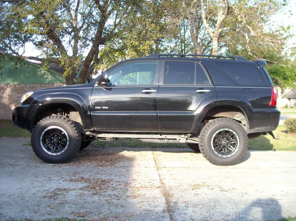

I have the OME 3" lift installed. I love the ride, i think it handles far better than stock. The only downside is it is really stiff over small things like speed bumps at low speeds. Kinda like the rear end falls away from the bump too fast..

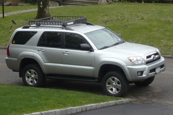

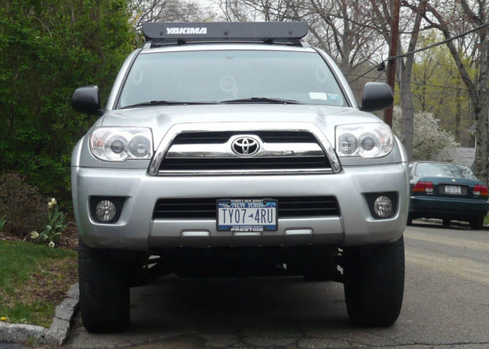

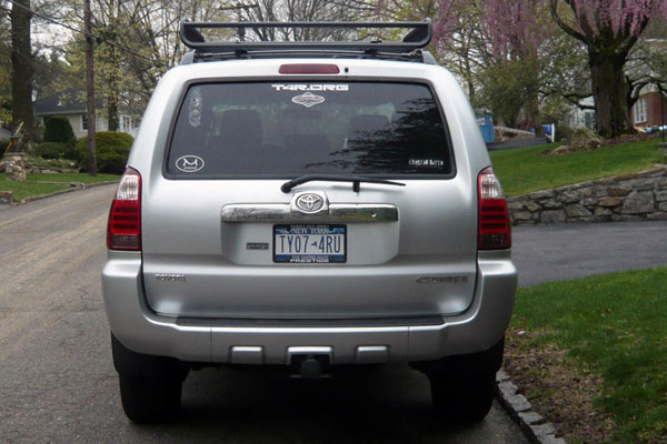

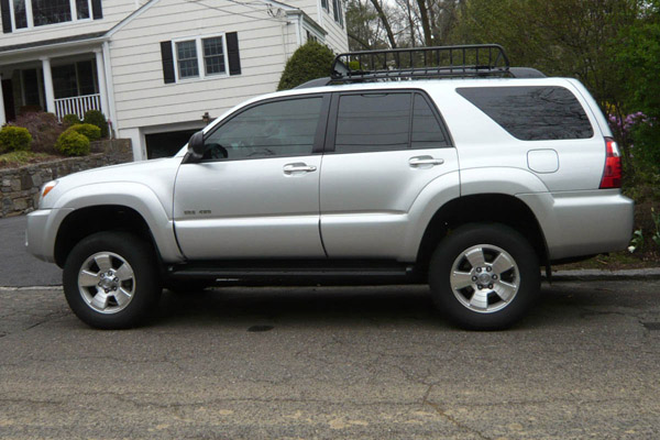

Got the OME installed yesterday so I can't say a lot. The ride a bit stiffer, not so bad. I do feel a bit more body lean at turns and over bumps. Maybe because the center of the gravity is higher? Or maybe my driving, I like to take the turns fast, now I have to cut that back. Darn. With the front top plate spacers there's only a 1/4" difference between front and rear.
My rear raised about 4". It should settle I heard. The instalation went well, nothing broke, nothing leaks. The headlight had to be adjusted, it was a bit high. The Yakima fairing is a bit noisier. I did not notice much change in MPG in the city. So far that's all.

Thanks for posting those pics, dieselwolf. Looks great!
It looks like the front sits the same height or even a little higher than the rear, judging by the amount of clearance in the wheel well. Does the front top plate spacers come optional or is that part of the kit? I've been thinking of doing the OME lift but from some of the pics I've seen the front end sits too high for my tastes. If it is because people are doing spacers in addition to the lift that might be the reason why.
Also, did you do the diff drop?
