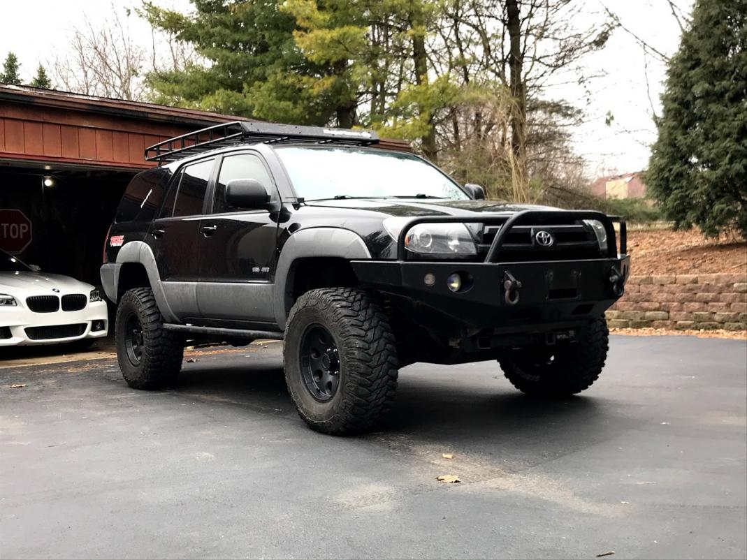

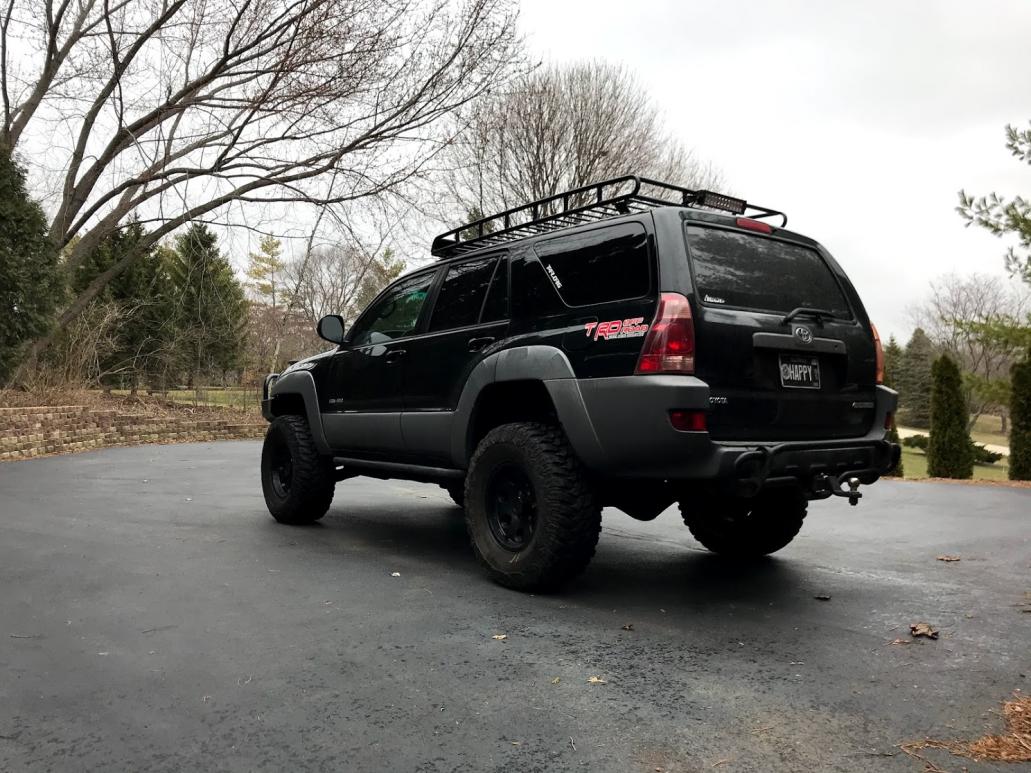

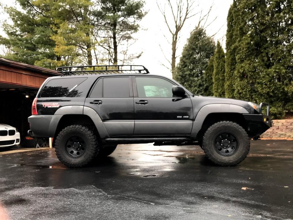

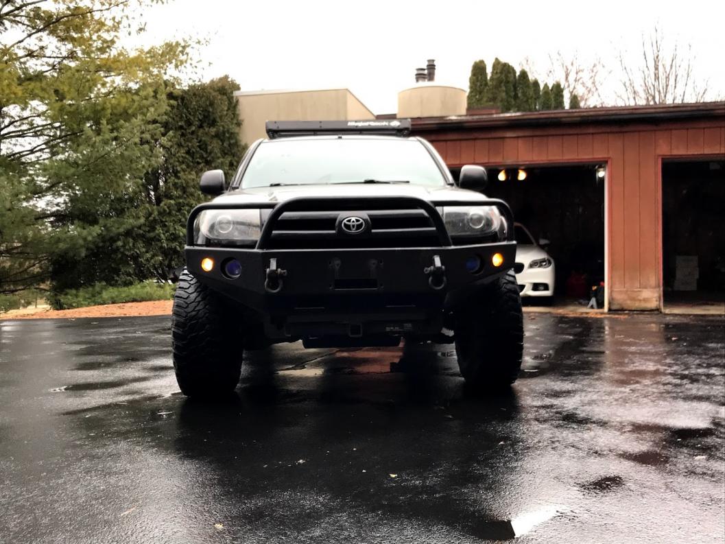

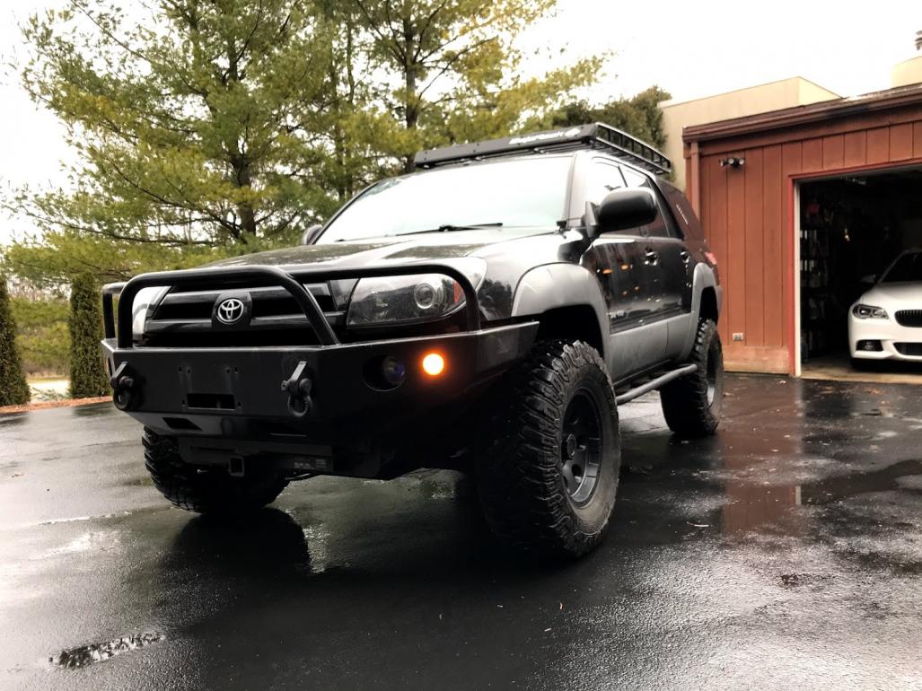

Test fitted a set of Cooper Discoverer STT Pro 305/70/16 tires mounted on GM wheels and looks like I won’t have any issues .
Pics when you get them mounted. I bought another set of 285’s when I should have gone 295 or 305. It’ll be a while before I can justify new tires lol.

Pics added
