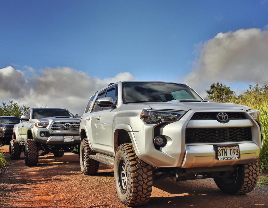

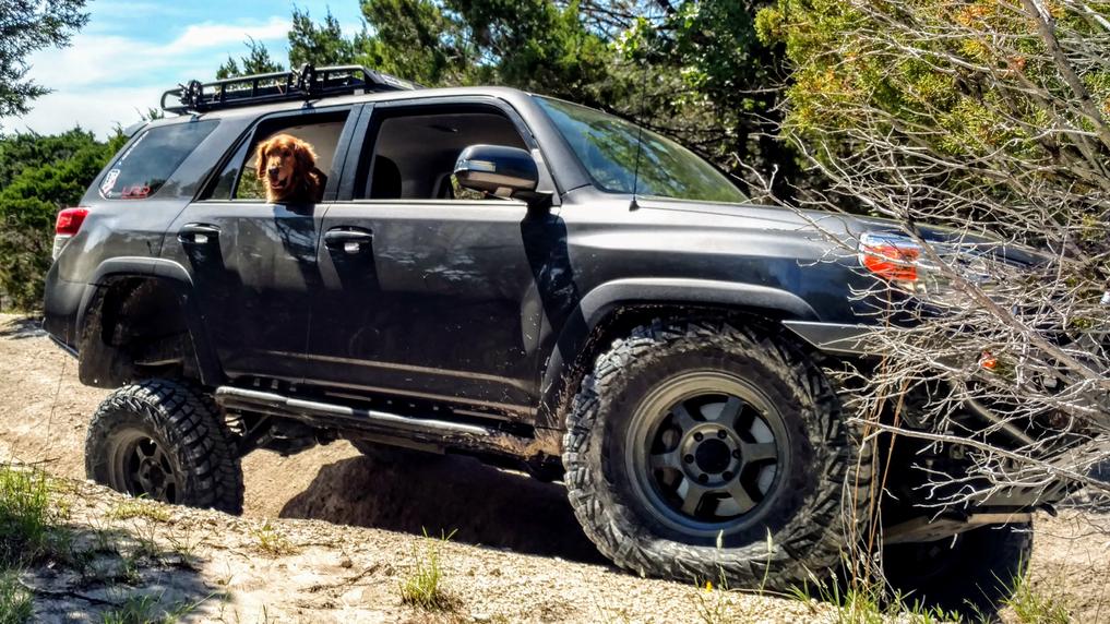

Be prepared to chop a lot of front inner fenders. I went from 305/65 to 295/70 and think the 295 is a better size proportionally. I have no idea how guys fit 35s in there.

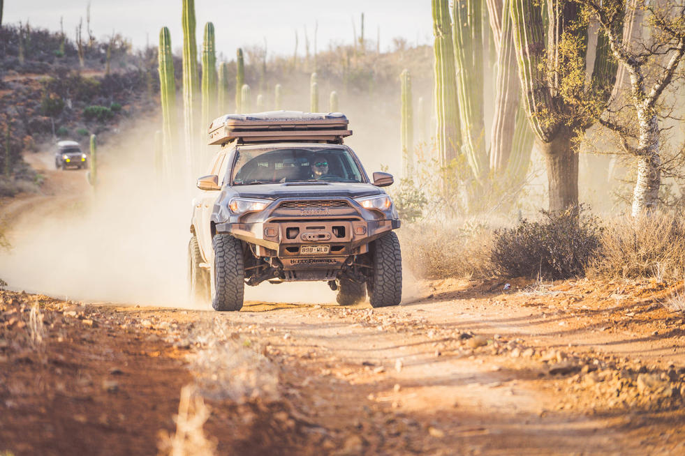

295s are slightly taller and narrower than 305s:
295/70 is 33.5" x 12"
305/65 is 32.8" x 12.5"
The last pic is the 305s

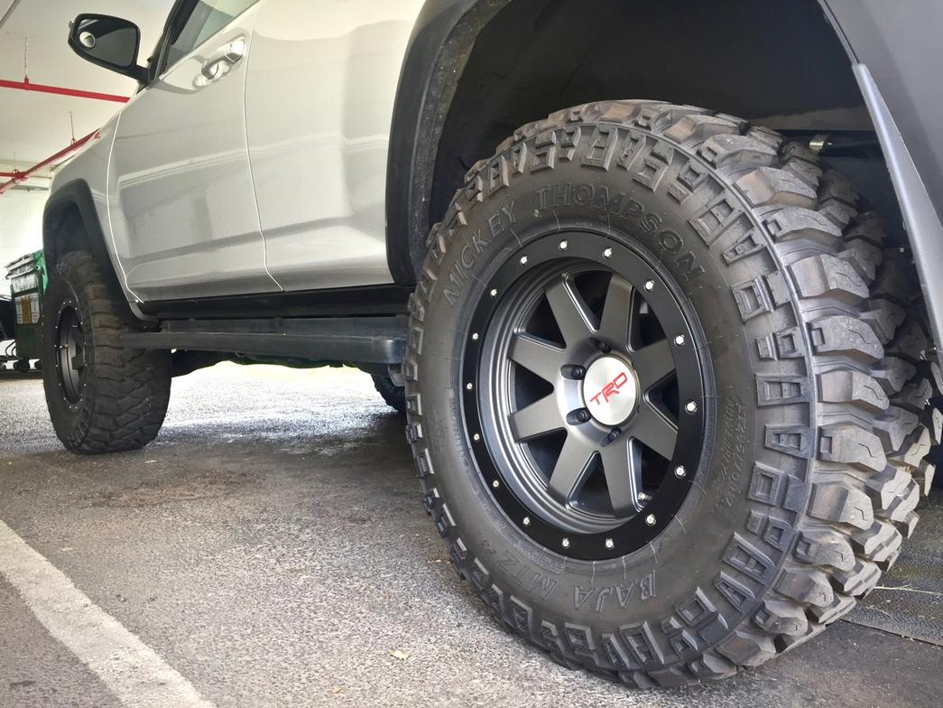

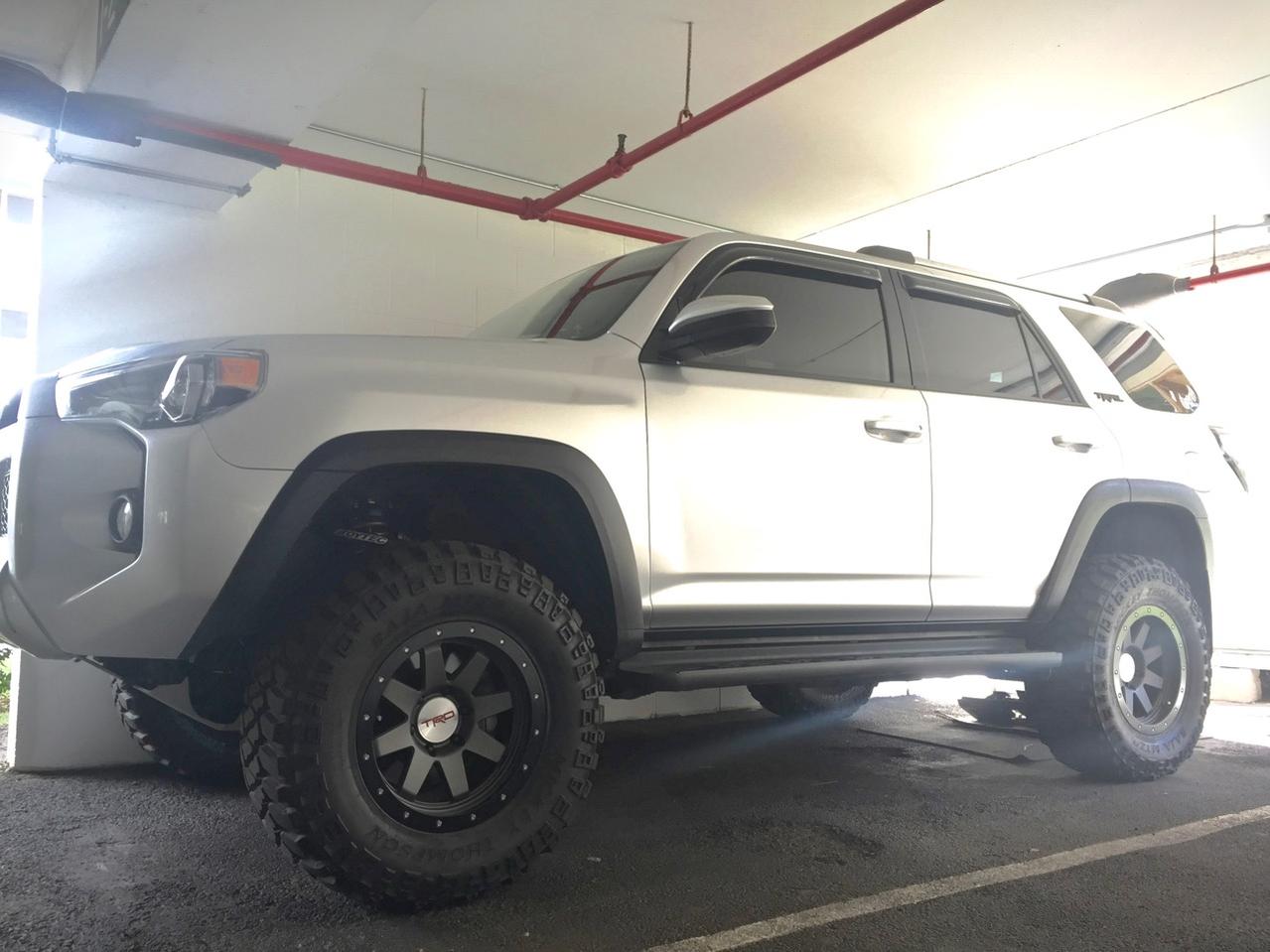

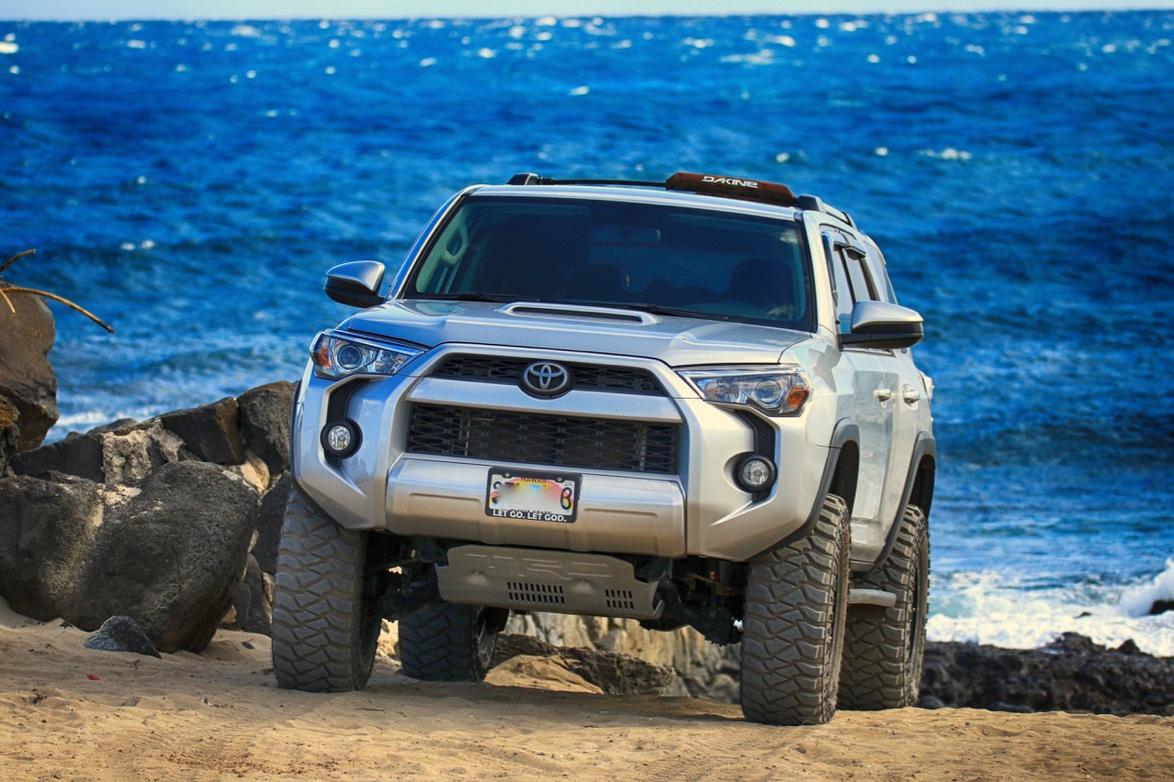

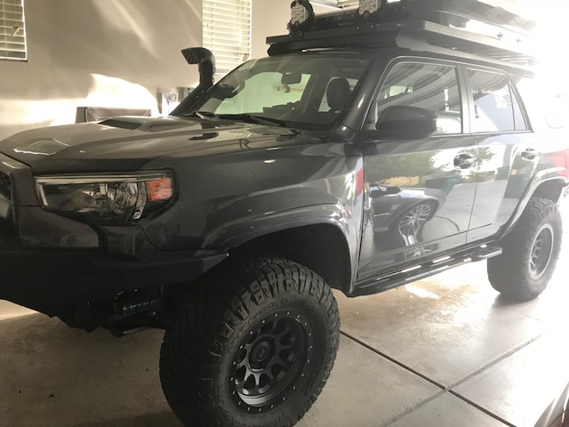

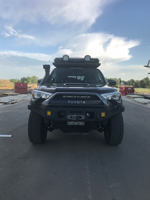

Yea, i'm running 305/70/17's on SCS Ray10's. Like [MENTION=56922]NoOneBetter[/MENTION] and [MENTION=44305]weeeee[/MENTION], I run McQueen fenders. I have Timbren bumpstops in the rear and Superbumps in the front.
I don't seem to be rubbing in the rear, but I have Dobinson's 677V progressive coils, so I bet as they stiffen they keep my butt up. We'll see if that changes when i put the Pelfrey rear on.
In the front I rubbed enough to rip off the rocker end caps. They are both somewhere in the mountains of Colorado now...didn't mean to litter!
I too rub a little in the back of the wheel well. Its not too bad, but you can see some marks from where the front has compressed enough to rub. I ask for my caster to be at +4 and the alignment techs usually get it there or 3.9.
First three photos are blahhh, but they are the most recent. Last one was taken by [MENTION=44305]weeeee[/MENTION]

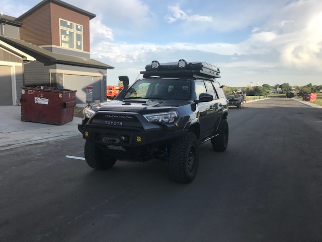

Sweet. I am thinking hard of 305/65/17 KO2's, since I love this tire. My hesitation with 285/70 KO2's is that they tend to run small and look too narrow - well, 305 fixes that! PS, Her4RunnerLife on IG runs 305/65/17 and has a lot of pictures of it.
I first considered 295/70/17 but KO2's don't come in this size and thus I'd have to go Nitto Ridge Grappler or Toyo R/T or KM3 and I think a true AT might be my better bet.
I run 305/70-17's as well, on 9" rims. Came from 285/75-17. Most of the above is spot on, lot's of trimming and run your caster as high as possible. I have mine at about 4.9*. A front bumper makes it far easier. No issues with rubbing in the rear but I run a lot of coil back there giving me 3" lift. I do run extended bump stops in the front but not the rear due to running the Sonoran Steel KDSS Trac Bar which makes them undesirable.
FWIW I found it easier to fit the 285/75-17's than the 305's. Both Ridge Grapplers. And the 285's were much lighter.
I'll snap some pics this afternoon.
