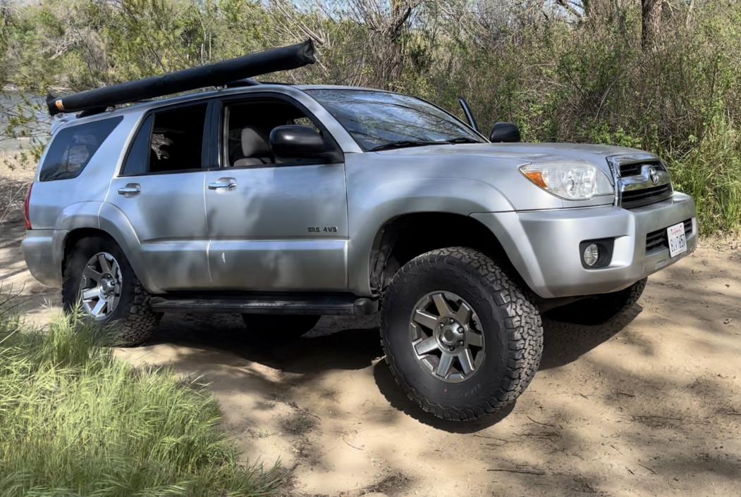

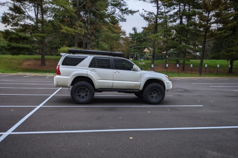

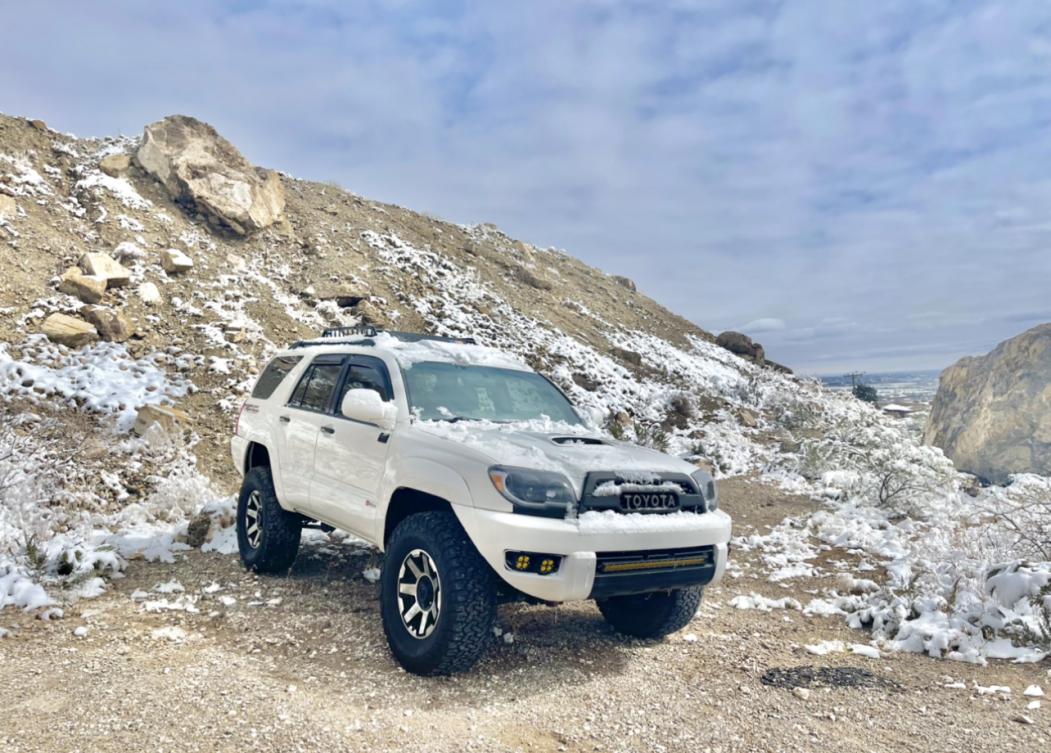

Tire Size: 35x12.50R17
Tire Make/Model: Yokohama Geolandar M/T G003
Wheels: 17x7.5 +15 offset + 1.25" Spidertrax spacers
Bodylift: No
Approx. Suspension lift setting over stock: 3" Dobinsons extended front/long travel rear
Aftermarket UCA's: SPC
Caster correction: LCA full caster forward with Taco Tabs, SPC UCAs at setting G
Bumpers: front True North Fab hybrid - rear - tube bumper/carrier (soon)
Trimming: Already had a BMC for 295s, pinch weld was beat up front even though I didn't really need it back then. Rear mudguards trimmed but still hits the cover - will be trimming when I do the rear bumper.
Bumpstop drop? Durobumps F/R, Rear 2" bumpstop extensions for LT
Notes: Clears the BMC pretty easily but I think I get a little frame rub on full lock. Not sure I would do anything different - need to look into wheel offsets a bit more. Getting the proper alignment is the most crucial to get the front tires as fr forward as they can possibly be - maxing the LCA cam bolts to rear outboard and front inboard + SPC setting G gives you as most as you can get. No links on her yet, will probably try 3/16" extended soon.

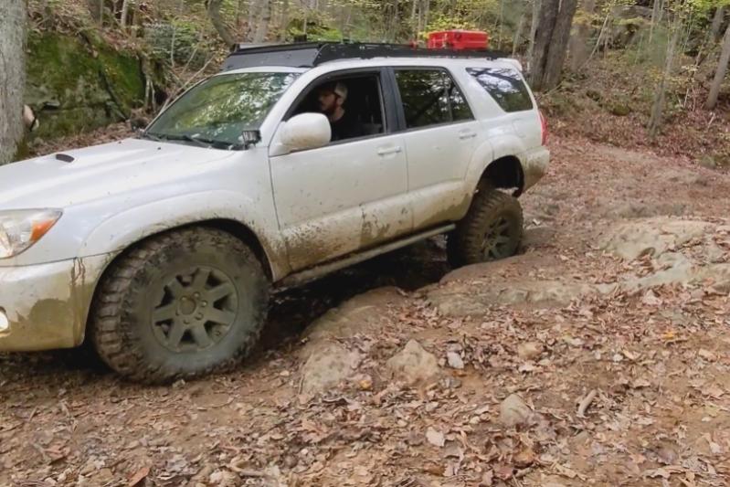

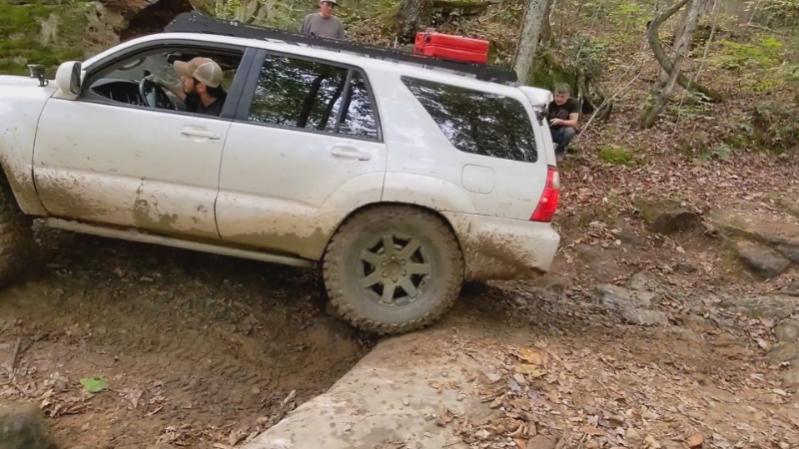

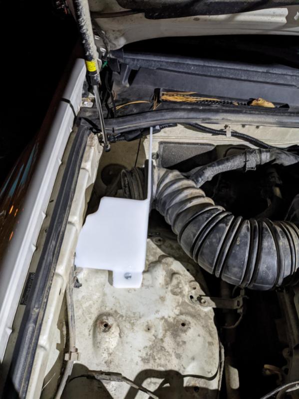

2008 V6
Tire Size: 315/70/17
Tire Make/Model: Cooper STT Pro
Wheels: 17x7.5 +15 offset + 1.25" spacers
Bodylift: No
Approx. Suspension lift setting over stock: 2.75-3 front, 2.5 rear. Toytec Aluma 2.5 series
Caster correction: LCA full caster forward, SPC UCAs at setting F
Bumpers: stock
Trimming: relocated the washer fluid. Have a BMC. Took a tapered cut off the back of the rear wheel well from 0-1.125 approximately. Hammered back the pinch weld in the rear. Took 1 3/8 all around of the front flares including the sheet metal on the fenders. Hammered back pinch weld and part of fire wall. Relocated intake.
Notes: I rub the frame at full lock to the right. So far that's been pretty easy to avoid. At higher speed compression while turning, the front will kiss a section of the upper inner wheel well. I'll need to hammer that a bit to prevent that.

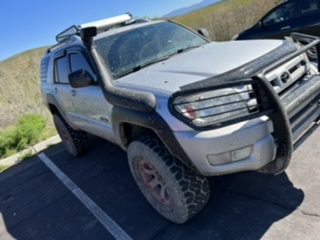

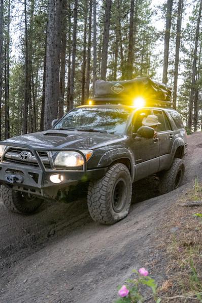

3” OME lift
Bilstien 5100
Freedom Off-road UCA
OEM TRD Off-road Wheels
17x7.5 Offset: +15mm
BF Goodrich AT Baja Champ KO2 315/70R17
BMC and front bumper trim. Cut the pinch welds and hammered back a bit of the frame.

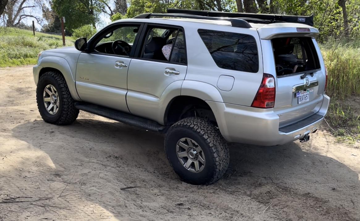

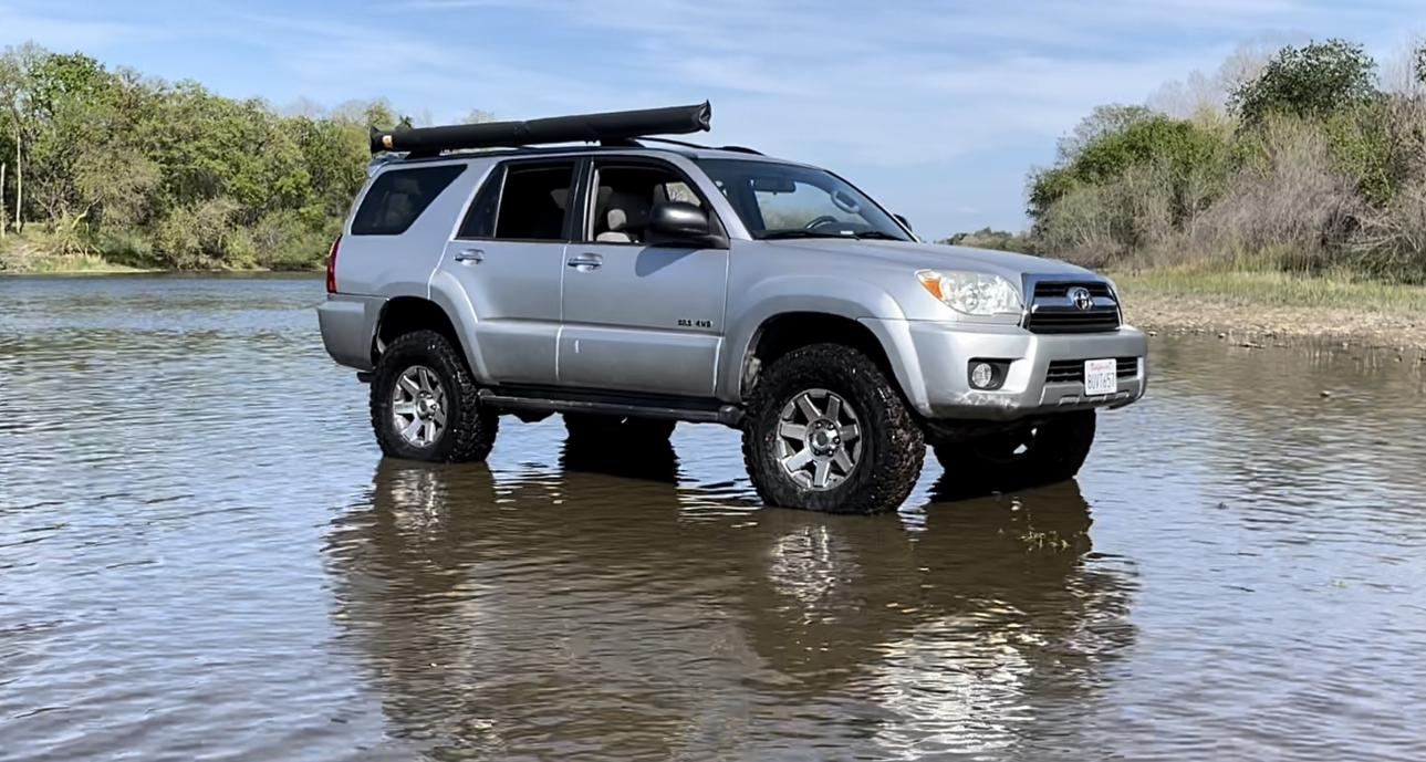

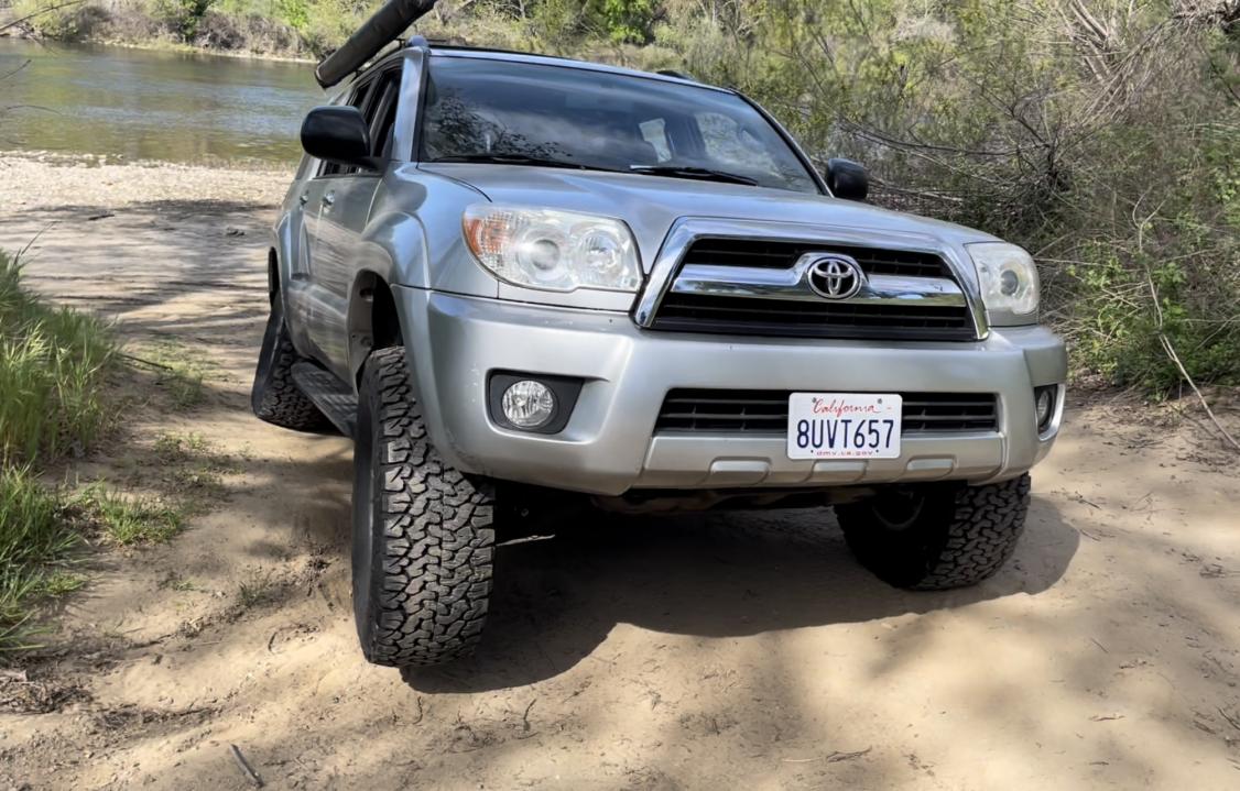

First of all thank you for all that shared there setup, without it I wouldn’t have the confidence to purchase 35s!
Tire Make/Model: BFG KO2
Wheels: 17x7.5 +15 offset &
front 1.25” Spidertrax spacers
Bodylift: No
Approx. Suspension lift setting over stock: 3" Front bilstein shocks with t4r 5th gen springs/ Rear Freedom offroad shocks and springs.
Caster correction: SPC UCAs at setting F
Trimming: BMC, front and rear wheel pinch weld, mudguard area front and rear, front bumper
Bumpstop drop? Stock for now
Notes: It’s only rubbing a little in the front when making a sharp u turn.

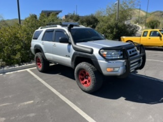

Rancho quick lift with daystar 1 inch puck front, freedom off-road upper control arms, diff drop, energy suspension bump stops, box out rear billstein b8 2.2 inch lift springs, rancho 9000 rear shocks, fuel 17x9 -12 painted red wrapped in 315/70/17 duratracs. A lot of offer up Amazon and rock auto pieced together.

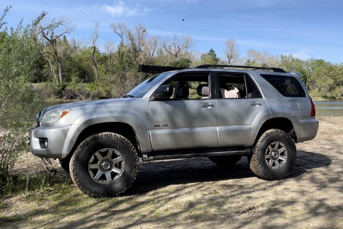

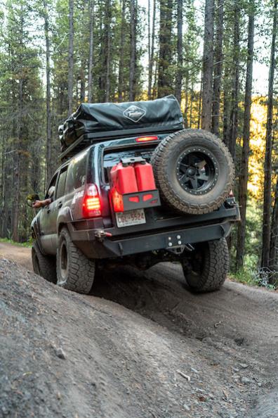

2006 4Runner V6
I have been running 35's for about 2.5 years now
Tire Make/Model: Yokohama X-AT
Wheels: SCS Ray10 17x9 -38mm offset
Bodylift: No
Suspension Lift:
3" front and rear
Caster correction:
SPC's at setting F
Bumpers:
CBI Front and Rear Bumpers
Trimming: Cab mount chop and pinch weld seam flattened. Front fenders and flares have been cut 1.5". Washer fluid tank relocated
Bumpstops:
Front bumpstops are Energy 8.9104. Energy's website states they are for the rear but work perfectly up front. The rear bumpstops are Timbren active offroad with Toytec extensions
Notes: Since trimming the front fenders I can only manage front rubbing if I'm fully flexed (Like 2 wheels off the ground). The rears don't rub on the front of the wells or the top but unfortunately, they rub on the CBI bumper. Unless you are prepared to cut your $3K bumper I would not recommend this one for 35s.
The most common issue I have come across is my front wheel bearings. The -38 mm offset puts a lot of leverage on them and combined with the weight of 35's the bearings wear very quickly.
The fuel economy is poor as expected. Depending on how I drive it will range from 15-23L/100km or roughly 10-16 mpg. Future plans to re-gear should aid consumption.
Extended rear links would be great but the current rubbing on the CBI would need to be fixed first.
Anyways, still loving the 35's and dont regret it!
