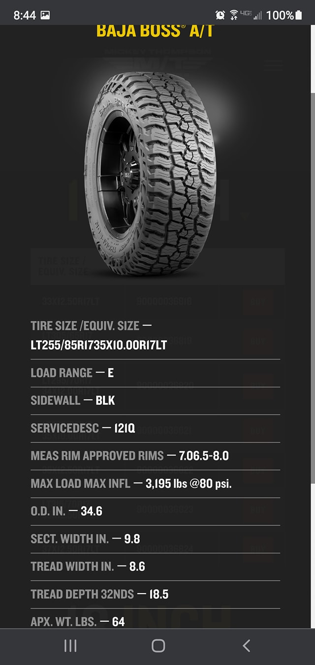

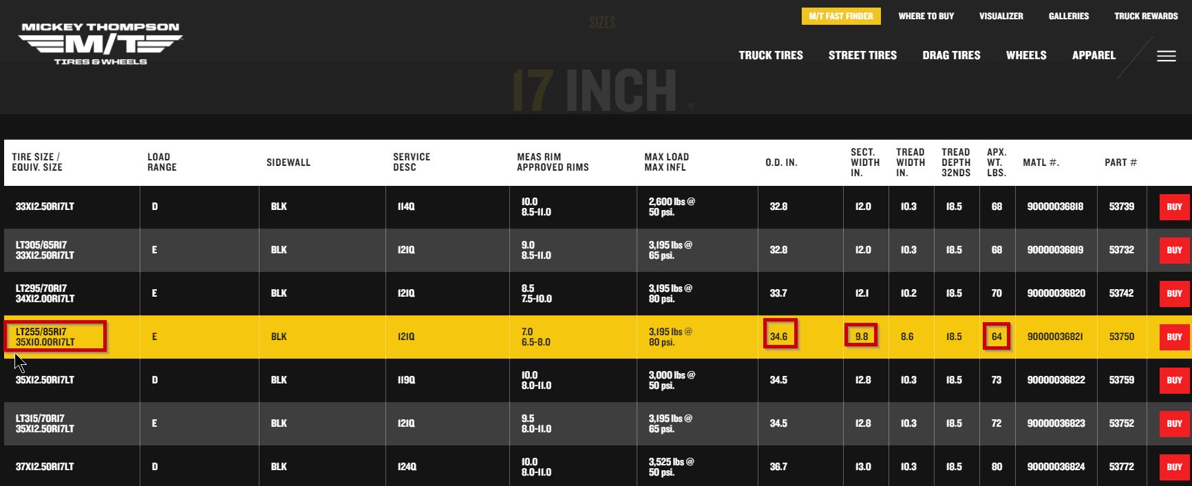

Anyone try a pizza cutter 35s?
Looking at 255/85/17

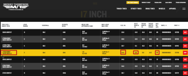

Help me Feel better!

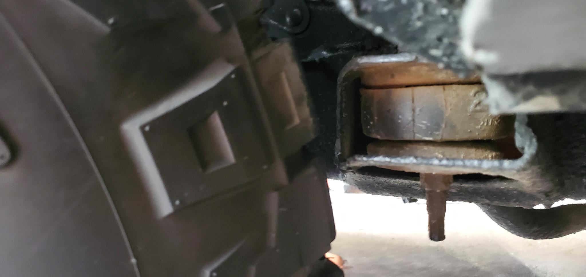

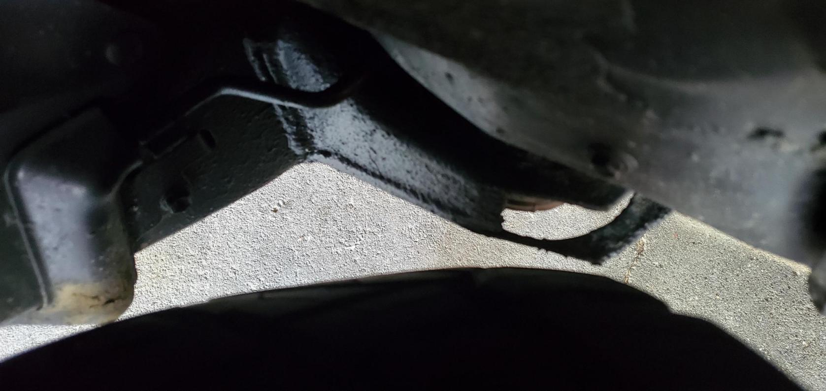

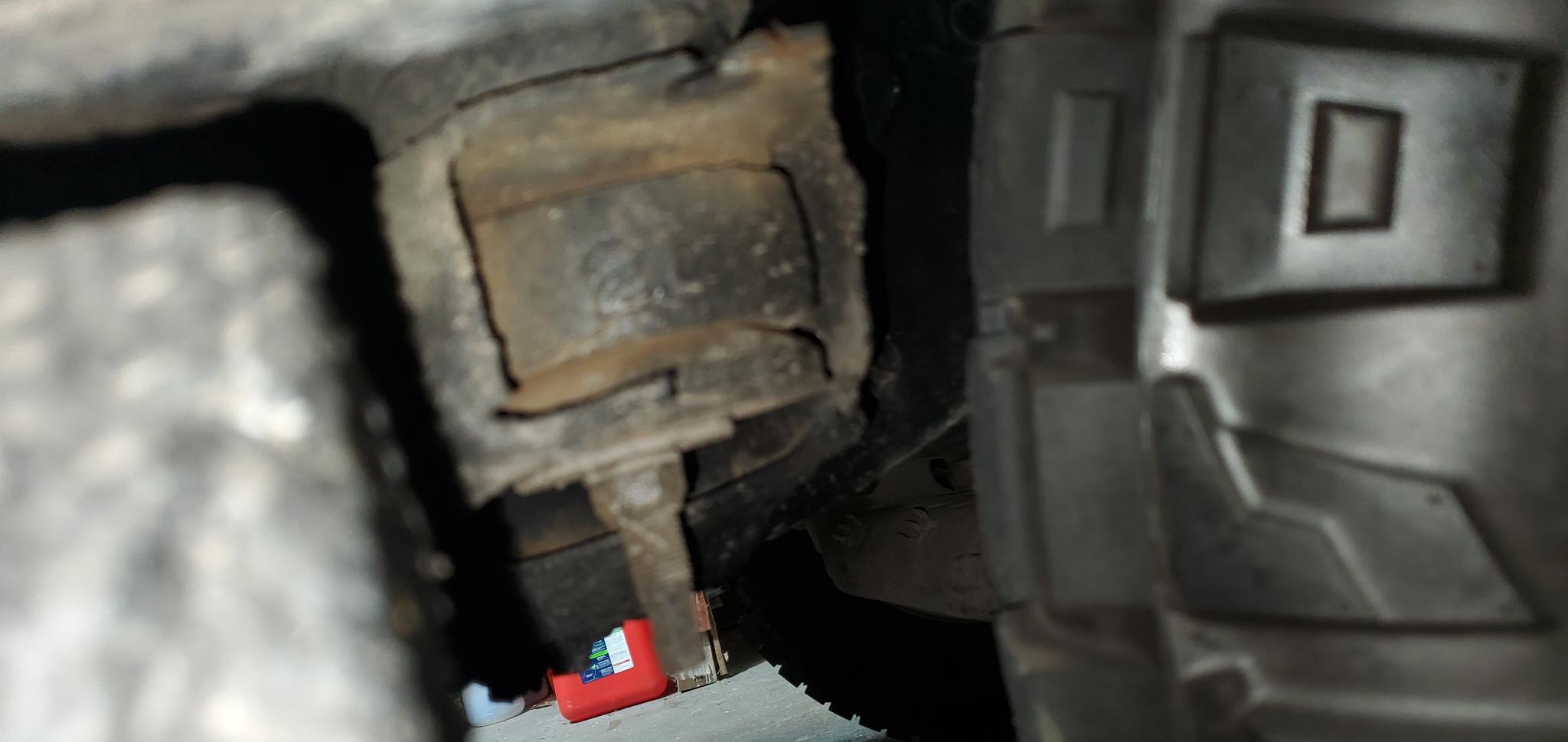

Trying to go from 285/75/17's ( 33.86 x 11.26) to 255/85/17 (34.6 x 9.8)
The only real clearance issue I can foresee dealing with after the trimming I've previously done is the Body mounts.
I currently run the JBA UCA's which have been great.
I do not currently have the Body mount Boxed, I'm sure I need to do that after all adjustments...
How far can I cut safely chop this to run these tires?.
I know body mount relocations are an option but that's not a road im ready to go down.
*The below pictures are full lock to each side on the steering wheel at the point where there least clearance is with the current setup.

I've seen a guy with a GX470 grind down quite a bit of his rubber body bushing to get his 37's to fit. And it still works great. :becky:
IMO you don't need to box them, but they will look a little nicer. Grind or cut as far as you have to, with my 37's I cut right up next to the bushing. Don't be shy, cutting up your tires while rubbing on that mount will cause more damage than cutting the mount a little extra.
That is encouraging! lol I guess it's time to be surgical with the Sawzall..

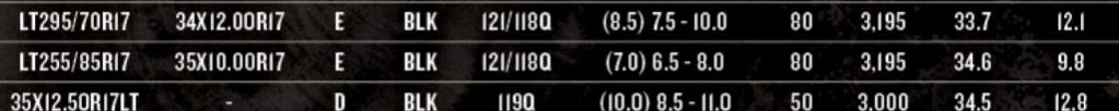

Im also considering 295/70/17.. which puts me back at 34.. but it may not look Too skinny.. Ive read some things about going to skinny is starting to mess with the stability of the truck.. I dont want that.. Decision decisions..
  • 2021-08-07 18_28_45-New Mickey Thompson Baja Boss A_T _ RoadTraveler.net.jpg
I saw what that guy said on FB, I wouldn't worry about that. That was the same guy that 5 min earlier posted a question that could have been easily googled, I'd venture he was talking out of his ass. Lots of people like running skinny tires, and the longer contact patch they have poses several benefits. One of them being rain performance (which was his complaint against skinny tires) can be improved because the higher contact pressure and narrower section width are more likely to cut through puddles rather than hydroplane. Of course this depends a lot on the tread design and how effectively it can clear water, but in general skinnier tires are less likely to hydroplane
I think the performance benefits of the taller skinny 255/85 vs a 295/70 are probably worth it.. but im so torn on this.. I wish mickey thompson would have just made a 285/75/17.. im so stuck on this tire.. lol
Its a toss up, and I don't think either will be bad. I was hesitant to go the skinny tire route, but I took the leap and we'll see how I like it
